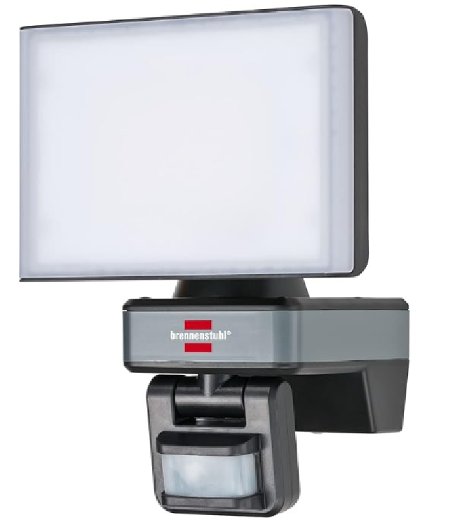

LED floodlight with motion sensor by brennenstuhl.
Here I will show you how I created and tested a PIR-controlled LED lamp (with light sensor) driver for OpenBeken - all without access to physical device. This topic will cover whole development process: from concept, through simulation, to automated testing. Whether you're learning how to contribute to OBK, or just exploring firmware inner workings, this tutorial shows how you can confidently write and verify a custom driver using only OBK simulator and self tests.

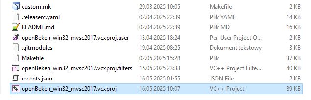

OpenBeken can be run directly on Windows platform with a virtual device simulator. All required dependencies are available for download in simulator repository. Just open the MSVC project (update it if you prefer newer MSVC):
Screenshot of Windows Explorer showing programming project files, including a Visual C++ project file and configuration files.

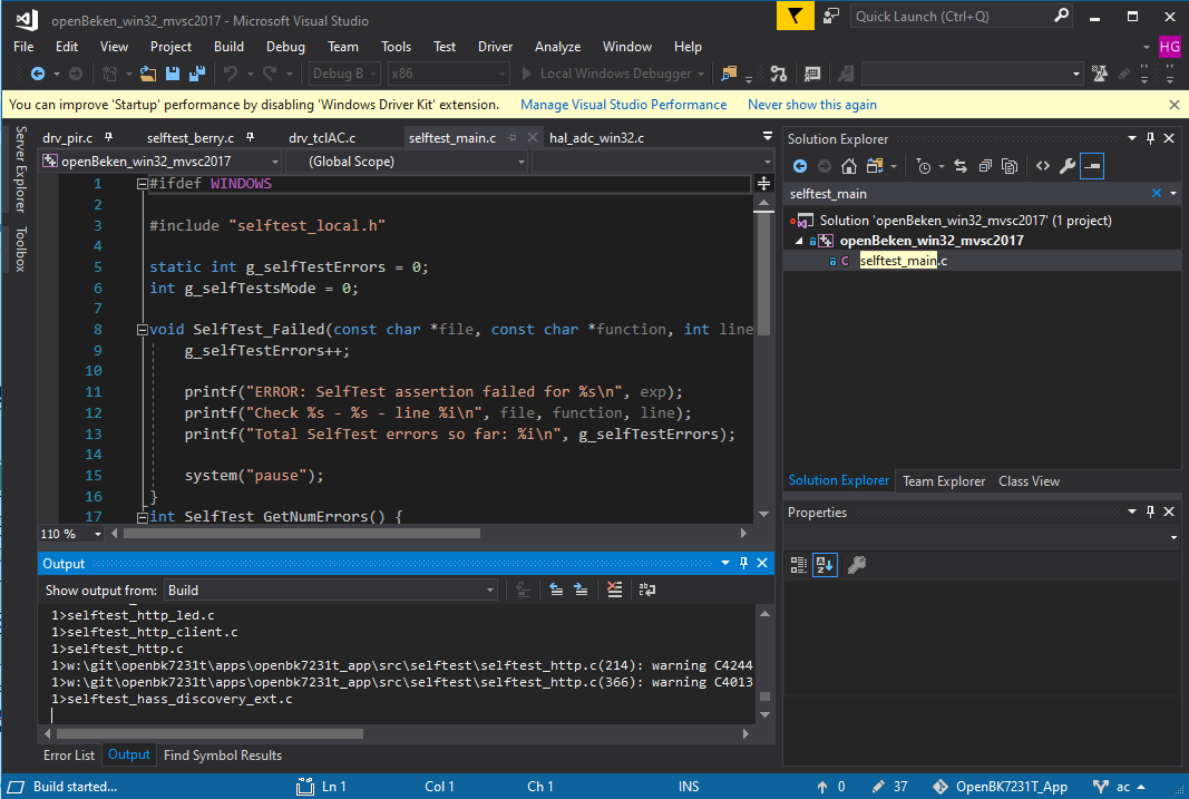

Then you should be able to both build and debug OBK Windows port:
Screenshot of Microsoft Visual Studio with a C project and source code editor open.

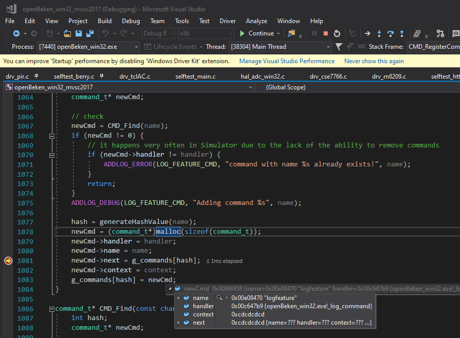

You can put a breakpoint in any function that is included in Windows port and you'll be able to investigate variable values, stack, etc. Of course, it does not include platform-specific code, but that's expected by design.
Screenshot of Visual Studio showing C code file open during debugging, related to command management.

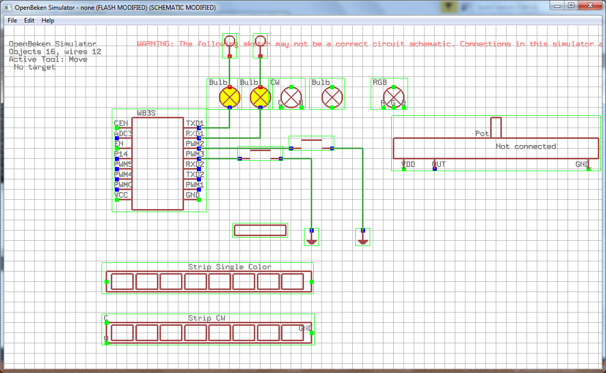

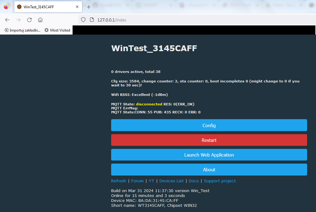

You can also access simulated device page and schematic tool:
Screenshot of the OpenBeken IoT simulator with layout of components.
OpenBeken IoT simulator homepage with device status information and configuration buttons.

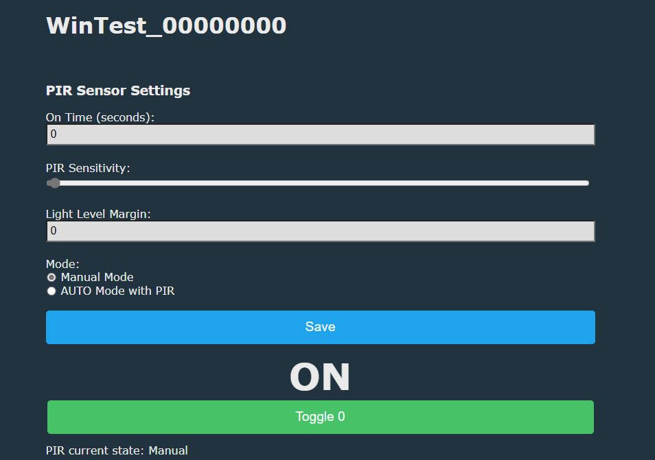

Then let's consider HTML page handler, which is used to create configuration UI and display current PIR state:
Code: C / C++
This callback is both creating the HTML page and receiving the data from submitted HTML form via http_getArg function. Parameters are later saved to flash vars, so they are persistent between reboots.

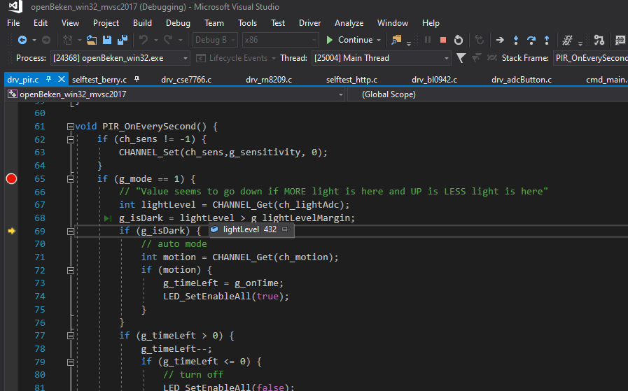

Finally, I've implemented the PIR logic, which is refreshed every second:
Code: C / C++
The logic above is fairly simple. In automatic mode, driver is first testing light level in the environment. Then the PIR is checked. If the environment is light and there is a motion, then light is enabled and timer is set to initial value. Then timer is ticked and if it runs out, the LED is disabled. That's enough for basic PIR functionality.
Step 4 - Testing driver configuration manually
This is a somewhat obvious step, but it's still worth to mention it. While developing a driver, it's very easy to test it directly on Windows. You just need to run the simulator and access the OBK page on your PC IP, by default using port 80. Port can be changed via command line, if you want to run multiple OBK devices at the same time.
That way I can get this:
PIR sensor settings panel with sliders and control buttons on a dark background.
I can put breakpoints in the driver code to see what happens:

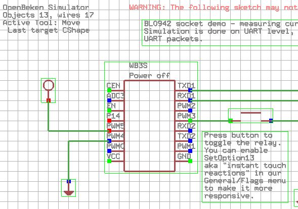

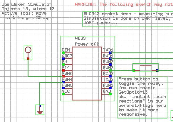

I can set states on simulated GPIOs by shorting them to ground or power (or by using a button):
Electronic circuit diagram in OpenBeken Simulator with a WB3S microprocessor and instructions on the right.
(of course, the schematic is simplified, you should not be attempting to create such circuit in reality).
This may be helpful for testing and playing around, especially since Simulator also supports Home Assistant, but there is still even better solution...

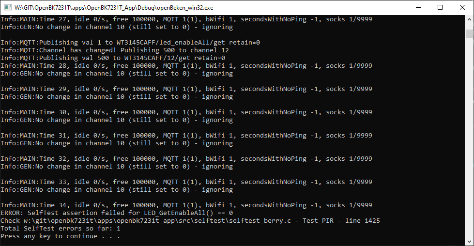

What would happen if there was an error in a driver?

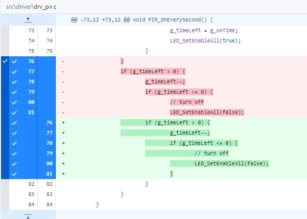

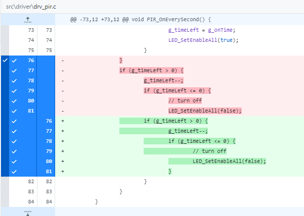

Now, for the sake of the presentation, let's break our driver logic. I've moved the countdown else inside the "isDark" block, so now time goes down only if there is no light:
Screenshot showing code differences in drv_pir.c; removed lines are marked in red, added lines in green.
This makes driver behaviour incorrect - the LED will not turn off if it's on when the day starts.
Now I run the self tests, and yes, they have detected the problem;
A console window running the OpenBeken program, displaying operation logs and debugging information.
The assertion fails and developer immediatelly knows that something bad happened to the driver. Don't forget the same tests are ran on Github, so even external commits (pull requests) are checked as well.
