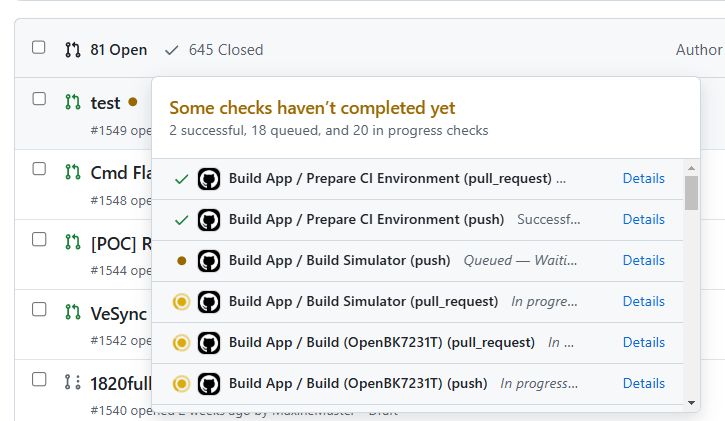

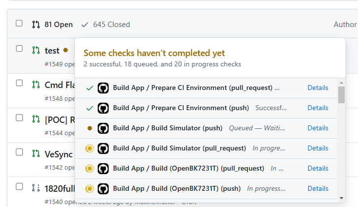

    Currently they are run on Github on each build:
    Screenshot showing results of a software build simulation.
    More precisely, OBK Simulator is built for Windows platform on each commit and then it's used to run the tests:

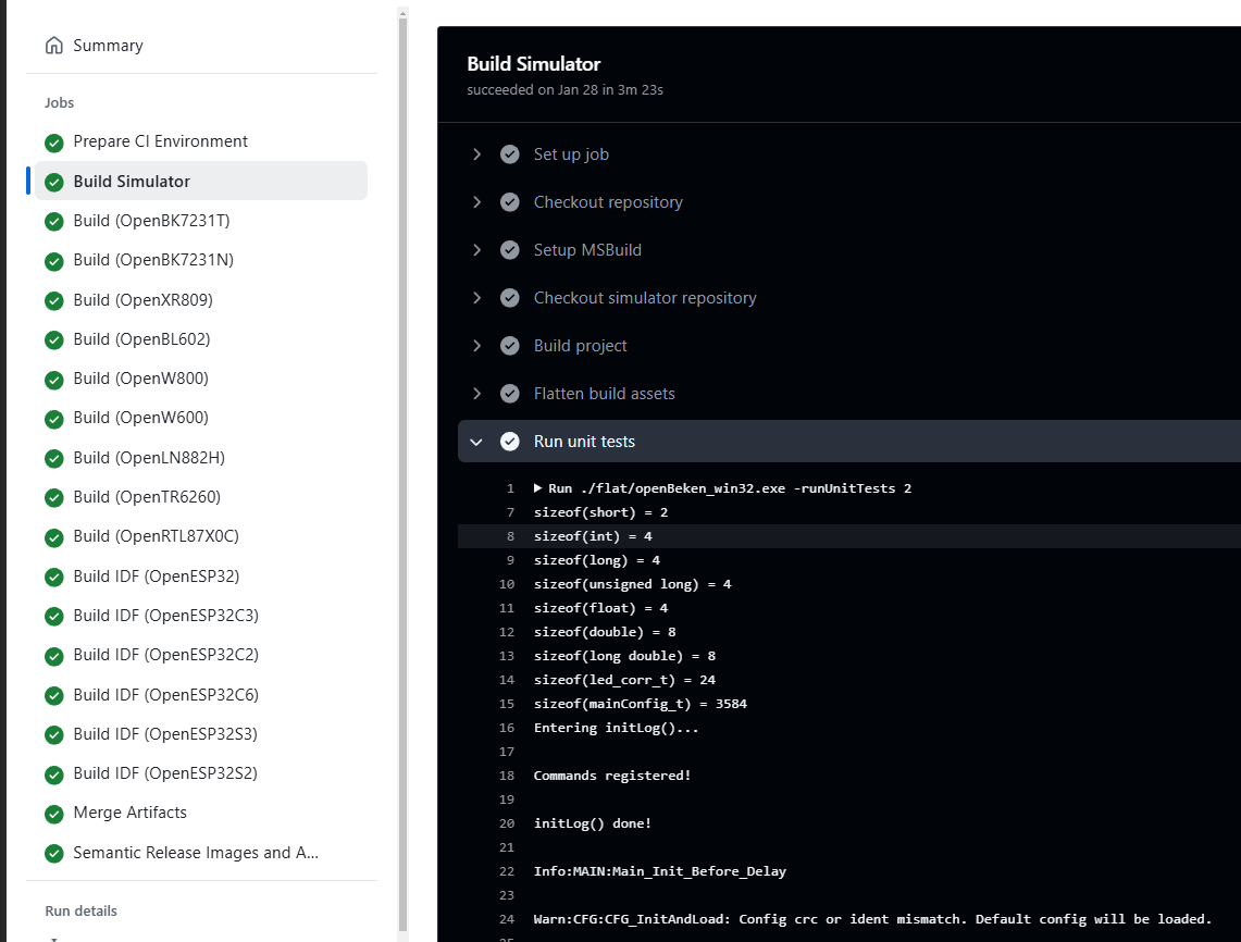

        - name: Run unit tests
          run: |
            ./flat/openBeken_win32.exe -runUnitTests 2

    To be more specific, the ./flat/openBeken_win32.exe -runUnitTests 2 line is responsible for starting them on Github machine. Then return value is checked to see whether all tests have succeded.
    Those self tests are basically simulating a use case scenario, for example, setting up a LED, and then they check externally is the use case result as expected.
    For instance, if we set two PWM pins, we expect CW control to show up and we expect Dimmer command to work. We expect certain things to be published when light state changes, we can test it as well. So, we simulate setting of two PWM pins, then we run some commands, and check if result is as expected (for example, are output PWM values as expected for correct CW control).

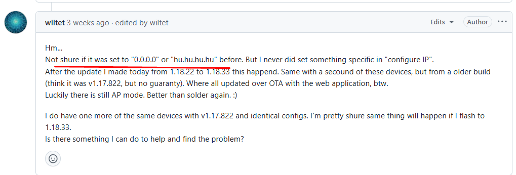

    This checks IP parsing, and this is required, because it has proven problematic, see implementation:
    Code: C / C++
    This is not just a theoretical sample - we really had this issue:
    Screenshot of a comment discussing software update issues.
    As you can see above, we had a sscanf problem that requires special handling on W600/LN882H/Realtek, and we didn't catch it early.
    If we had per-platform device tests back then that cover str to ip, we would have caught it earlier.
    It is impossible to catch this problem on WIndows self tests, because it is present only on some platforms with their specific implementation.
    Thanks to the per-platform tests, it's now possible to catch it.

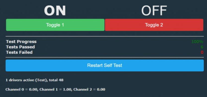

    If you compile OBK with test commands enabled, and if your platform has str_to_ip broken, then this code:
    Code: C / C++
    will attempt to parse "192.168.0.123", but it will fail, then "if" will detect it, so it will return CMD_RES_ERROR.
    So, later, the drv_test.c will catch it, and it will show error here:
    Test panel displaying switch states and test results.
    Self tests are very useful, because they can quickly check if all tested features can work as expected. You don't need to setup a CW light to check if PWMs are set correctly - this is done by Windows selftests in SImulator on each Github build. You also don't need now to manually check each page like local ip config on every platform, because per-platform tests will cover it as well....

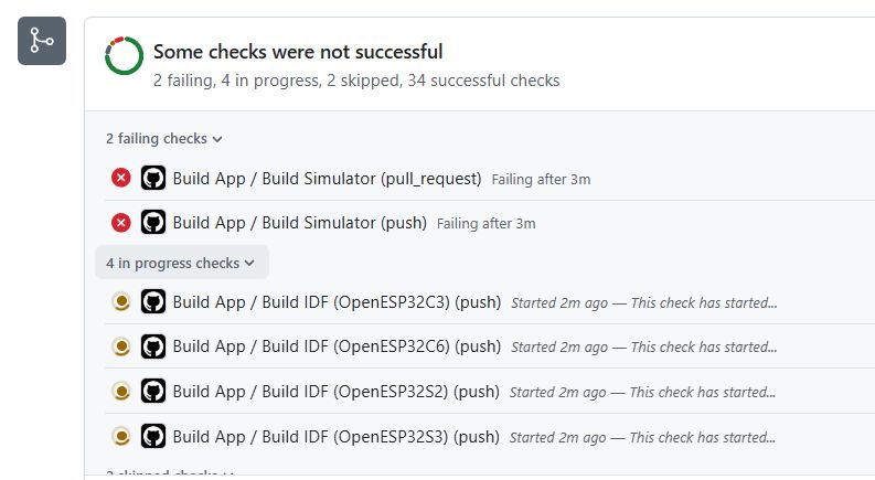

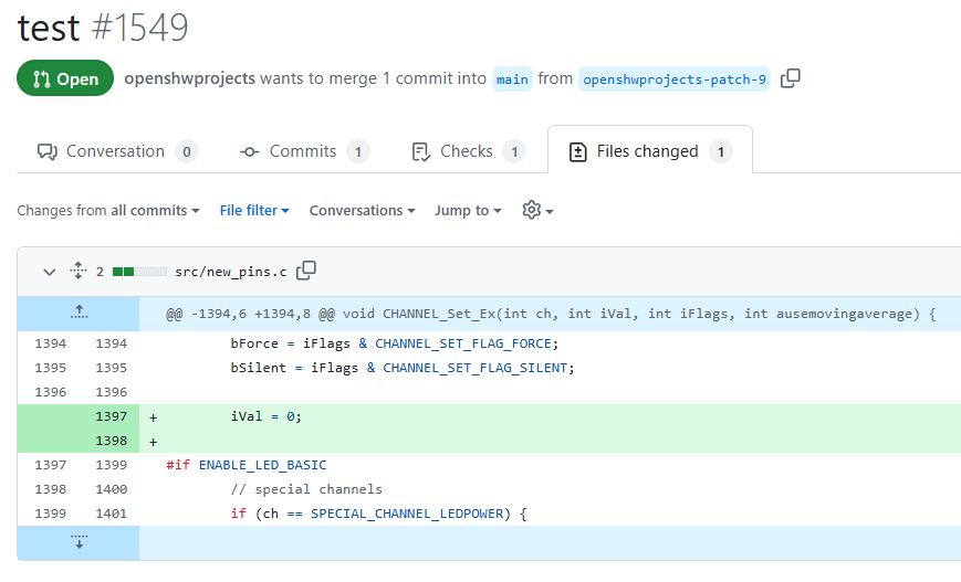

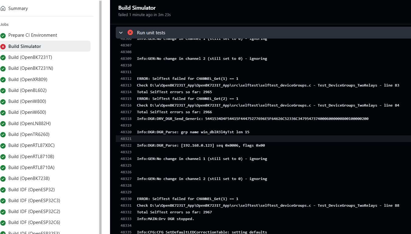

    So now let's make a demonstration. We'll consider a hypothetical scenario where someone breaks some function by accident, for example, the channel set.
    I modified CHANNEL_Set_Ex to always set value to 0:
    Screenshot shows a GitHub pull request for merging a branch in the openshwprojects project.
    Then I commited changes to Github.
    Let's see what happens.
    It's building, so we wait a moment...
    Task list in progress on a version control platform with status information.
    And then we get:
    Dashboard showing the status of task checks in a build system.
    As you can see, many self tests have failed. They expect channels to work, so they recognized that something is wrong:
    Computer screen from a CI/CD panel showing various build and test job statuses, with one error.

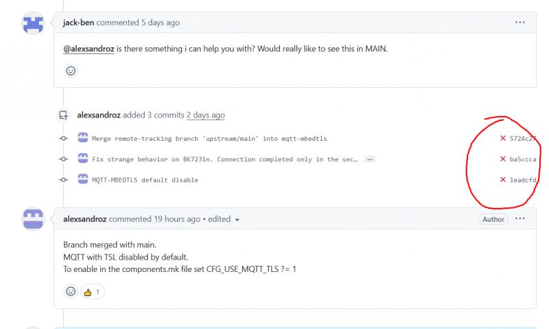

  • Automated tests caught WiFi flag bug
    #2 21467583
    Posts: 14782
    Rate: 12920

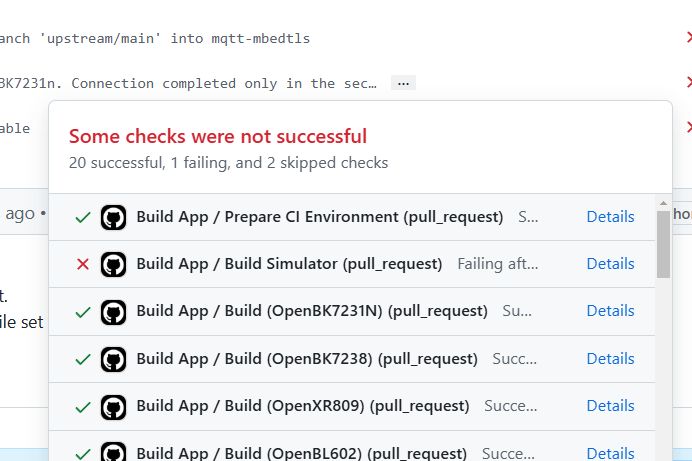

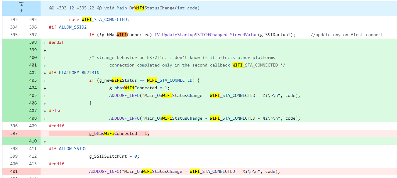

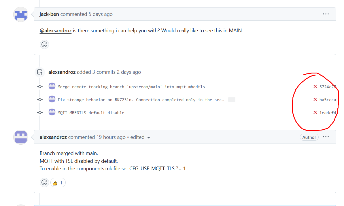

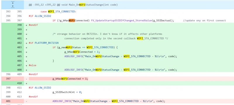

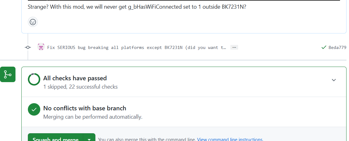

    But beautiful testing caught a new bug in Pull Requests.... someone added TLS support for MQTT for us, but accidentally included code like this:
    Code fragment in a Pull Request indicating a fix in WiFi connection handling, with differences in the implementation for the BK7231N platform. .

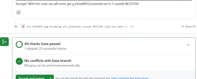

    I guess he forgot to set g_bHasWiFiConnected on platforms other than BK7231N though, to the effect all other platforms after accepting this change would think they have no WiFi connection.
    Automatic testing has detected this however! .
    Screenshot of a code management discussion about issues with TLS implementation in MQTT. .
    Screenshot of continuous integration test results showing errors in a Pull Request. .
    Neither the author, myself nor anyone reading saw the error, but nevertheless the tests caught it and allowed me to correct it.
    Screenshot of a Pull Request interface on a version control platform showing all checks passed with no conflicts.

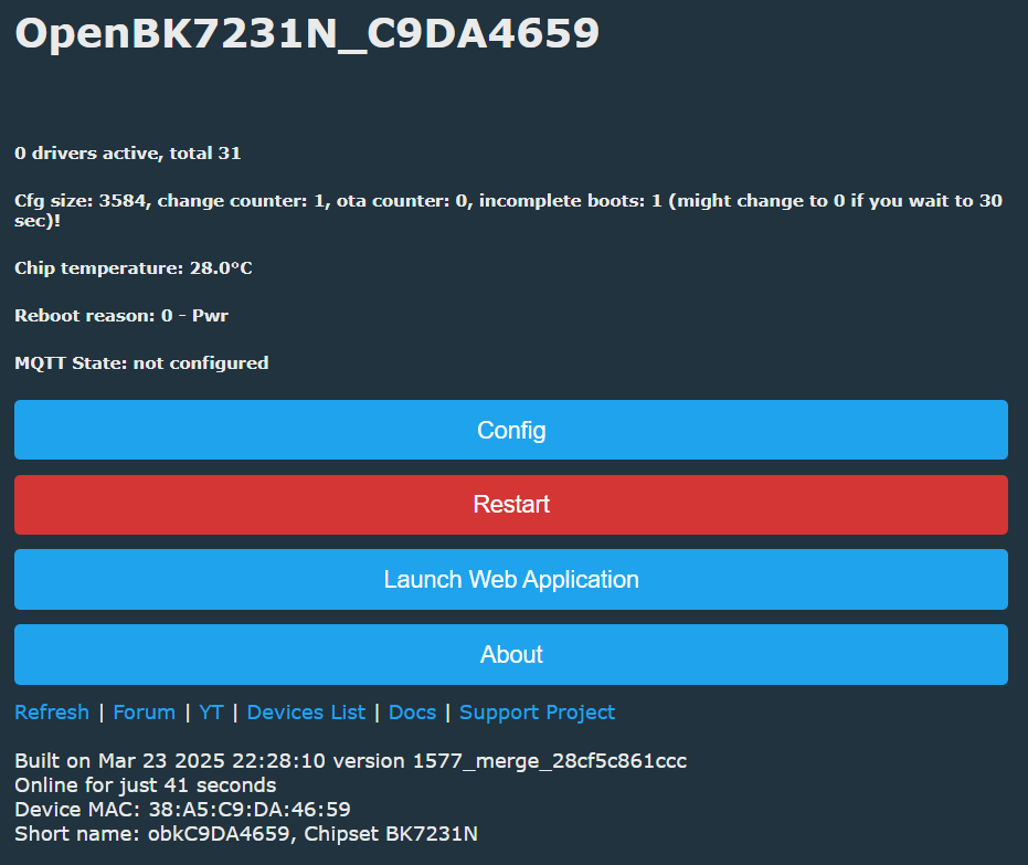

    I'm porting OBK self tests to Linux for @niterian . @divadiow can you check those binaries here, are they still working?
    https://github.com/openshwprojects/OpenBK7231T_App/pull/1577
    I'm just asking to make sure that I haven't broken anything on Beken, etc, or other platforms by accident
  • #4 21492839
    Posts: 5223
    Help: 449
    Rate: 918
    well, it boots...
    Screenshot of the OpenBK7231N user interface with configuration options and device information.

What happened in the MQTT TLS pull request bug that broke WiFi connection state on non-BK7231N platforms, and how did automatic testing catch it?
A pull request added MQTT TLS support but appears to have updated g_bHasWiFiConnected only for BK7231N. That meant other platforms could behave as if WiFi was disconnected after the change. The author wrote, "Automatic testing has detected this," because the regression appeared in tests even though reviewers did not notice it during code reading. The failure let the bug get fixed before wider damage. [#21467583]
