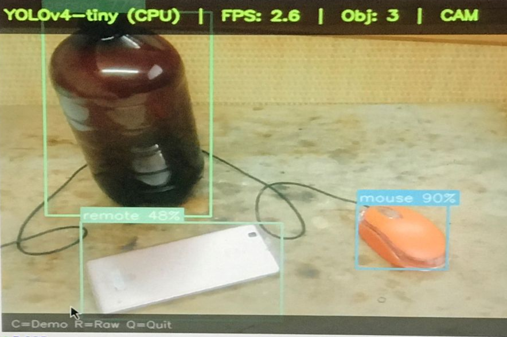

For convenience, I’ve chosen the smallest model – YOLOV4-tiny, running exclusively on the CPU (without any additional acceleration). Unfortunately, the FPS hovers around 2.5 frames per second, as can be seen in the on-screen statistics.
The first three screenshots show that the algorithm has considerable difficulty recognising objects. A smartphone lying on the desk was identified once as a “remote” (36%), whilst a computer mouse was mistaken twice for a “sports ball” (51% and 66%). It was only in the last screenshot that the mouse was correctly classified as a “mouse”, albeit with a fairly low confidence level of just 49 per cent.
A moment later, we see another challenge. The scissors lying on the table were initially identified quite accurately (“scissors” 40%), but when I added a white spray bottle, it was recognised as a remote control (“remote” 54%). In the final frame, the small brush was ultimately classified as a “toothbrush”, albeit with a confidence level of just 29%.
Further tests finally yielded some success, but also brought new comical mistakes. The model correctly recognised a white cup (“cup” 97%) and a glass standing next to it (“cup” 77%). Unfortunately, when a marker appeared on the scene instead of the glass, YOLO mistook it for a baseball bat (30%), and in the next shot, it failed to recognise it at all. In each of these situations, however, the cup was consistently identified with 97% accuracy.
