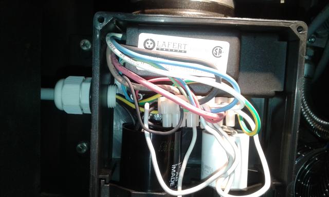

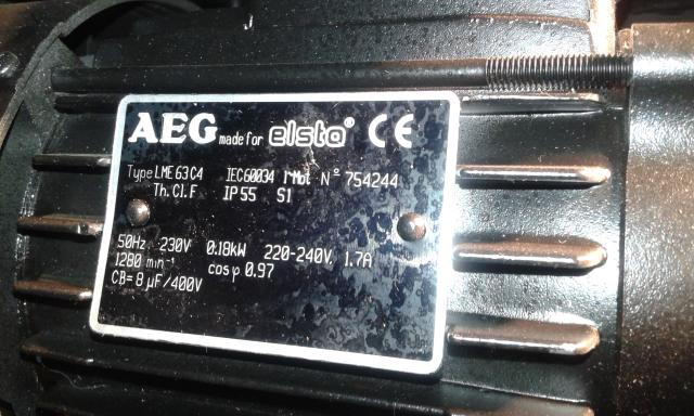

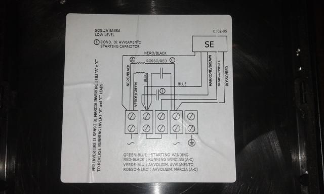

If it is a squirrel-cage single-phase induction motor, you need a frequency converter/inverter; a drill-type voltage controller or triac regulator is not suitable for changing its speed [#5243380] [#7151504] The forum notes that for this kind of motor you must change frequency and voltage together, which is what the inverter does, and a single-phase-supply frequency converter for single-phase motors was specifically suggested [#5243380] [#6518712] If the motor were actually a commutator motor, a U2008B/triac-style controller could be used, but that does not apply here [#5242650] [#5243390] If you do not want an inverter, the remaining options mentioned were mechanical ones such as changing belt ratios/gear reduction [#5251236]

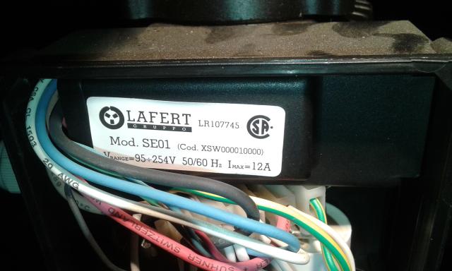

    Maybe these photos will help? In your opinion, can the Invertek 1-phase inverter be connected to this motor somehow? How can I do that? Should it only be connected to the working winding? The starting winding is only used to start the motor, and when the motor is up to speed, will this winding be turned off and the working winding will start working?
