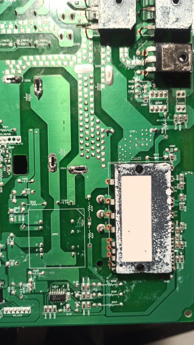

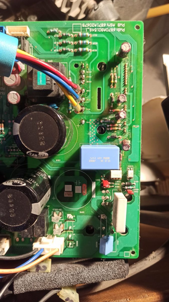

    Some time ago I came across this very interesting thread. My friend bought an external unit of an LG air conditioner with approximately 7kW of heating power, for which there is no internal unit and there is no way to turn it on (it is only supposed to "give" heat). Inside there is an FSAM20SM60A ONSEMI and the IGBT is controlled by a TLP251 optocoupler, probably the same CPU, but I haven't thought about it thoroughly yet. I have a question: if I added MC332623 and DSP (dsPIC33F), would there be a chance to control this compressor? I apologize for not preparing for the topic due to the late hour, but I did not analyze the differences between FSAM20SM60A and FNA41560

    In my opinion, the main difference is the signal controlling the IGBT module. In the case of the FSAM20SM60A system, the low level turns on the IGBT transistor located in the module. In the case of the FNA41560 system, a high level at the microcontroller output turns on the transistor in the IGBT module.
    To use the system from the description, you need to negate the signals coming from the micro controller and then connect them to the inputs of the FSAM20SM60A module.
    The levels can also be negated in the program when configuring the PWM module of the micro controller. I understand that the intention of the question is to obtain information whether it is possible to use the micro controller from the article to control the IGBT module that is located on the board in the photo.
    As for the PFC module from the article, it is only up to about 400 W and it is difficult for me to say how much power the system in the photo needs to produce 7 kW of heat.

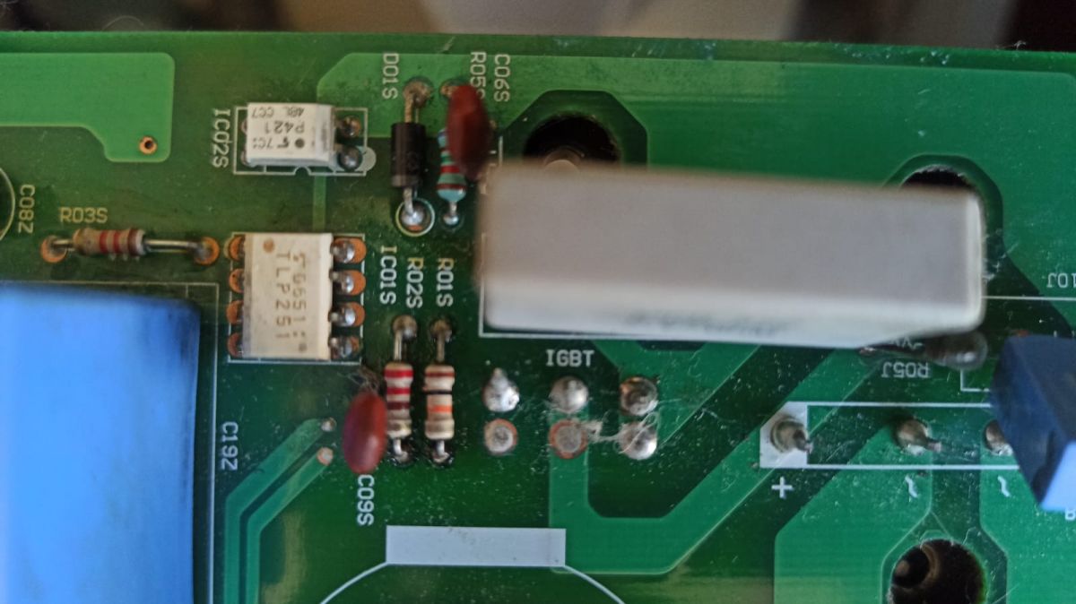

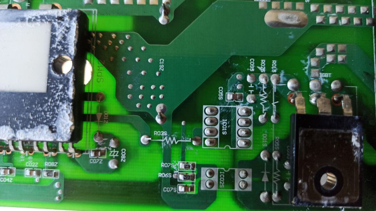

    So I want to replace the microcontroller that controls the FSAM20SM60A and the IGBT which is actually controlled by optocouplers, from what I see there are 2 different ones, I will take care of the rest with ESP, i.e. controlling the fan and gas switch. The compressor is 5CS130XCC03 R410 MATSUSHITA, i.e. 5.2kW of cooling power, a bit more heating power, but realistically it will be 2kW, something here: https://www.elektroda.pl/rtvforum/posting.php?mode=quote&p=10239503 they write about it but I can't find any specific pdf. Thanks for the information, I'm away from home today, I'll have to take a closer look at it. However, my knowledge about inverters is minimal, so I will be grateful for any information/suggestions.
