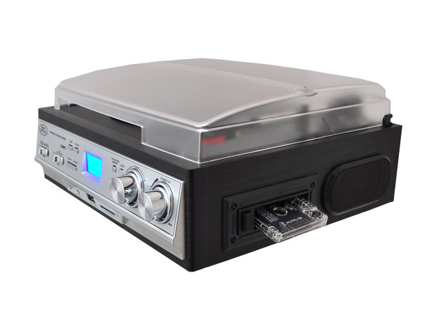

    You can do it with such a device. First you have to record songs from your computer to a blank CD and then record them onto a cassette. I would like to emphasize that it is mediated by recording to a CD and each processing of the material is against the quality (noticeable to me), so it is best to record onto tape from the most originally available source. For example, it can be music from the radio or material from TV. It is known that mp3s are not the primary source.
    Personally, I have not come across a CD radio with RCA inputs, i.e. chinch (female inputs). Even if it is the quality of the recorded material on the cassette, it will be average. Hi-Fi towers are the best at this.

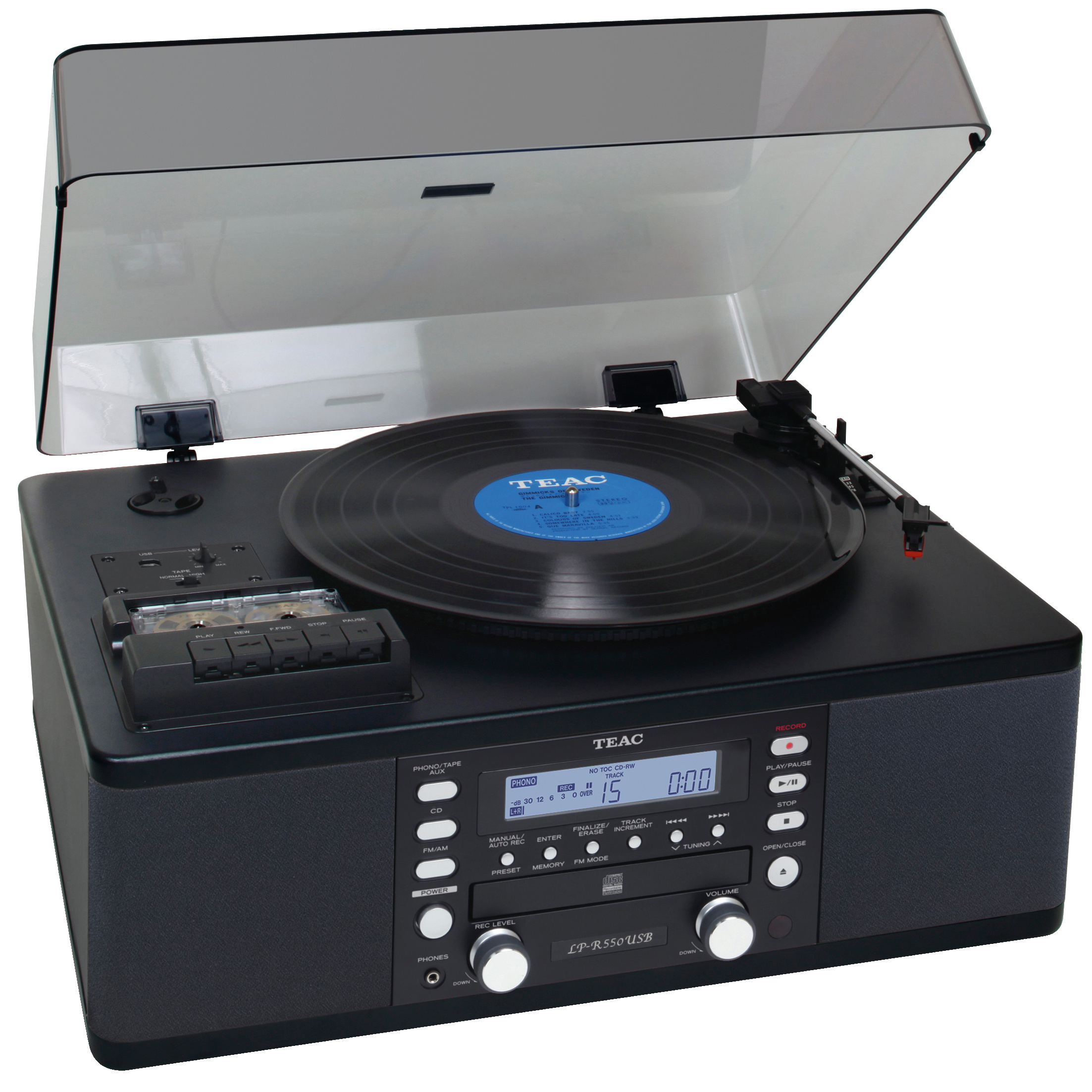

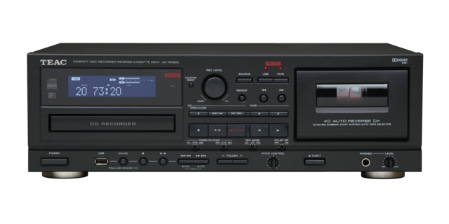

    For professional computer recording onto cassettes and even without a digital computer, TEAC produces new cassette decks.
    It is a combined equipment that allows you to play and record to cassettes, CD and USB - all in one module.
    Technics RS M 235 X: Recording Audio from Computer to Cassette Tape
    TEAC AD RW 900 ideal for concert halls, bands.
    Each performer can give their foundations on the medium they like :D .
