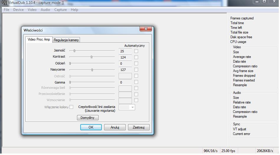

    3) where to look exactly in which tab? (dropped in the attachment)
    • Transferring VHS Tapes to Computer: Euro Cable, Grabber Connections, & Pairing Guide Bez tytułu.jpg (88.56 KB) You must be logged in to download this attachment.
  • VirtualDub capture filter VCR input location

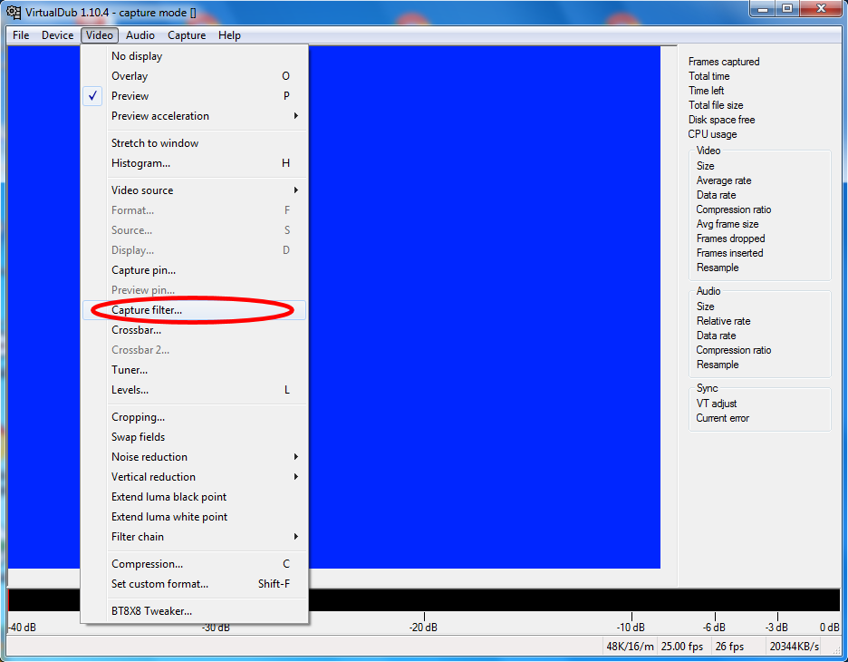

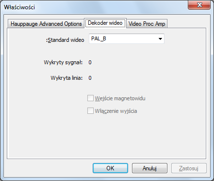

    I do not know the programs you use. In VirtualDub:
    -> capture mode \ video \ Capture filter \ VCR input
    Transferring VHS Tapes to Computer: Euro Cable, Grabber Connections, & Pairing Guide Transferring VHS Tapes to Computer: Euro Cable, Grabber Connections, & Pairing Guide
    In one of my cards, this control is inactive, because the card does well with the deformed signal, in the other it works but I do not use it anyway because the image goes through the TBC fullframe.
    Pzdr.

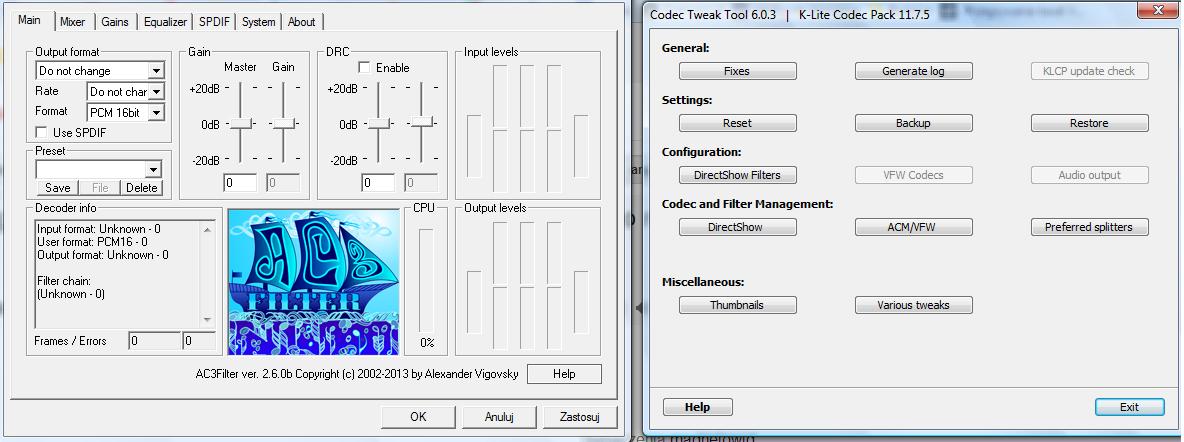

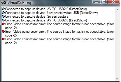

    After entering the Capture filter, there is no window like this but you can see it:
    and I have something like that, some errors:
    • Transferring VHS Tapes to Computer: Euro Cable, Grabber Connections, & Pairing Guide 1.jpg (24.75 KB) You must be logged in to download this attachment.
    • Transferring VHS Tapes to Computer: Euro Cable, Grabber Connections, & Pairing Guide Bez tytułu6.jpg (59.66 KB) You must be logged in to download this attachment.
  • #10 16620232

    It is difficult for me to advise something because looking at the settings of the dshow intercept filter you can see a tragedy here. Apart from procamp, there is nothing there, unless in the "camera adjustment" tab whatever it means ...
    Perhaps the drivers for this "technical marvel" do not offer the synchro time constant compensation, and then it will help only full frame TBC connected between VTR and grabber. Unfortunately, the cost of such a device is greater than 20 such USB grabbers put together ...
    My experience with similar devices was limited to one of the more expensive "pendrajwopodobnych" USB grabbers, i.e. Reflecta USB Video Grabber AV 2.0:
    https://www.morele.net/reflecta-usb-video-grabber-av-2-0-grabberav2-0-718827/
    This device had the option of switching on the "video recorder" mode, but it offered such a nasty quality of the captured image that I never used this device to make a commercial copy of the recording. For several years it lay like a "reserve" on the bookshelf, until finally some of the friends were mishappy with that ...
    I suggest looking for a decent framegrabber from the Pinnacle, Hauppauge or Blackmagic Design stables, because this photo from the first post may not surprise you again with various surprises :)
