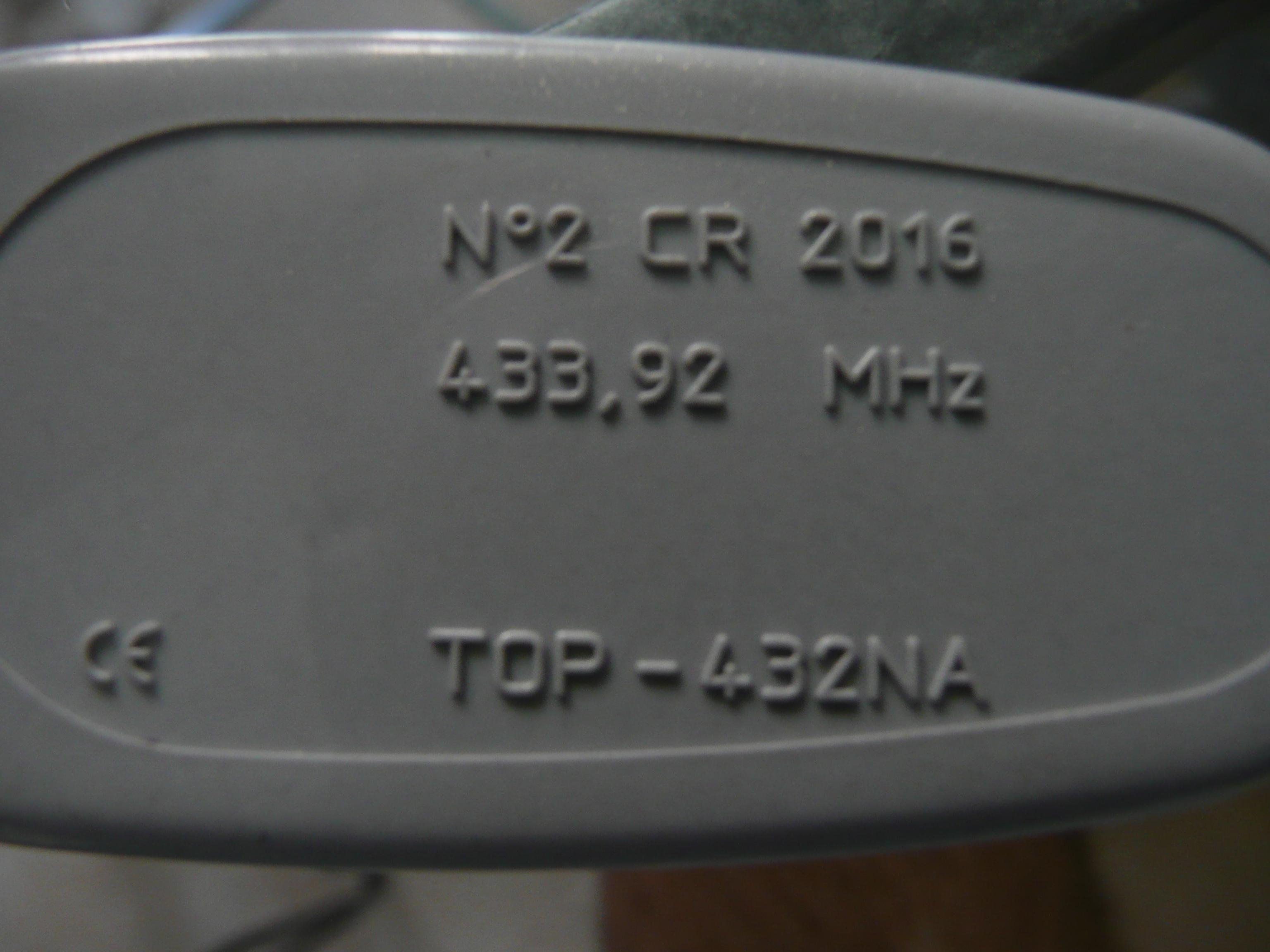

    Hello !!
    A friend asked me to write this post. He received only one gate remote control from the administrator, because he has only one parking space, and he would like to give his wife one remote control because they simply miss work during the week. Unfortunately, it is not possible to receive a second remote control from the administrator. Is there any way to copy this remote ?? I am posting external photos of the pilot (I will post internal photos if necessary). Regards and I am asking for help.

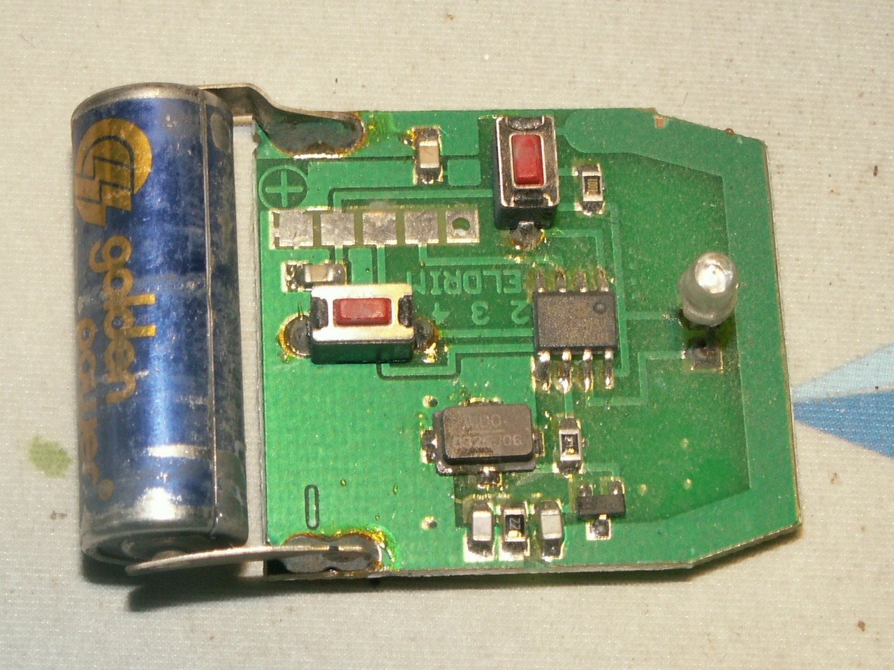

    Kurski if you can, open the remote control and show the center. Only then will it be known if you can enter the second one.
    The administrator enters all remote controls on the network into the database, so you probably won't be able to use the New Remote.

    These remotes are programmed as long as it is probably the TOP 432N series. In my neighborhood, it costs about PLN 80. They are not programmed with DIP-switches. Only by radio. You will need a second operable pilot for literally three seconds. There is a slinger inside and something al'a a super-reactive receiver. I have about 120 such pilots in my company and I programmed the rest except for the two factory ones (each employee has their own pilot). Check exactly what model it is.
    greetings
    Arturavs
    PS. I looked at the picture. This one is being programmed.
    The code is permanent.
    PS2. SP5ANJ => administrator does not enter anything in the database. I made a few such "goals", I know. You can easily buy a new one
    and program it. For me, if someone loses it, I buy it myself and I program. The number can be any, even on the packaging there is an instruction
    programming.

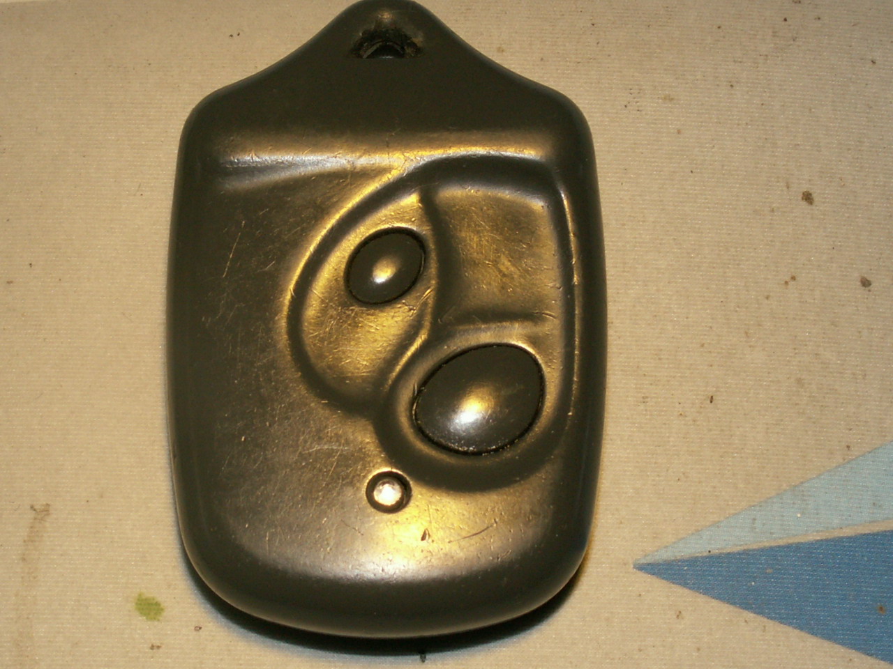

    I read that the topic is there and I have a problem with the gate remote control.
    A friend asked me to "make some extra money", but the problem is that nothing is written on the radio device at the gate, or on the remote control of which company the control was used.
    Maybe someone could help with the identification.
    The remote looks like this:
    Duplicate Gate Remote Control: Obtain Additional Remote for Parking Space Sharing
