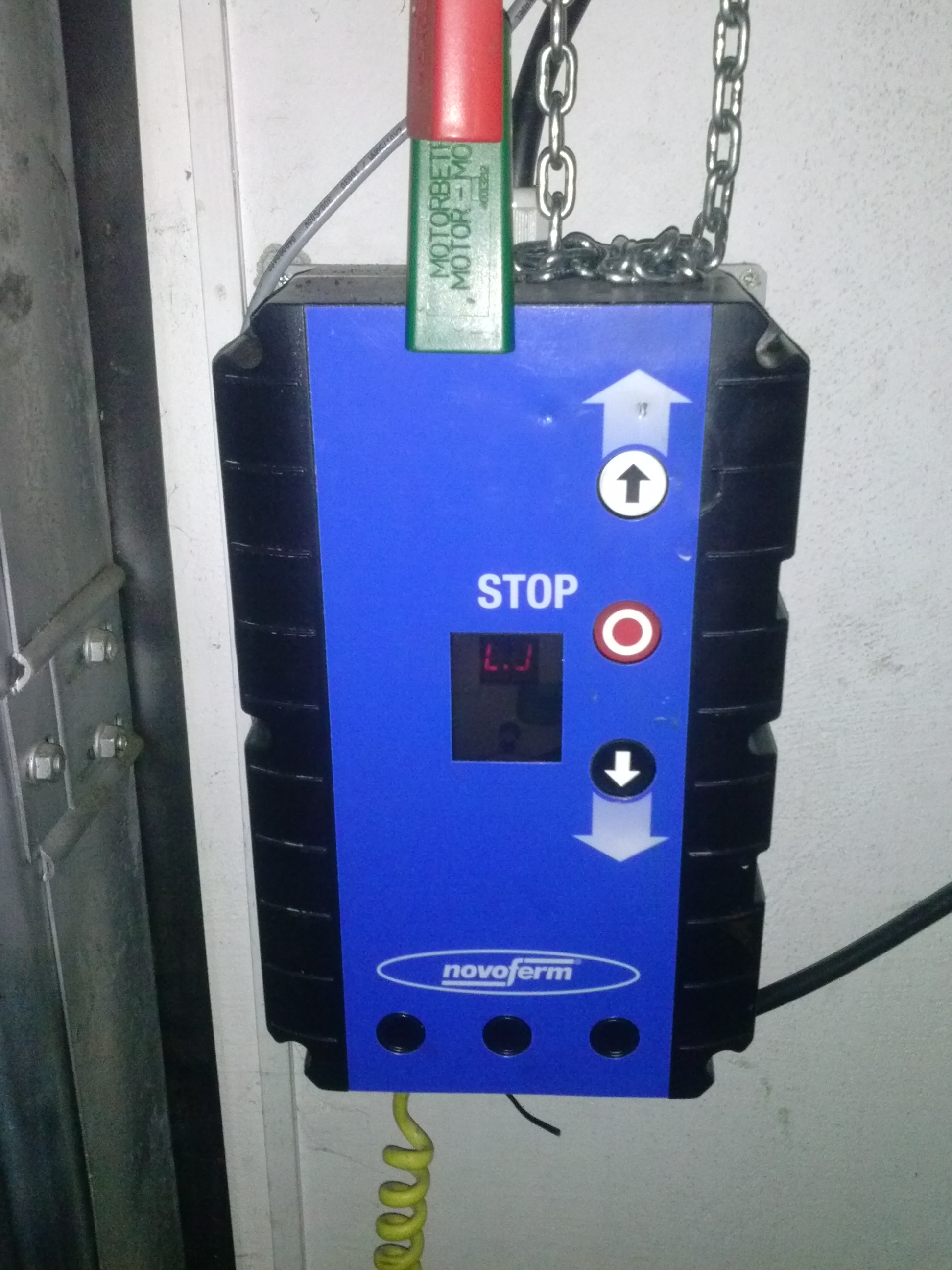

    Good day.
    I have a DTM NEO remote control for the garage and such a switchboard and an entrance gate to the Came estate.
    Copying NEO Remote Control for CAME Gate Without Access to Driver Possible? Copying NEO Remote Control for CAME Gate Without Access to Driver Possible?
    I have a question whether by buying the same remote control I can copy it myself only to the garage door or maybe a duplicating remote control from Allegro for PLN 20 will work.

    Try to hold the button (the tan that controls the device you are next to) within the radio range for 15 seconds, release the button and within 2 seconds press the button on the new remote control for 15 seconds.

    And if using this procedure I will not delete my mother's remote control and the remote will work on the same code as mine. Recently I noticed that the maintenance technician of our building was holding two remotes in his hands as if he was copying one and the switchboard was closed, I think it is not secured. the Allegro duplicator can work?

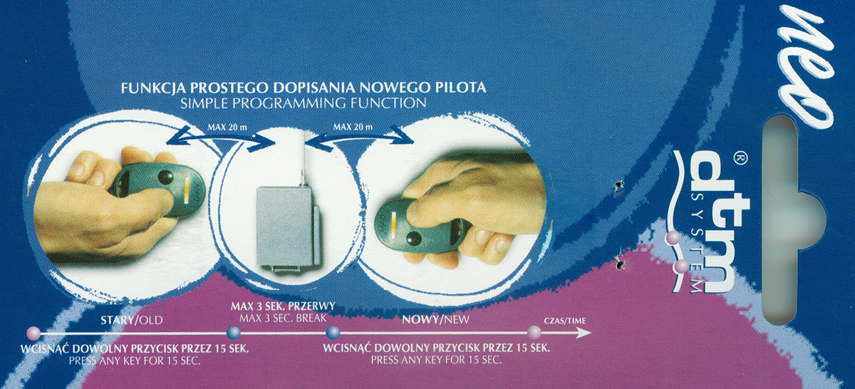

    The Neo remote is a rolling code remote and it is not possible to duplicate it with a duplicate remote. To be precise, the best copying remotes are able to remember the NEO remote's emission, but such a remote will open the gate only once, then the code that has been remembered and sent will no longer be valid.
    The procedure for remotely registering the NEO remote control to the DTM receiver is described in the remote control manual.
    Remote registration in the receiver, however, cannot be blocked, and it probably is because administrators and installers have to make a living.
    It is not just about "maintenance", but about controlling access to the facility. DTM multi radios allow for precise control over the remote controls, everyone gets their number in the system and it is known (the administrator) who has it. I do not really imagine the sense of automation in the estate or garage where anyone can copy the remote control.
