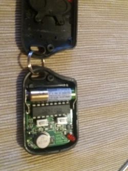

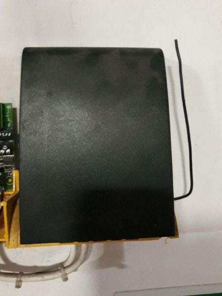

    Programming Gate Remote Control: Identify Brand & Model + Fixed/Variable Code System Programming Gate Remote Control: Identify Brand & Model + Fixed/Variable Code System Programming Gate Remote Control: Identify Brand & Model + Fixed/Variable Code System Programming Gate Remote Control: Identify Brand & Model + Fixed/Variable Code System

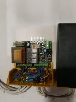

    I have a garage with an automatic gate central control unit and a remote control attached. The remote does not work. I don't know what company is the central and remote control. please tell me how to program it or which one to buy. whether from my photos is anyone able to prompt if it is a fixed system or code variable
    Thank you in advance for your help

    At the beginning you need to know what equipment it is. Look carefully at your plate and there should be something - name, model or something (you did poor photos and you can't see anything on them)

    Fixed code set with 10 position dip-switch.
    In the remote control after spinning should also be such a dip switch.
    The same setting in the receiver and transmitter causes that the remote control should work.
    It may be that the codes in the remote control are set by a combination of button presses, or the remote control is not original and the code from the original remote control was loaded into it.

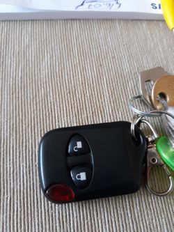

    On the plate, no description at the front, back, nothing.
    Do you think this is a fixed code system?
    I have the option to borrow a functional pilot from a neighbor and I have a self-learning pilot that I can copy.

    platnerz11 wrote:
    more than once I programmed the remote to nice, elmes always had a prg button on the control panel
    - these are radio links with a variable code. (Admittedly, even on some receivers with a fixed code there are programming buttons.)
    This one is a permanent code ... Unfortunately, the photo of the pilot is inaccurate and incomplete (no other page).
    In some old models there was no dip-switch (s) but just soldered the appropriate on-off fields ...
    Can a neighbor's pilot be cloned? You have to try. In addition to the code, the frequency is also important ...
    https://www.elektroda.pl/rtvforum/topic3373991.html

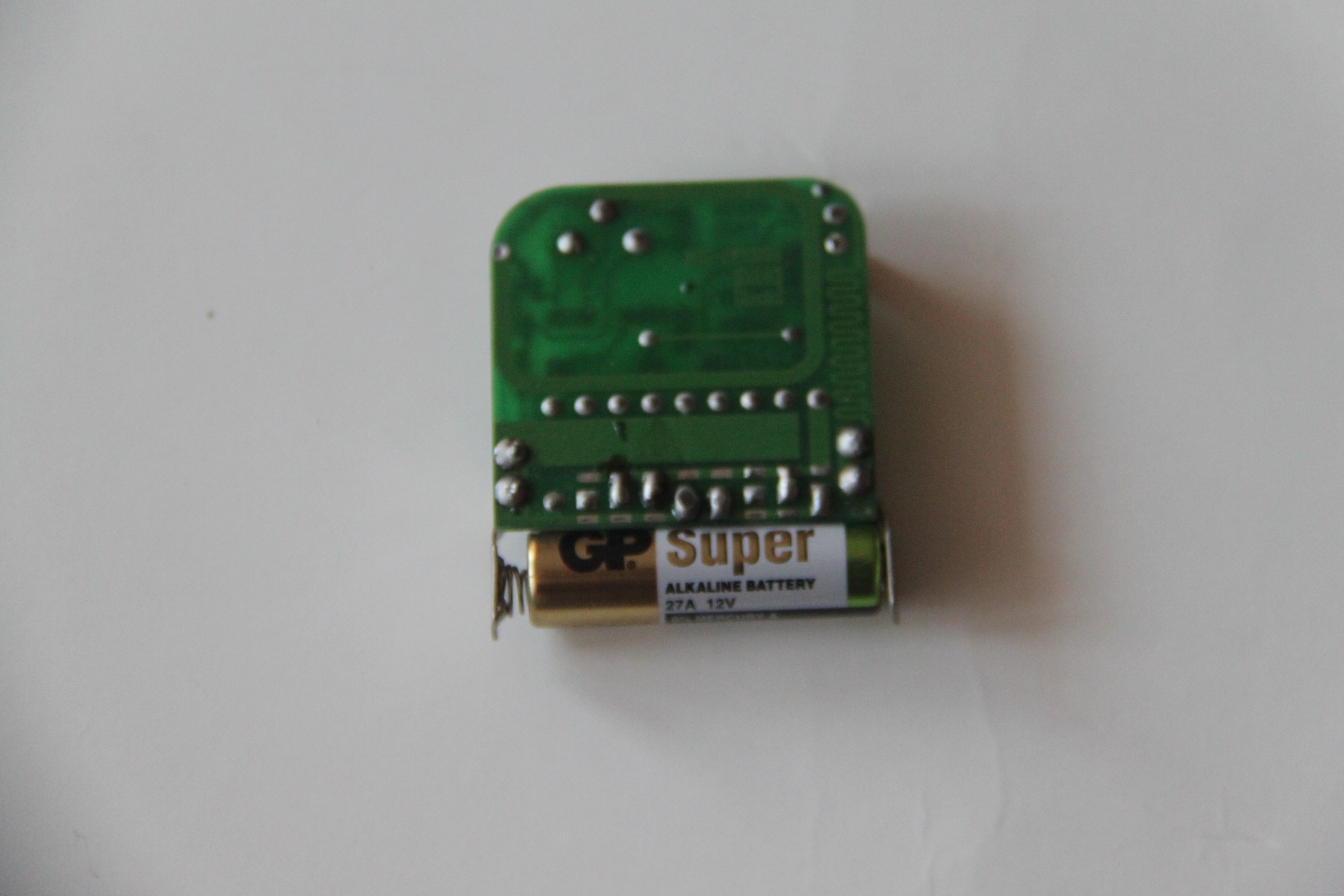

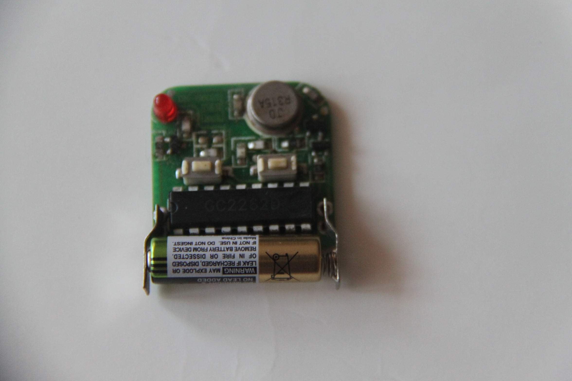

    Adds detailed pics of the remote control from both sides
    If I get a remote control from a neighbor and try to clone it, I'll let you know if I've solved the problem
    Regards

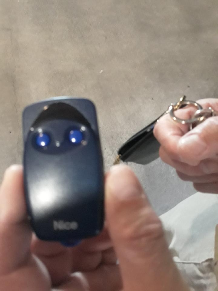

    two neighbors in the garage have nice flor-s remotes from what I read are variable codes and there is a procedure for programming them from the remote control a few meters from the transmitter
    Please tell me if I am right?
    I add a photo of the pilot working to the gate Programming Gate Remote Control: Identify Brand & Model + Fixed/Variable Code System
    a few meters from the receiver,
    This function must be active (enabled on the receiver).
    Your remote control is a 315MHz fixed-code remote control.
    Search for cloner at 315MHz.
    Regards

    Thank you for the instruction, but the nice flo2 remote control works at 433.92 MHz

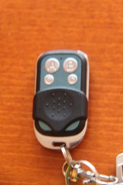

    I was able to copy the nice flo 2 navy pilot to the clone
    Thank you very much for all your help

    Problem solved with self-copying remote control.
