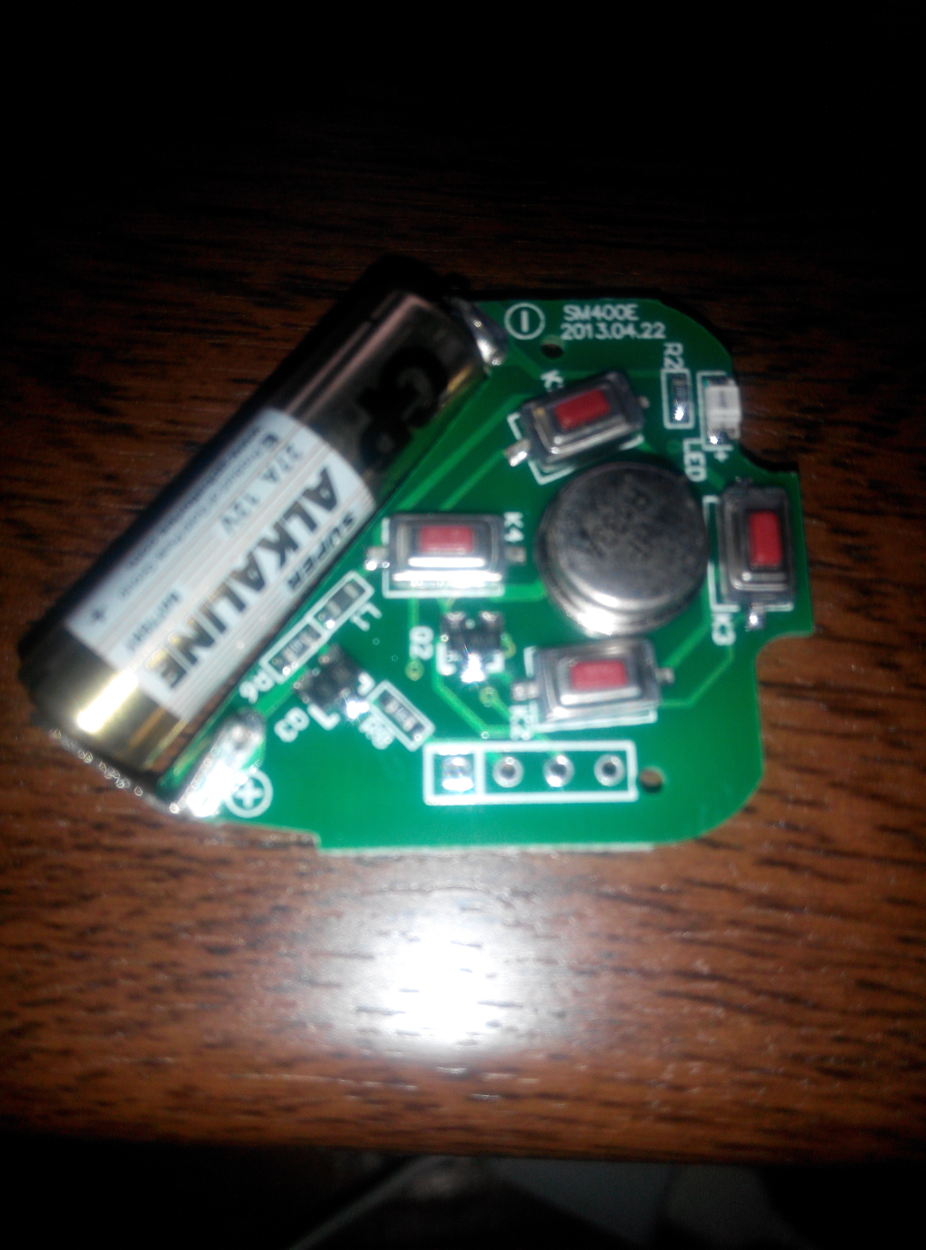

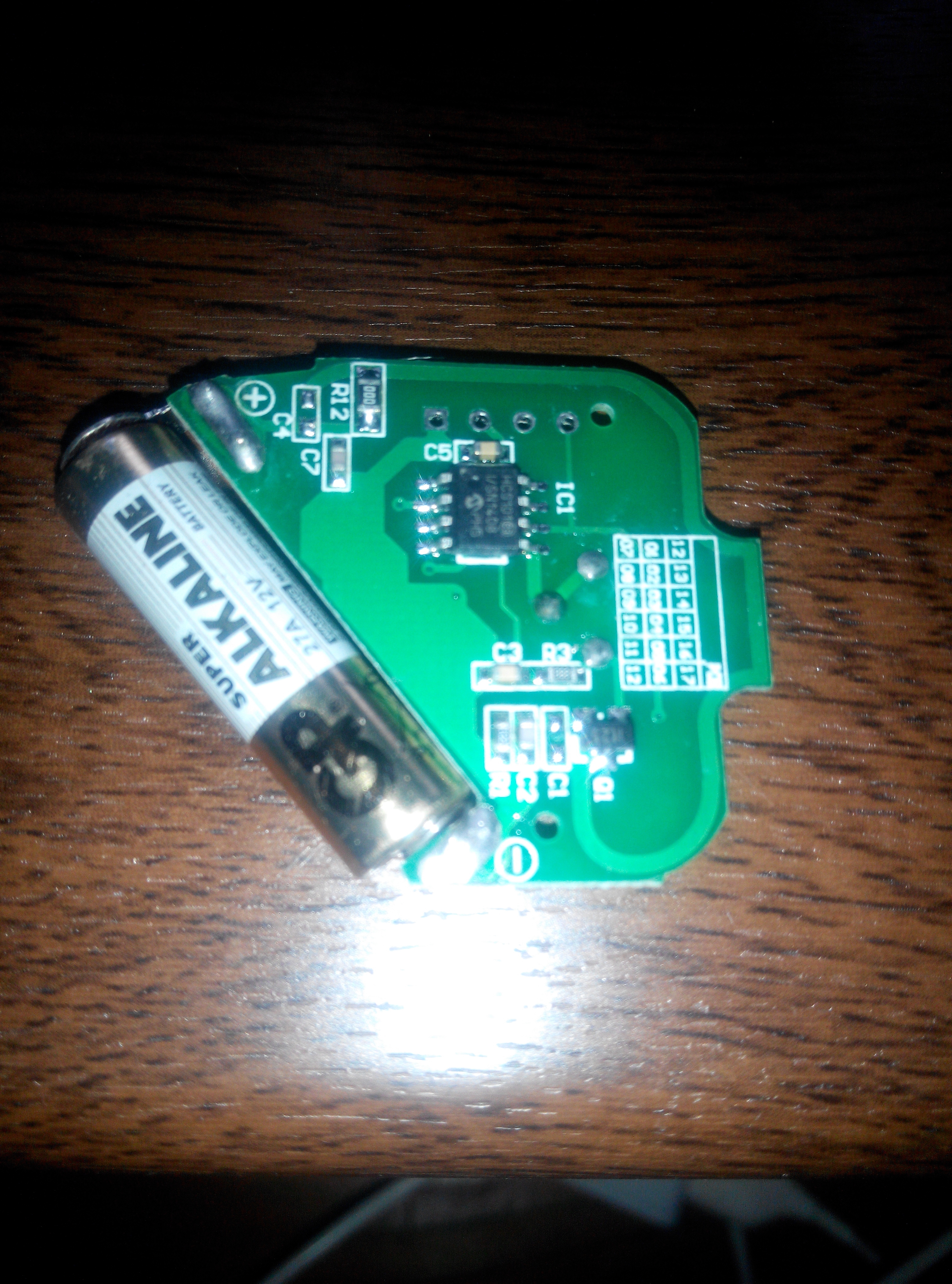

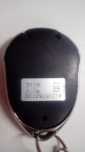

    I need a third remote control for the splendoor gate, unfortunately I have no idea what to buy.
    I add photos of the remote control and its tiles, maybe some of you will help.
    Buying Guide: Choosing the Right Splendoor Gate Remote Control Replacement Buying Guide: Choosing the Right Splendoor Gate Remote Control Replacement
    The pilot does not have to look identical but it would be nice if it happened.
    Maybe one of the universal pilots from the popular auction site will fit, but which one?
    Best regards and help please.

    The most reliable solution is to buy a "radio line" (provided there is an output for external control), the same looks for the Hato remote control housing, but the PCBs look different, the remote controls can be programmed differently and then you will do nothing. Sometimes you can be "lucky" that the receiver will only use a fixed code part, then you can use different remote controls for the same frequency and on the same (similar) system, if you have a remote control from something else, or borrow from someone, then you can try program.
    Is the system HCS301?
    This is the HCS101 system

    So this is a fixed code, you can try some self-copying remote control, although with these inventions it is different and I do not guarantee operation, HCS101 is not very common and there may be a problem with the purchase (at least I do not know the remote controls on this).
    Do you want to add another remote control, is this one out of order?
  • #5 16708265
    Balon14
    Posts: 44
    Rate: 12
    Another remote control I intend to add, I have already bought a remote control with a permanent code and copied the remote control but it does not work with the gate.

    Then:
    Since the factory remote controls are still on a fixed code, you can buy an invention for PLN 60 with two remote controls and a shipment, possibly a product from AMT - they say there is a changeable code.
    PS It is worth considering the installation slightly distant from the radio path of the original receiver to avoid deterioration of the range.

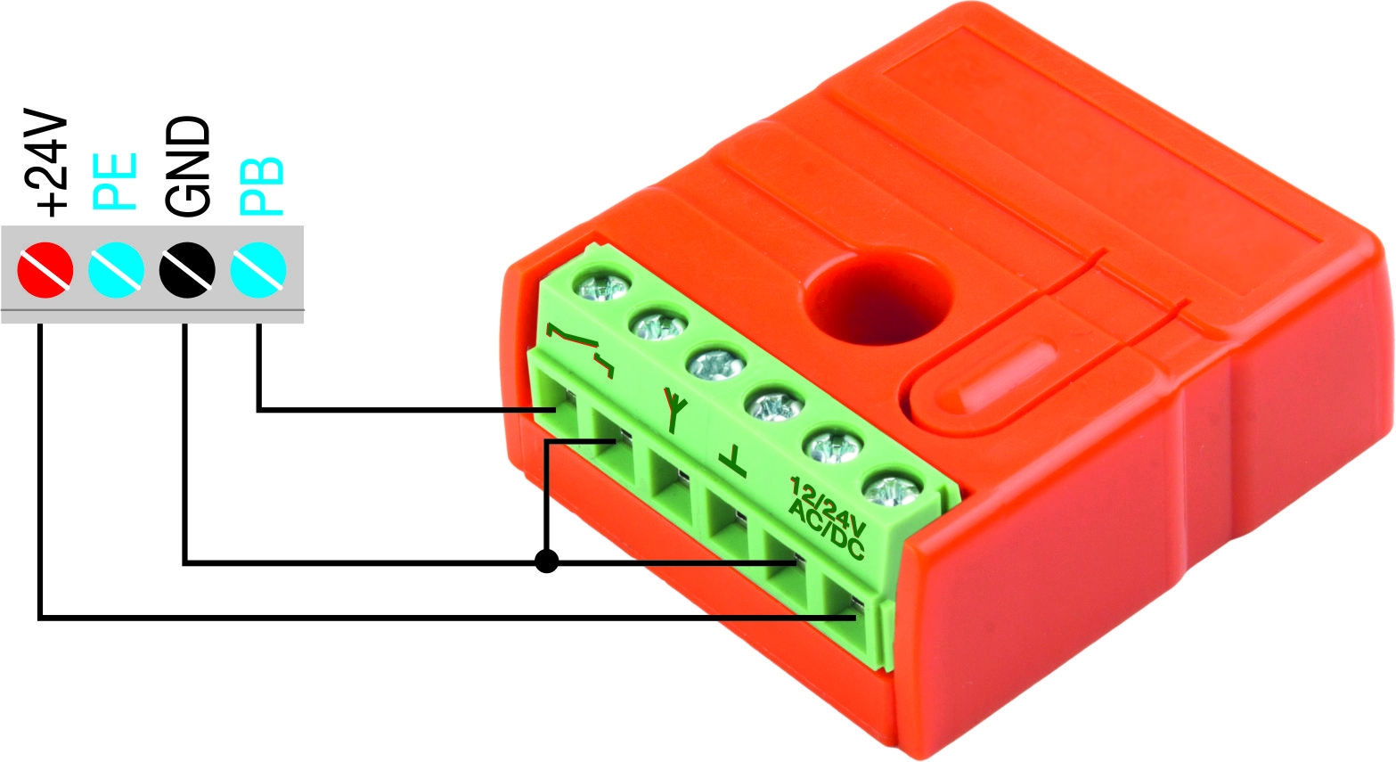

    Hello. I have the same entrance gate splendoor janus and I would also like to program the remote control replacement, unfortunately I lost the original one. From what you write, you can sign the proxima nm driver for the radio. Today I made an order for such a driver. Only could someone explain to me how to connect it? Thanks in advance. Regards
    #10 16749906
    PROXIMA sj
    Radio controllers specialist
    Posts: 516
    Help: 103
    Rate: 219
    Please,
    Regards
    PROXIMILIAN
    PROXIMAsj
    Polna 23A, Toruń, 87-100 | Company Website: www.proxima.pl

    Everything works as it should ;) I even open the gate with the remote control from the switchboard
