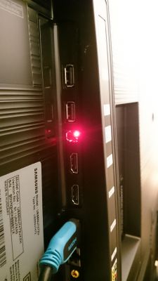

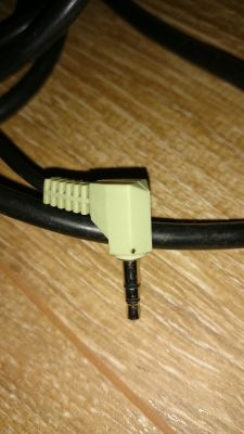

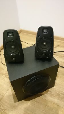

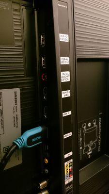

    StageK9
    Posts: 25
    Hello. I stick to the topic, my question is how to connect my logitechs to the TV and whether it will work out at all because when I read this topic, I do not know what is happening. Please write if I should buy something (adapters) or something like that to make it go.
    The photos and the equipment on them are mine and it is not about them.
