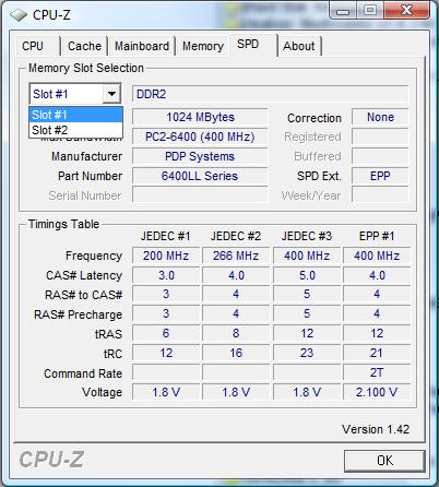

    How do I find out what timings to set for my memories?
    You can read on the packaging:
    Understanding DDR and DDR2 Memory Timings and How to Configure Them
    Sticker located on the memory module:
    or download the CPU-Z program from the Internet and in the SPD tab, read the settings saved by the manufacturer in the SPD system used for auto-configuration of memory via the BIOS.
