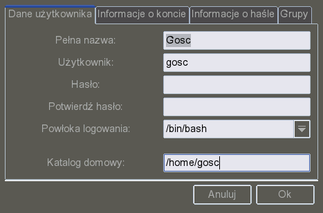

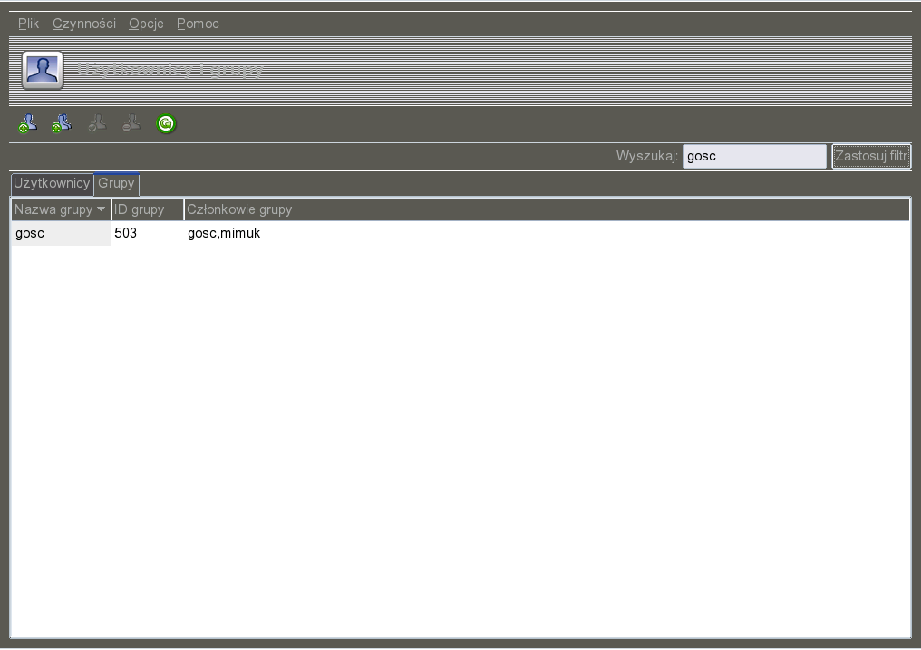

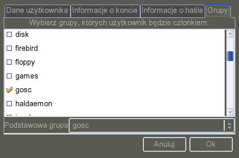

    One more thing that some have forgotten. We have to take care of the security of our files, so the user "some-that" should not be a member of other users' groups, God forbid, a member of the "root" group. The account should be configured in such a way that the "jakistam" user is a member of only one own group, preferably with the same name as the name of this user, and it must stay that way. If we have other users, such as the "mimuk" user and the "minuk" group, the "some" user cannot be a member of the "mimuk" group, otherwise all directories with drwxrwx-rx 775 access rights and files in these directories with permissions - rw-rw-r- 664 will be available for modification, and thus we run the risk of unintentionally or intentionally deleting them or changing their content. Therefore, when creating any new user who logs in without a password, he must limit the rights to our resources so that he cannot modify them. In order to have access to files of such a user without the need to log in to his account, it is enough to add the "mimuk" user to the group of the user "mimuk" and the user "mimuk" will be in the group "jakistam" and will have access to his files. For security reasons, you must also remember to prevent the user from logging in via the network.
    For the purposes of sharing files in the network, I set up an account called "guest" and a group "guest". My "guest" doesn't even have a home directory, I put all entries below for illustrative purposes, also a member of the "guest" group called "mimuk". To do this, I didn't need a console, I didn't edit any files in / etc for that there are windows, the times of editing configuration files are practically over. After all, for security reasons, I would leave the password in your place, entering a few characters is not that difficult. When he browses the Internet, he will log in to his e-mail in some cases anyway. One more login to the system is not a fad.
