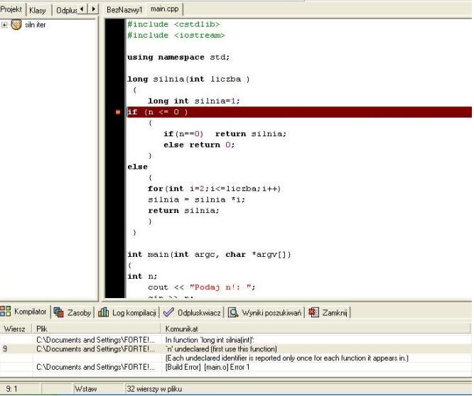

    I really missed this instruction and that was the problem. The function counts well is ok. And how to protect it so that it does not calculate n
    #7 6539594
    Łagu
    Posts: 18
    Maybe I can help
    [code:1:37fde233f7]
    #include
    #include
    using namespace std;
    long silnia(int liczba )
    long int silnia=1;
    if (liczba
  • #8 6545426
    piterus99
    Posts: 8915
    Help: 1084
    Rate: 328
    Compiling, please, compiling!
    Can you read messages? It tells you that you didn't declare the variable n...

    Tell me where this 'n' should be declared
    C++ Iterative Factorial Algorithm: Console Closing Issue, For Loop, Long Int Syntax
    Maybe it's hard to see, but something else always came out with the error. Where is this minor error?
  • #10 6547309
    pawelhabas
    Posts: 10
    It should be declared before using it, i.e. a line before this error :)
