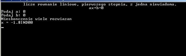

    So I wrote this program:
    int main()
      float a;
      float b;
      float x;
    cout << "         licze rownanie liniowe, pierwszego stopnia, z jedna niewiadoma.\n";
    cout << "                                    ax+b=0\n";
      cout << "Podaj a: ";
      cin >> a;
      cout << "Podaj b: ";
      cin >> b;
      if (a==0 && b==0) cout << "Nieskonczenie wiele rozwiazan\n";
      else if (a==0 && b!=0) cout << "Brak rozwiazan\n";
      x=-b/a;
      cout << "x = "<<endl;

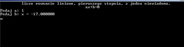

    The problem is that if I do not enter a number, but e.g. the letter L, some strange characters appear, and I would like it to show e.g. This is not a number.
    There is one more problem that if I give it 0 to a and 0 to b, it will show me that there are infinitely many solutions and also some other strange characters, and I would like these characters to be absent.

    My friend akartians , using goto makes no sense here. Why not use a while loop?
    This can be solved simply by adding else:
    else
            x=-b/a;
    Checking whether the variable loading was successful:
    cin >> a;
            if(cin.fail())
                    cout << "Blad" << endl;
    Regards Krzysztof.

    I haven`t used it, but my friend wants an example, so here you go:
    while(true)
      cin >> a;
      cin >> b;
      else
            x=-b/a;
            break;
    The program will ask for the parameters of the equations until there is one solution.
