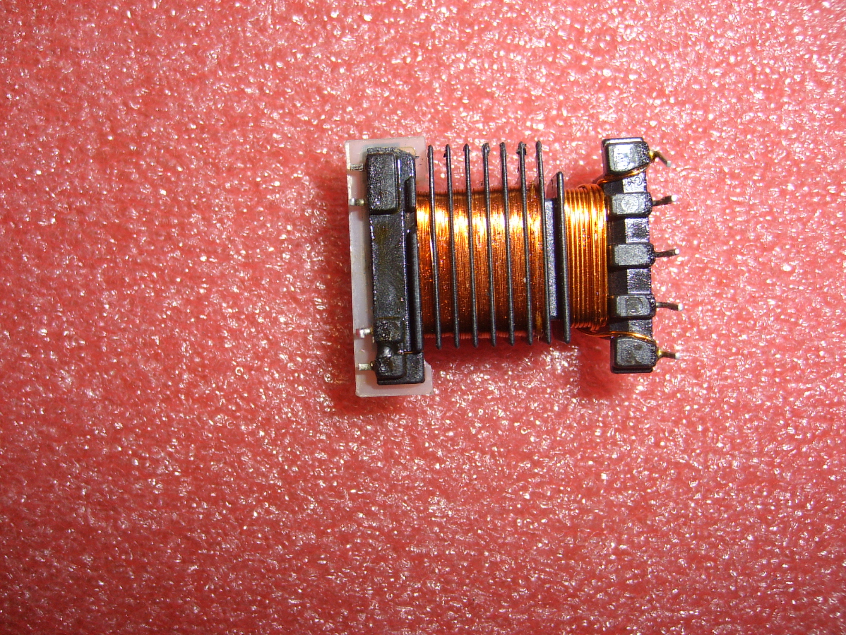

    The measured winding resistance WN first trafo - 240 k.
    The measured winding resistance WN second trafo - 1200 R.
    I conclude that one thing is damaged. which? What is the correct order of resistance?
    Is there a sensible attempt to repair, scroll damaged transformer or rather look for something from disassembly?

    It's easy to guess that about 1k is good, you will not pass it because you will not be able to break up without damaging the ferrite.

    Inverter images, damaged, successfully desoldered
    Hyundai L90D + inverter front
    Hyundai L90D+ Inverter Transformer Resistance Discrepancy - Repair or Replace?
    Hyundai L90D + inverter back
    Hyundai L90D + inverter trafo

    The designation was aptly printed on a transparent film, which was placed on the site of the disassembled trafo during shooting, seen in the first picture.
    read:
    FDH1743-08A
    BA 05C 044

    Some damage can be determined.
    1. Measurement on the primary side / winding wound with a thick wire /, the universal meter measures resistance, it should be in the order of 1 R.
    2. Resistance measurement of the secondary winding. In a good way it is about 1.2k.
    The given quantities apply to this specific trafo.
    A small resistance will indicate short circuit, a large gap - burned winding.
    These measurements may not indicate some inter-turn interferences.
    Unfortunately, I do not know where to buy such a trafo. I follow well-known auction websites.

    Mateusz Satgal, as usual, was right: "you will not squeeze because you will not be able to break apart without damaging the ferrite".
    The core has actually disintegrated into several pieces.
    In addition, the winding wire is much thinner than the hair and covered with varnish - it can not be rewound.
    Experimentally: the WN section in the visible location of the damage has been cut, cleaned and soldered. The continuity of the HV surge was obtained. The core debris was dropped, the whole goes with self-adhesive foil.
    Trab returned to the plate.
    The result: the monitor starts - a nice picture for a fraction of a second.
    It rather confirms my diagnosis - a hit to exchange.
    If someone had such, or if you could replace a similar one, I am asking for information.

    A hit that can not be won. I managed to buy a matching power supply board with the inverter, the monitor repaired, the topic closed.
