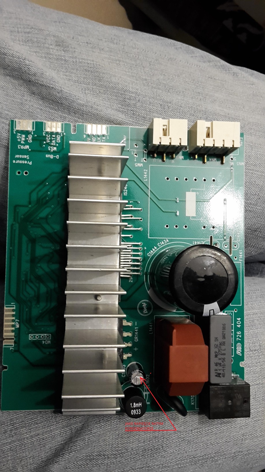

    The inverter in my washing machine failed. The burnt parts were replaced but the washer still showed the problem F57 . After further measurements, I came to the Hahn V17423 transformer. I found a transition only on connectors 6 and 7, but I think it's a jumper. In addition, there is no transition either on the primary or on the secondary. Could someone give me the data on which legs the primary and secondary windings are? What voltage should come out of the transformer. It is not commercially available, does anyone know a substitute?

    Take photos of the module from both sides, it will be easier to talk.

    As for this transformer, it is probably a choke of the anti-interference filter.
    In the photo you can see the elements you replaced (marked in red).
    However, the inverter does not work. In order for the inverter to work, it must have the correct power supply
    +5V to the processor from the power supply (you replaced the chip in it). did you check it?
    It's possible that the processor was also damaged when the PSU was damaged.

    You're absolutely right about that choke. I'm working in the dark because of course I don't have a schematic. Probably a layman's question, but what elements are included in the power supply? Is it on the inverter board?

    yoshi62 wrote:
    what components are included in the power supply?
    In the photos I marked the converter system and the capacitor on which the voltage should be measured.

    The measurements show that there is no 5 V power supply. The input voltage is 5 V and the output is 0 V. What should the input voltage be?

    Measure on the processor power supply, it is 99% damaged.

    Waste of your time. I did not want to write about it early, but in these modules it is so that when the converter system is damaged, the processor is damaged.

    I found the next bug :) Charred transition from one side to the other side of the board + LNK304PN power supply. I now have 15V at the output. A bit too high :) I will also replace the CPU if needed. Is the selected element a capacitor (because it looks like that)? I have a short circuit on this element.

    You obviously have a dead CPU. I'm curious how and what you program the new one.

    I think you're right and it's a waste of time. Thanks for the help.
