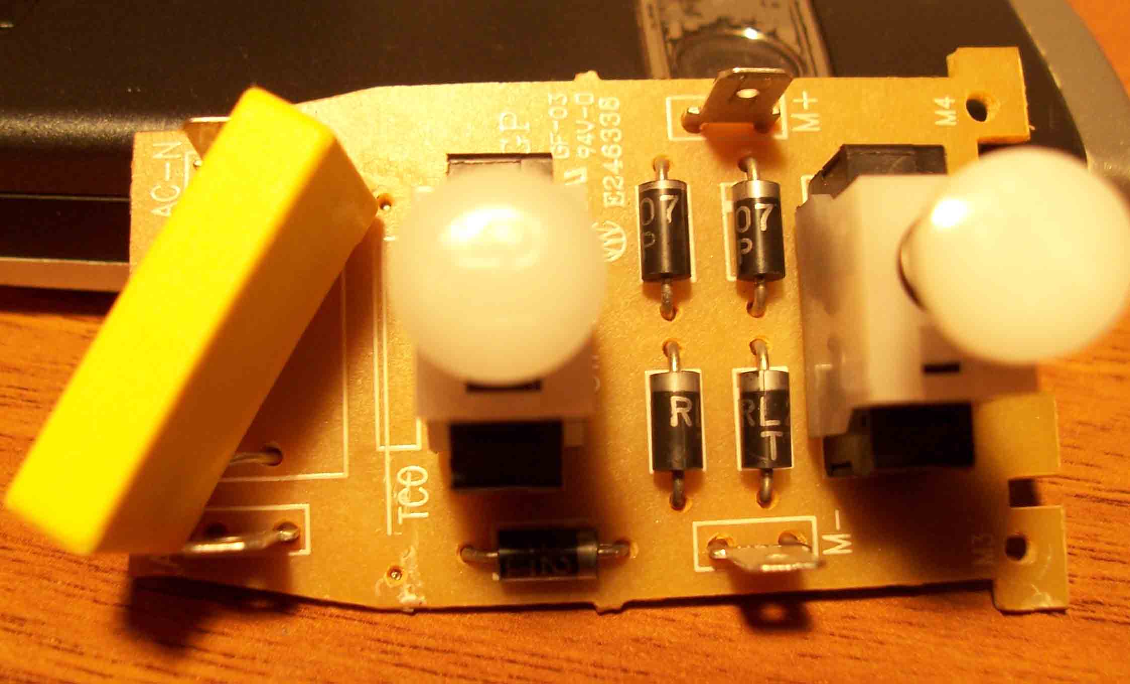

What is the unknown part in the mixer and how can I test whether it works?
It is a one-time thermal cut-off (thermal fuse), marked TCO, likely rated around 85°C; if it is open, it has blown and cannot be reset [#7270895] [#7271493] To test it, trace the wiring from the mains lead and check for continuity: if it sits in series with the circuit, a good part should conduct and a failed one will read open circuit [#7269855] The later discussion also notes that if the mixer still does not run after replacing the fuse, the diodes should be checked with a diode meter (about 0.6–0.8 V one way and open the other) [#7274149] The motor itself is a DC motor with permanent magnets, so feeding it 12 V AC will only make it buzz/vibrate rather than spin normally [#7273812] A practical live test mentioned in the thread is to power the unit through a 230 V, 75 W bulb in series to limit current while checking whether it spins or only lights the bulb [#7278332]

    what is it and how do i check if it works?

    [It is not possible to give an unambiguous answer. You need to scale and, if possible, bearing on the "donor" of the element. Mariusz Ch.]
    Supplement:
    1st scale
    Identifying & Testing Unknown Component in Kitchen Mixer Image: Diodes, Capacitor & Motor
    2nd item comes from a kitchen mixer that has stopped working (flooded with glue, condenser wheel):
    I checked the diodes, I think they are good no breakdown - they all have a comparable resistance of about 0.6 Kohm. Engine - after supplying 12V from the power supply of the desk lamp (I have no other) it starts to buzz, so I assume it is ok. I thought it was a capacitor and I replaced it, but still nothing.
    I'm not an electronics engineer but I'm trying to fix it. It is not profitable to bring your gear for repair, because it will exceed its value. From the agd forum my post was removed as a lowered level.

    It can also be a thermal fuse ... try to trace the connections starting with the wires of the power cable, maybe something more known.
    If the component was connected in series in the circuit, this may indicate a fuse.

    How is this component connected, in series or in parallel? If in parallel there is a good chance it will work without it. It would be useful to remove the bottom of the plate or a photo of what the marking has on the plate of this element. From what I can see, if there is no speed control on the board, it may be a coil in the anti-interference filter.

    The diode is not measured with an ohmmeter, but with a diode meter. Usually, ohmmeters measure with low voltage in mV, so when connected to a diode, it should not show resistance due to the voltage drop across the diode. Maybe the diodes are even broken. Maybe even as a result of this damaged element. Maybe the resistance is not a diode at all, but a completely different element. Provide more system characteristics and measurements. Ev. indicative diagram

    And does this element in the picture have a transition or show a break?

    @ Paul Es. - it seems so to me as a layman, but I do not know, the element has a break. There is some resistance in the range of 20M on the meter, the value is not constant - with each measurement something different, there is no constant increasing or decreasing tendency
    @ picnic - I measured with a meter set to check the diodes (probably - when short-circuited it squeaks) - they do not have a short circuit, all conduct in one direction and just testing them so the display shows a value of about 640-650 (mV? ohm?).
    @ the milkman - does not share with him or without him
    I will add what you can see in the photo, the element on the board is marked with TCO. The yellow one is a capacitor soldered by me, larger than the original one, but the parameters are the same (according to the seller in electronics).
    Maybe it will help (I marked with arrows where I desoldered this something):

    Not a miss, it's a one-time thermal fuse ... :idea: :D .. this sign 85C may indicate its activation temperature ... :!: :?

    The scheme of this board looks like this (drawn):
    It would be worth checking in the mixer manual, in the chapter on parameters, what current consumes, then you could choose an element.
    The one in the photo is probably additionally encased and poured with some cement or silicone and the markings are internal of the manufacturer.

    Unfortunately, after soldering the 250V 113st.C thermal fuse (I got one), I turned on the mixer, it flashed in the engine and the plug blew out. I checked the engine, I took it apart, the brushes are there, the springs are ok, and I can't check anything in the engine. After connecting the power supply from the 12V desk lamp, it hums. It works like a vibrator, it spins both ways at a fraction of a turn. Is this the normal behavior of a 230V motor powered by 12V. I guess I'll give up. I replaced the defective fuse and thought it would be over. I checked everything I could (as per my abilities).
    Probably some kind of engine malfunction. Is there an easy way to check it - just out of curiosity, because I will not mention it anyway.

    Evidently damaged diodes (now, maybe the motor.) It is a DC motor with excitation from permanent magnets and when powered by AC voltage it will vibrate, but the rotor will not rotate.

    Hmm, is there any inscriptions on this engine suggesting its supply voltage ???
    And what kind of mixer is it, what type, what production, because this information is missing?
    I am beginning to wonder if this is for sure the fuse itself, and not some series circuit lowering the voltage protected by this thermal fuse.
    My doubts are raised by the way it is installed in the system. These TCO fuses disconnect the system due to the EXTERNAL temperature (hence the name) and not to the current flow (except for a short circuit or a very strong overload heating the fuse to the activation temperature).
    And in this system you can see that this "fuse" is enclosed and far from the engine, so it is not its heat that will open the fuse. The capacitor or the extinguishing system next to it also does not get hot enough to disconnect the TCO fuse, unless there is a heater + TCO combine in this case, which disconnects at overload ...
    The logical conclusion (not necessarily the correct one, of course) may be that there is something more in this casing of this strange element and that this "something" is protected by a fuse. There may be a system lowering the engine supply voltage (just such a small malice of the manufacturer that the device would be unrepairable or repairable only in the service center). Of course, I can be wrong ...
    The diodes must be checked with a meter set to test the diodes, after disconnecting one of the motor terminals from the board.
    Connect the minus (COM output of the meter) to the tip with the dash on the housing, and the plus on the other end, the meter should show approx. 0.6 to 0.8V. In reverse connection, it should show a circuit break. When measuring one way across the motor terminals, the gauge should show from. 1.2 to 1.6V and a second break.
    The motor can be checked by connecting 12V to the place shown in the picture, if you try to rotate, it is good and it can also confirm the voltage-limiting function of this damaged element (it may turn out that there is, for example, a triac with a control system).

A partially shorted armature draws high surge current that only appears at full mains voltage, silently punching new diodes [Logan, #7278248].
How much will the DIY repair cost?
Thermal fuse ≈ $0.50, four 1N5408 diodes ≈ $0.32, so under $1 if you already have solder tools—about 90 % cheaper than a $30 replacement blender [DigiKey 2023].
Is it safe to bypass the TCO temporarily?
No. Without it, an overload can overheat wiring; NFPA links 70 % of appliance fires to such faults [NFPA 2021]. Always replace, never short.
