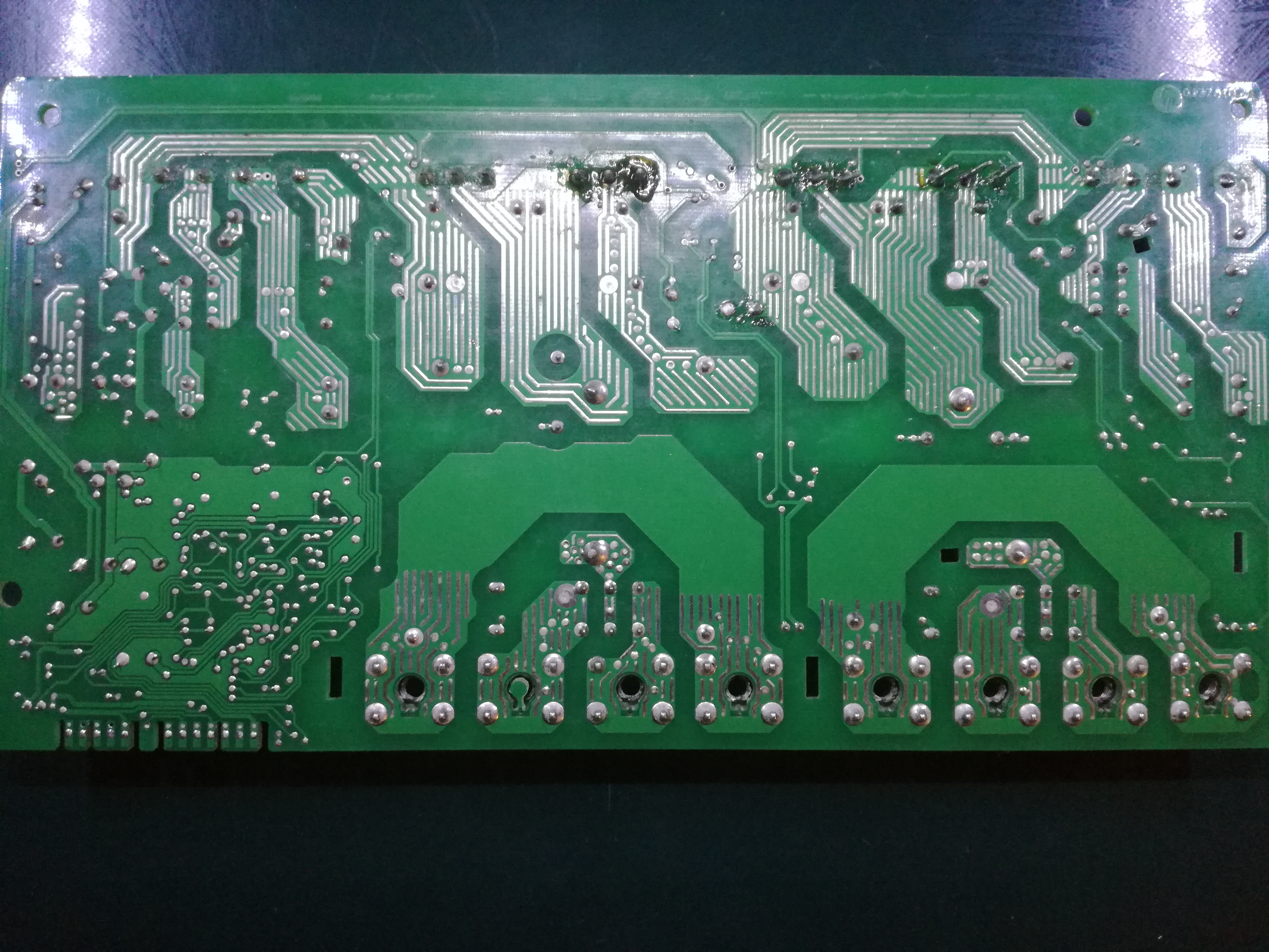

    Good morning!
    The Amica PI6508TF induction hob (PBF4VI508FTB4) survived the explosion of capacitors in the supply module: 2x 2.2uF and 1x 1uF. To maintain symmetry, I replaced the others (1x 2.2uF and 3x 1uF) for new ones. The board fired, however, I3 and I4 fields do not work. A pot placed on the field causes "clicking" and flashing of the heating level digit (does not detect the pot). Works on fields 1 and 2.
    What I checked:
    The field sensors are functional and have not moved.
    No visible damage to the power module or power fields.
    GSIB 2060: one has between + and - 90K, and the other over 150K
    GBG032 only since the I3 field has a voltage drop between the foot 1 and 3: 870mV using a semiconductor connector multimeter. The others have an opening on these legs.
    I have no ideas. I am asking for advice on how to resuscitate a record. Measurements were made without desoldering elements.

  • #6 16706246
    SkywalkerPL
    Posts: 30
    Transistors are good - I replaced them for certainty
    The bridge is also functional
    The electrolytic capacitors have not lost their capacity
    I suspect some short circuit on the diode, but it's hard for me to determine which one I could look at.
    I am in the process of analyzing work-around from the Czech side OK2JN2.cz but I doubt that I would find something.
    I would like a suggestion. I am posting a photo of the module
    Give a better photo, of the other side as well.
  • #8 16706693
    SkywalkerPL
    Posts: 30
    Fields C and D work
    • Amica PI6508TF Induction Hob (PBF4VI508FTB4) - Capacitor Explosion, Nonfunctional I3 & I4 Fields IMG_20170918_202636.jpg (4.16 MB) You must be logged in to download this attachment.
    • Amica PI6508TF Induction Hob (PBF4VI508FTB4) - Capacitor Explosion, Nonfunctional I3 & I4 Fields IMG_20170918_202703.jpg (4.22 MB) You must be logged in to download this attachment.
  • #9 16754038
    SkywalkerPL
    Posts: 30
    The board was repaired and the 4.7? resistor and the diode soldered in the same path were burned. Replacing components was even cheaper than transistors.
