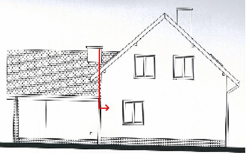

    Hello, I'm asking for advice...
    I have such an unlucky location and construction of my house that when the wind blows, it pushes smoke from the chimney into the ventilation holes on the chimney...
    Chimney Smoke Backdraft into Home Ventilation: How to Prevent It?

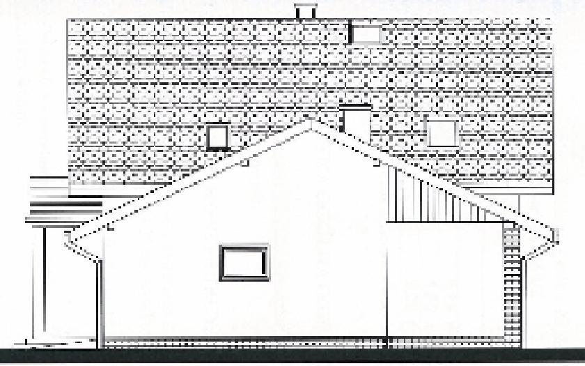

    The unfortunate thing about the structure is that the fireplace chimney is above the garage, which is attached to the "house proper - the residential part"
    The chimney is very close to the junction of one roof into another... I have a theory that when the wind blows, it compresses the surfaces of the roof and spreads in all directions - falling into, among others, the ventilation grates that are on the sides of the chimney.
    There are no "vents" installed at the top of the chimney yet? - smoke comes out directly from the hole at the top of the chimney.
    What can be done to avoid such situations?
    I will add that after observing the smoke coming out of the chimney, it looks like one big smoke ball - it expands in all directions.
    In the second picture, I marked in red the channel through which smoke flows into the grate in the kitchen - where, fortunately, I have a hood. If I forget to turn it on, smoke starts coming in there when there is a stronger wind.

  • #2 7499138
    mucioo
    Posts: 303
    Help: 22
    Rate: 26
    Also mark the path of the escaping smoke - it will be more transparent, your description shows that the chimney is right next to the vent. Be more specific about it.

  • #4 7499186
    jaromisz
    Posts: 271
    Help: 18
    Rate: 12
    The smoke escapes through the combustion pipe, which runs parallel to the ventilation duct marked in red. The stove is in the garage, at the foot of the chimney, if I may say so.
    As a result, smoke from the chimney flies out just above the outlet of the vent duct.
    When a breeze blows, the smoke "rolls up and curls into the vent."
    I would not like to significantly increase the smoke outlet by inserting, for example, a sourdough pipe into the outlet of the furnace channel
    Added after 3 [minutes]:
    Now I came up with an idea to control the fan speed based on the wind force sensor - if the wind blows, the engine speed would immediately increase.
    But apart from the solution - what is the reason for this?
    Extending the chimney with a pipe is perhaps the only effective solution because the smoke will billow higher and will not fall into the grates on the chimney. Anyone else have any suggestions?
    #5 7499204
    Magister_123
    Level 36  
    Posts: 2891
    Help: 378
    Rate: 972
    The only one-time paid method will be to raise the chimney with exhaust gases to a level higher than the large roof and install the so-called fireman.
    Read about the rules for building chimneys.
