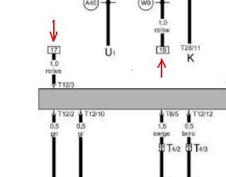

    Hi. If I may, I'll hook up with a similar problem regarding the symbols used in automotive wiring diagrams. There is no explanation in the diagram legend, so I will ask here. What does the rectangle with the number in the middle mean ?

    On the schematic, under the minus (ground) strip, a sequential numbering of circuits is carried out. The number in the rectangle indicates from which place on the schematic the circuit comes, or where the continuation of this circuit is. The example part of the schematic is too small and you can't see the lower strip with the minus connections (terminals 31) under which is the circuit numbering.
    If there is still something unclear, I will add it.

    here you go, the whole excerpt

    On this excerpt are shown circuits from No.29 to No.42. To locate circuits 17 and 19 (numbers in rectangles) you need to look for them on the previous parts of the diagram. Is everything clear now.

    You have misunderstood. 17 is not a mass point.

    !7 is the no. of the circuit that is described under the minus line. In the circuit above 17 there will be a rectangle with No. 29, and in the circuit above 19 there will be a rectangle with No. 33.
    Write down if you found these circuits. A circuit in this sense is the vertical connections over the numbers under the minus line.

    Simply put, in other words, on the excerpt from the schematics containing the number 17 under the dash, look for further string the red-white wire of 1.0mm² (RO-WS 1.0) with square 29, which is written about by Colleague A.pacz .

    Thanks. I already caught what's going on with the rectangles. I have one more dilemma because I don't quite get it. How to interpret the perimeter, since there are the empty ends themselves ( I think that's how the female end is marked but I'm not sure )? What in turn is meant by that 12 in the black rectangle and pins 1,5,7,8 and 9 ? Judging from the schematic as a whole, pin 1 should be connected at startup to line 31, as long as the bendix and starter relay solenoid are powered from this line and further up to the starter, what about the others ? Is this perhaps how the connection to the ignition switch is marked ?

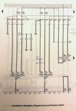

    Can someone suggest what the author meant by N1 (in a circle) and B9 (in a circle)?
    Deciphering and Understanding Car Wiring Diagrams: A Case Study on Lanos Schematic
    E4 is the long light switch in the steering wheel. Why does the low beam line go there?

    N1 and B9 are the branch points of the wires.
    There is no legend to the diagram and this is just a fragment of the diagram. Turning on the high beam turns off the low beam.
    Are you sure? After all, jumper B9 connects J2 and J3.
    To my knowledge in Passat B4 - high beam turn on as additional bulbs.

    What is J2? It goes somewhere else... High beam is 56a, low beam is 56b, 58 is parking lamps.
    I can't read the function of switch E4 from this diagram. The legend and the rest of the schematic are missing. What car does this part of the schematic apply to? VW is not my hobby ;) turning off the dipped headlights depends on the version of the lamps, when they are on dual filament bulbs (e.g. H4) they are turned off, when they are on separate bulbs, they usually light simultaneously.

    In my opinion, this is a light horn, that is, in one position you flash the long and the low beam (even if they were not on), and in the opposite position you turn on only the long (the low beam shines "through" the light switch, which is not in this diagram).

    tzok wrote:
    In my opinion, this is a light horn, i.e. in one position you flash the long and the low beam (even if they were not on), and in the opposite position you turn on only the long (the low beam shines "through" the light switch, which is not in this diagram).
    Thin lines in the schematic are explained as "internal connections" i.e. connections inside (usually in the fuse box).
    The voltage to the low beam goes from the light switch- internal line h (I know this from another part of the schematic - not connected here), comes out with connector J2 (this is already visible on the schematic attached here), goes to point B9, then there is again an "internal connection" that leads to connector J3, further it flies to fuses S1, S2 and to the bulbs.
    I don't know why on this diagram flies from point B9 voltage to the high beam switch (E4), and I asked about this.
    After all, to this E4 flies the battery voltage (30) and this is switched on the high beam.
    From practice, however, I know that when my low beam switch failed (the one that provides voltage on the h line), then with the handle (that is, here E4) it was not possible to permanently switch on the high beam. They lit only as long as I pulled the handle towards me - when I let go - they went out.
    So the connection from B9 to E4 - it matters :) .

    Diagram our for separate bulbs for low and long. With the light switch you turn on the low beam - jumper B9 to J/3. Turning on the long - E4 short circuits 56 with 56a. Both bulbs are lit. So-called click regardless of the position of the light switch - connects 30 with 56a.
    However, if there were headlights for one H4 bulb, the scheme would be a little different. There would be no B9 jumper and there would be a J/3 connection to E4 T5b/2.

    Long-range switch - E4 short circuits 56 with 56a. Both bulbs are lit.
    That is, in this situation, the light switch is loaded with 4 bulbs?
    I mean 220W (4 x 55W). I thought that the high beam bulbs are then powered from 30 (battery +).
    In that case, the 1.5mm2 wire is a bit on the contact.
    Isn't it worth giving a relay reliever for high beam and low beam behind the E4 switch (one light switch has already died for me)?

    All in all, I hadn't thought of that.... this switch in one position feeds the long from the low beam circuit (and this is the stable position), and in the other position it feeds the long directly from the battery (and this is the momentary position). Connection 56 (T5b/3) is therefore the input (not the output) of power from the low beam.

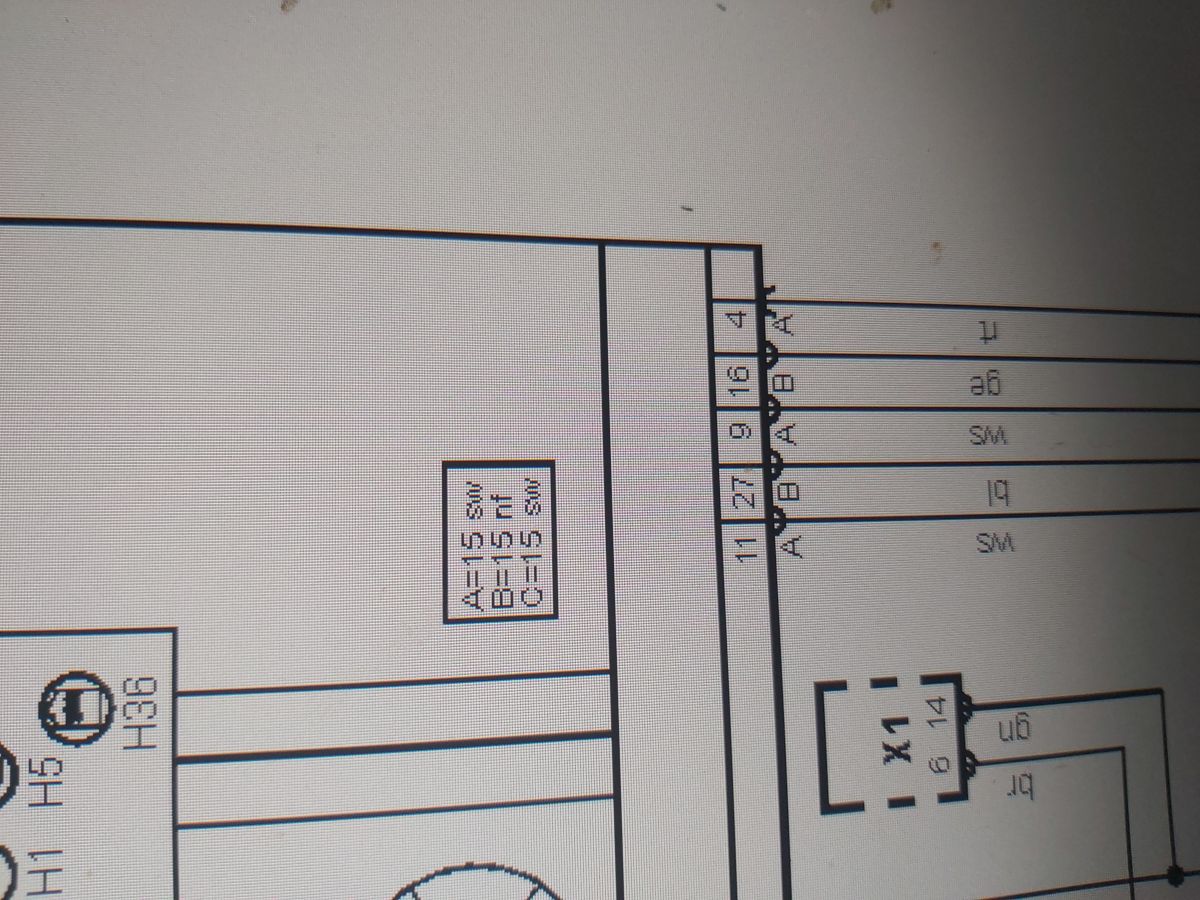

    Hello, diagram from Auto Data. What is this information in the rectangular box A=15 SW B=15 NF C=15 SW about?

    You are referring to the connectors (sockets) of the module in question A=15sw is the 15-pin black connector, but as you can see on the fragment of the diagram in connector B pins 27 and 16 are manned and in the description it is B=15, unfortunately in Autodata there are mistakes on the diagrams
