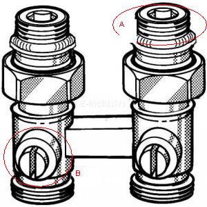

    I will not start a new topic, because I have a similar problem, only with the bottom connection of the Keller V22 radiator. Namely, as in the attached drawing, the radiator started to leak at points A and B, of which I tried to tighten the A with a hexagon socket, but it did not do anything, but I have not moved yet place B. I have no idea how it is sealed and how to seal it so that it lasts until spring. The radiators are 3 years old, funnily enough, leaks often appear when the water in the CO is cold, and with hot radiators the leaks disappear, sometimes there is a leak at point A, but the one from place B is still there.
    With what I could somehow seal it. Maybe someone has a cross-section of a similar valve with gaskets?
    Thank you in advance for your help

    I am afraid that it will not be possible without replacing it with a new one. Just buy a company one, not some trash in a supermarket.

    These flare fittings were included with the Keller V22 radiators. Which company do you recommend? I will only replace screw fittings in the spring, after the heating season. If I have a charging furnace, the temperature of which ranges between 60 and 80 degrees (on the return I try not to exceed 60-65 degrees, but sometimes it reaches 70 degrees) are there any stronger screw connections for that ??

    Place "A" can rather be sealed (either tuck the nipple with Teflon / tow, or replace the gasket on the flare nut, if there is one), the problem with place B will be a problem because the sealant has let go and it is a non-replaceable element.
    The Honeywell valve will last longer.
    Meanwhile, if you do not want to drain the water during the heating season, the only solution will be a bowl under a leaking valve.

    Thanks for the help. Now there is actually a container under the valve all the time and it drips from it, sometimes not. You worried me a bit about Keller, because the installers praised the company, describing it as Polish Purmo. Well, I have to look around for such valves and replace in spring-summer.

    Our colleague Zbigniew is right that most often it is the lack of alignment that makes the valve leaky. In my case, it turned out that the valves under the radiators (the so-called pants) were manufactured by Diamond, after consulting the service and presenting the case, it turned out that there was a period when Diamond had a problem with the centering machine. The service center sent me new valves and took the old ones with them. The problem is now resolved and has not recurred to date.
    For my part, I respect Diamond for being able to admit he was wrong. Now I always take valves with an additional cap, which will additionally protect in the event of a slight leakage.
