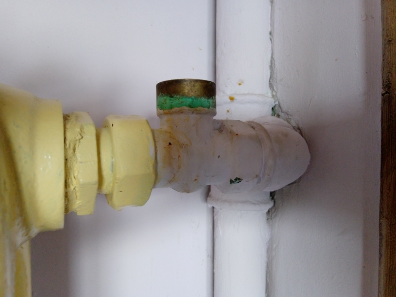

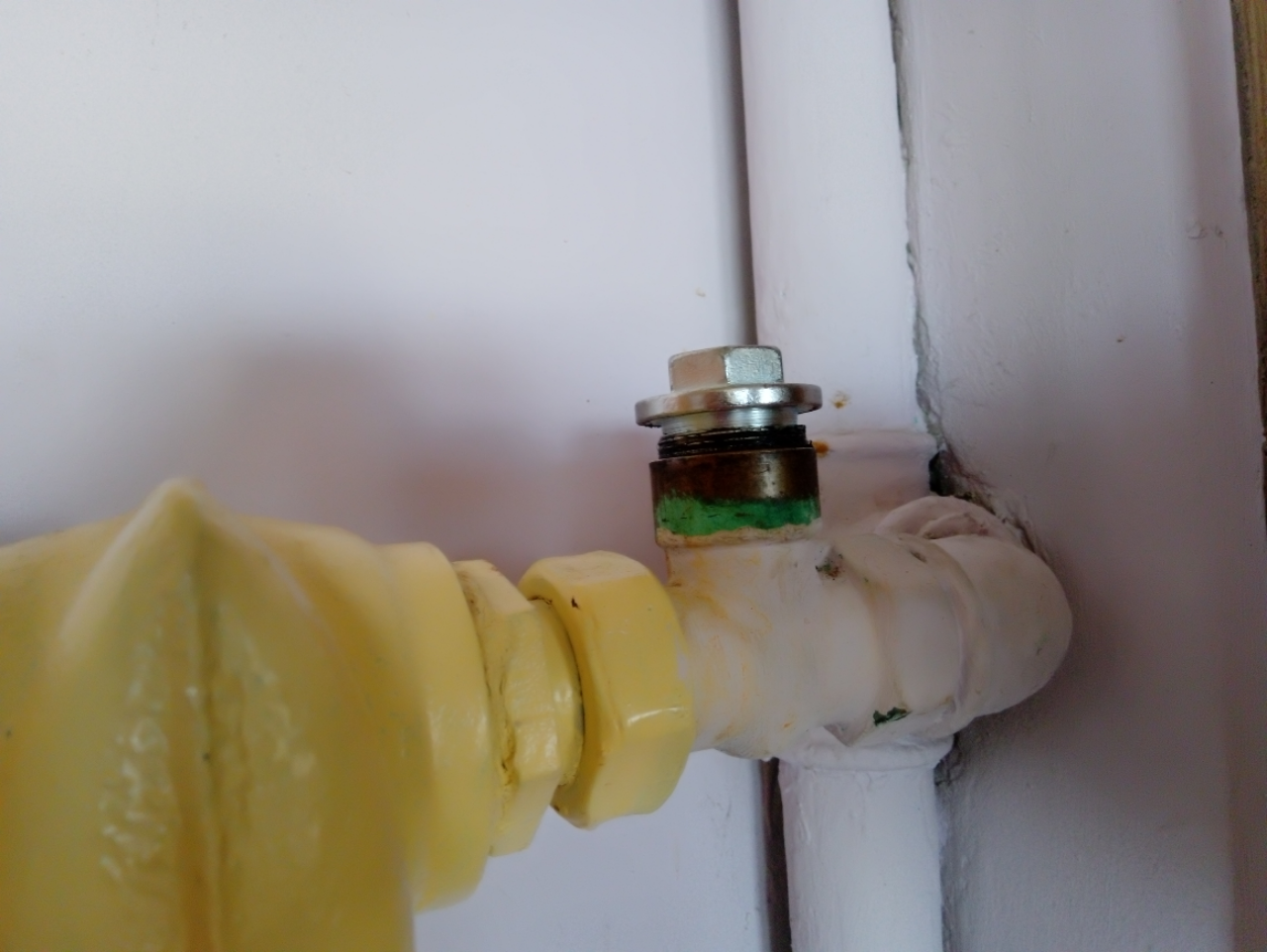

    I have a question, where is this packing cord installed? As you can see in the photo, there is a rubber O-ring in my gland, but the valve is dripping slightly so I have to seal it somehow. Does this cord replace this black O-ring? Should a packing cord also be attached to the thread of this hold-down nut?

  • #25 18178615
    Zbigniew Rusek
    Posts: 3613
    Help: 394
    Rate: 1542
    If there is an O-ring, no rope is given, no tow. You need to inspect this o-ring and, if it is worn (even if it is minor), replace it with a new one, and check the inside of the valve for any scale or sand, as such contamination can cause bad sealing by the o-ring. Maybe this O-ring is too thin.

    Bałdyzer
    Posts: 1419
    Rate: 227
    Zbigniew Rusek wrote:
    If there is an O-ring, you don't get any rope, tow. You need to inspect this o-ring and if it is worn (even if it is minor), replace it with a new one, and check the inside of the valve for any scale or sand, as such contamination can cause bad sealing by the o-ring. Maybe this O-ring is too thin.
    I took out the o-ring and it is not damaged anywhere. I will ask if there is a leak from this type of valve due to a cause other than this O-ring? I am asking because I have the impression that the water slowly comes out from the very top of the head, i.e. from the area of the square spindle on which the knob is placed.

    mczapski
    Level 40  
    Posts: 6247
    Help: 468
    Rate: 1658
    You probably have a good impression. The o-ring on the thread only seals the threaded joint. Now you have to get to the valve spindle, i.e. probably remove the protection from the spindle and only check the seal. I can't deal with the photos in detail, and I don't think I have such valves at hand.
    It looks a bit that the part on the side of the knob is a gland sleeve. So it would be unscrewed like in many valves. There is a sealing material under the sleeve (surely some rope).
  • #28 18179205
    Zbigniew Rusek
    Posts: 3613
    Help: 394
    Rate: 1542
    If at this point (from the spindle axis), the reason is the throttle (these leaks are quite common, especially when you turn these valves). Normally there should be one more nut holding the gland in place, but the photo does not show the gland at all (no photo with square tip end view). If there was a gland, the O-ring would also be inside (with frequent spinning, it would wear out) and the repair would consist in replacing it (sometimes you would stuff an asbestos string / tow saturated with tow or thread paste and tighten the nut). This valve is strange - it does not look like a radiator valve at all, or something unusual.

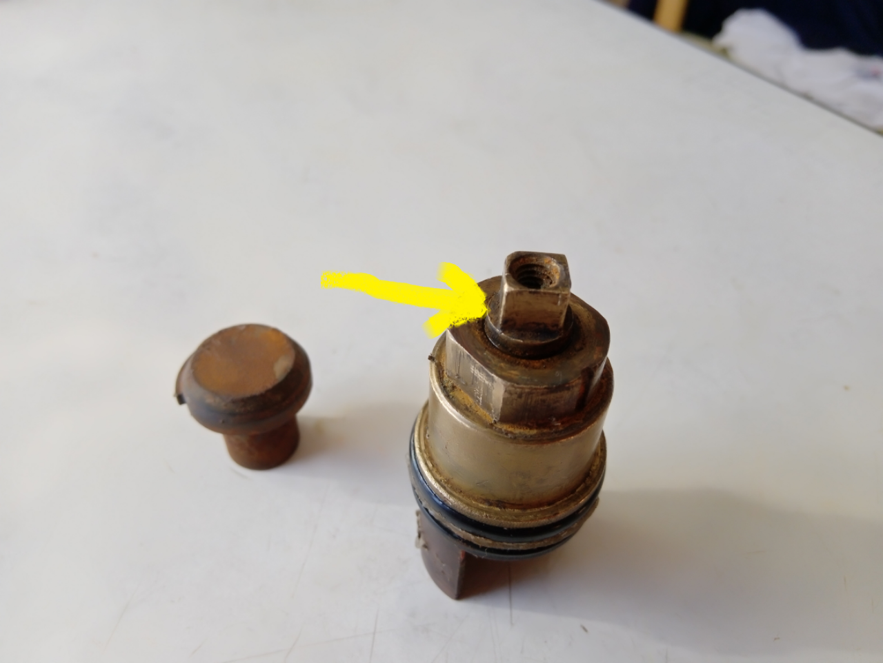

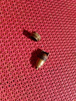

    I drained some water from the installation and took the head out of the valve. In the photo, I marked the place where the water is leaking with an arrow. Can any of you tell me how to disassemble such an old head to somehow seal it inside?
    Old-Style Radiator Valve Leakage Repair: Fixing Cast Iron Radiator Valves, Replacing Gaskets/Heads
    For now, I bought a plug with a M30 x 1.5 thread and blocked the valve so that there was no leakage

    This is not a typical head of an old radiator valve, where the seal (gland) is tightened with a cap nut. It looks to me similar (in terms of the spindle structure) to those of the bath / washbasin / sink faucets from the so-called stationary spindle. Theoretically, it can be dismantled - it has to twist the spindle so that the entire spindle goes beyond the head from the back. There is definitely an O-ring on the spindle axis and it is probably worn (from temperature control, and this is a radiator, so the valve was hot, which causes faster wear of the rubber) and it needs to be replaced, and then the valve assembled. I would suggest replacing the entire valve (with a thermostatic head). Attention. The head should be placed horizontally (if it is thermostatic) and not vertically above the supply pipe, as vertical placement (upwards, i.e. directed over the supply pipe) will distort the interpretation of the temperature, as the heat from the hot pipe will heat the head) - from two bad points it is better give it vertically, but downwards, and preferably horizontally - the latter is the correct assembly. Of course, this requires draining the water from the installation (at least as much so that there is no water on a given floor).
