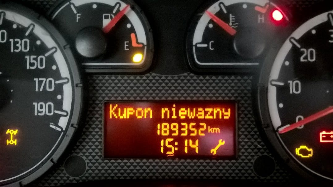

    Does anyone on the forum know what the message in the topic displayed on the on-board computer display in the Grande Punto together with the service key icon means?
    How to get rid of it?
    Regards.

    It displays a message in Polish "coupon invalid" and a service key icon appears next to it.

    Unfortunately, this is written IN POLISH! It may mean "inspection", something like a service inspection:
    http://www.fiatbravoklub.pl/forum/viewtopic.php?f=76&t=1195

    Most likely, the car is equipped with a factory radio and the "Blue & Me" set. This message applies to this set. Go to the service center, they will connect the computer and the message will disappear.

    The car does not have a factory radio or blue&me :cry:

    The message means that the "allowed" mileage since the last periodic inspection has been exceeded (20 or 30 thousand km depending on the version). Previously, it should have informed each time the ignition was turned on that xxx km (less than 1000 km) were left for the service. The message will disappear after "deleting the service" at the dealership. A basic inspection at an authorized dealership costs approximately PLN 400. It is not possible to manually delete the "inspection", although the message will disappear by itself after driving 1000 km since its appearance.

    Thank you for the factual answer TZOK - the only competent one...
    It happened as my friend wrote - the message disappeared after 1000 km.
    Regards.

    It is true that the problem with the "Coupon invalid" message appeared in Panda 1.3JTD 2010.
    The message appeared while driving. After turning off the engine, it could not be started. The starter turned, no ignition. The message was accompanied by an intermittent sound signal.
    Diagnosis:
    Panda 1.3JTD models manufactured around 2010 - 2012 had protection against driving "without inspection" without deleting the mileage for inspection.
    It is possible that the previous owner did not delete several inspections and the engine blocked.
    After connecting, clearing the error and inspecting, the engine starts.
