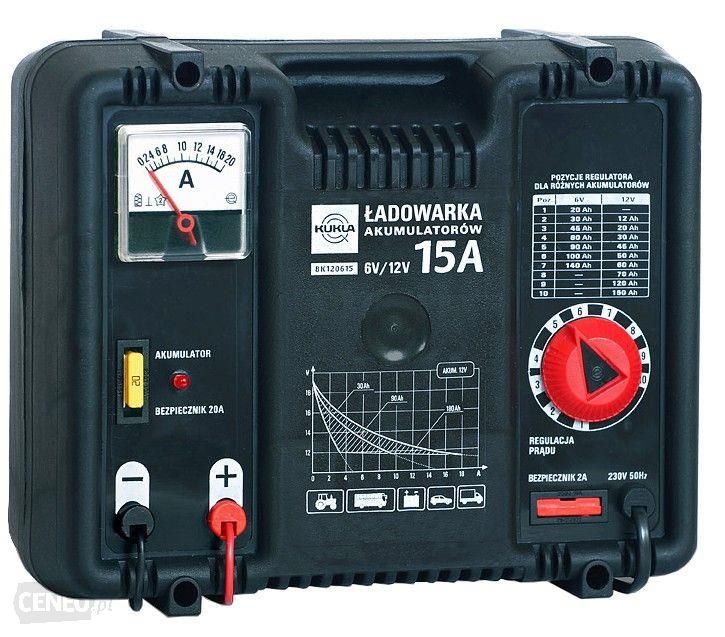

    Tension - fact ;)
    How much should I charge the 72 Ah battery with this charger next time with the potentiometer set to "8" because 30h is rather too much ...

  • #24 16875951
    zybex
    Helpful for users
    Posts: 15913
    Help: 2094
    Rate: 2933
    Recently, I was charging the battery with such a charger as in the photo. In fact, I just recharged it, because the car was left unused for a long time. I set the current to 8. From time to time I looked at the ammeter and the current gradually decreased. After about 3 hours, the charger disconnected the charging. There was nothing on the ammeter and the LED was green. I have not disconnected the battery yet and after some time it started charging again. This time with a much lower current, of the order of 3-4A (even though it was set to 8). After some time, the charger disconnected the charging again. This is where I finished my reloading.
  • #25 16877380
    Rysio4001
    Heating systems specialist
    Posts: 2995
    Help: 609
    Rate: 1063
    zybex wrote:
    ... the charger disconnected charging ... ... after some time it resumed charging ... ... After some time the charger disconnected charging again
    Yes, because this invention heats up a lot, and so that it does not burn, it has a bimetallic thermostat on the transformer (if it can be called a transformer), which temporarily turns it off to cool it down.
    I know, because once I had such a rectifier under repair, and when I looked inside, I was scared.
    I even took photos, and as far as I remember, I even published them somewhere on the forum.
    Trash, trash, and trash again, plus the level of security - no comment.
