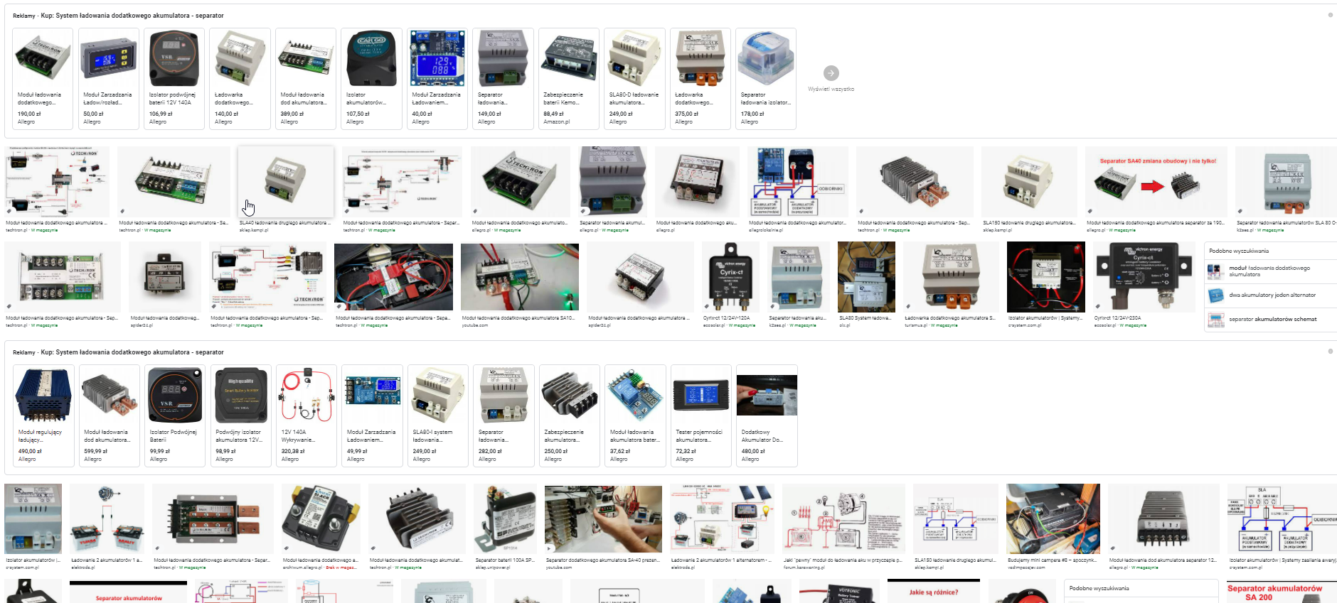

    Additional battery charging module - SLA Separator and everything works Charging Dual Batteries with Single Alternator: Rectifier Diodes or Electronic Circuit Solution

    What exactly is such a beauty called and, for example, where can I buy something like this? You've got me very interested in this because it's exactly what I need. Thanks in advance for the info.
  • #16 19843621
    nuszek
    Level 30  
    Posts: 1421
    Help: 123
    Rate: 388
    Everything has to be served on a platter! And there are thousands of them, look for a model and ask if anyone has one and how it works.
