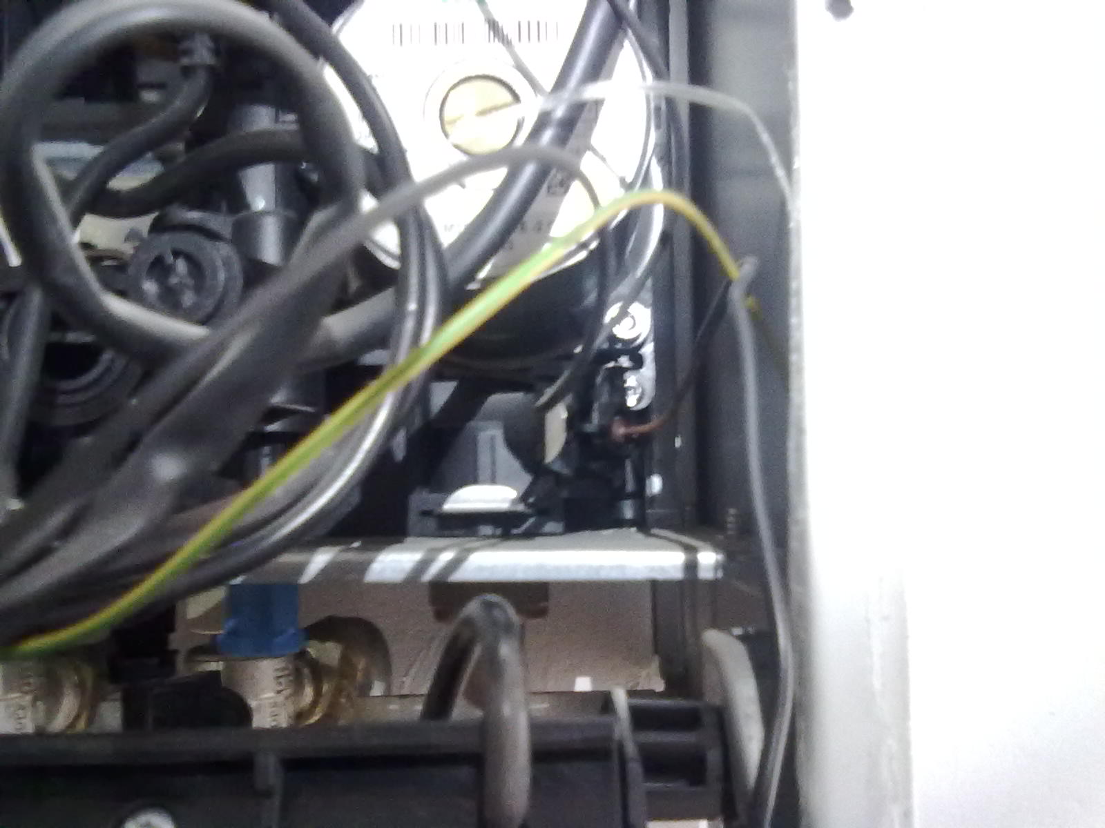

    I can ask for a larger photo of this filter, there is little to scare in this small one

  • #12 9150432
    ol_an
    Heating systems specialist
    Posts: 338
    Help: 46
    Rate: 130
    You are looking for something poorly. In this photo, look for what you will see in the attachments below
    Ariston Clas 24FF Stove: Flow Error 104 - Oven Stops, Cleaning 3/4 Filter, and Black Flakes
    Here in the "exploded" drawing
    marked elements here in your photo
    Hope there will be no problems with the location of the filter anymore.
  • #13 9150449
    ilio
    Posts: 37
    Rate: 17
    and I thought that the sensor is only fastened there ...
    well, 7 years of study were in vain ...
