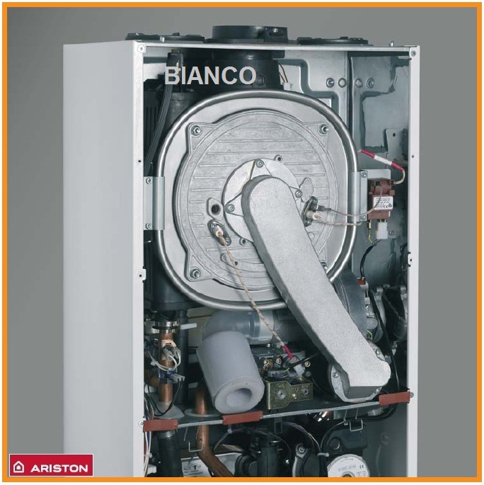

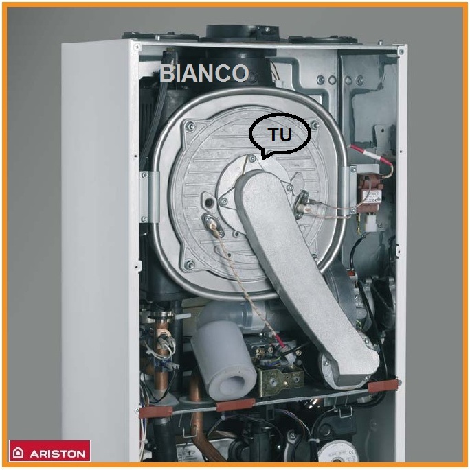

  • #14 14294855
    GregZorbaEmmanuelYork
    Posts: 139
    Help: 15
    Rate: 39
    Krzysiek8102 dnia 05 Sty 2015 13:42 wrote:
    I have genus premium
    is this what he looks like?
    Ariston Genus Stove Error 501 Flame Failure Despite New Parts and Service Checks Ariston Genus Stove Error 501 Flame Failure Despite New Parts and Service Checks
    The 501 problem was solved by someone on a well-known auction website and offers to fix this error.
    This does not change the fact that these burners have problems with conduction, i.e. with the burner grounding. Especially if the "service technician" disassembles it and reassembles it incorrectly.
  • #15 14295868
    Krzysiek8102
    Posts: 17
    Rate: 14
    Unfortunately, the shape of what feeds the gas to the burner is different, there is a different air inlet and the entire bottom is different, but how to find where it is incorrectly assembled, anyway, as I wrote, the service will be there again in two days and they will decide, I will let you know what How.
