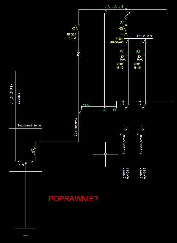

    Hello dear friends!
    Please analyze the two drawings below.
    Briefly about the topic. There is an old house and a connector on the wall. Power supply from the pole with a 4-wire cable. Power supply to the apartment on the first floor via a 4-wire cable.
    A new TN-S installation and switchgear prepared for TN-S have been installed in the apartment.
    I understand that the most optimistic solution is to ground the PEN distribution point, i.e. connect PE from the ground electrode to the board.
    So this is the arrangement:

    What if it is not possible to conduct the EP? Will grounding the N point in the connector do the trick?
    What I mean, of course, is whether the differential will work, because that`s what the problem comes down to.
    I will be grateful for factual answers, because there are various versions on the forum - extremely different from each other.
    Thanks for the help in advance.
    EDIT: there is an error in the drawing: the N wire in the switchgear is disconnected with a 4-pole disconnector.
    EDIT2: Sorry, I`m pasting the pictures correctly
    layout 1:
    TN-C to TN-S Conversion in an Old House: Grounding at Distribution Point?
    layout 2:

    The power supply to the building and the entire installation is TN-C. Only the apartment being renovated was constructed with 3- and 5-wire cables, with the planned power supply being connected to the connector with a 5-wire cable.
    Unfortunately, for some reasons, the 4-wire power supply had to remain.
    The question is whether the 4th wire of the power cable from the pole can be called PEN, but since it is grounded in the transformer station, it probably is.
    Is it possible to ground PEN in a connector? Ew. without interfering with the connector, make grounding along the way (between the connector and the board there is a box with protection which I have not drawn).
  • #3 9337370
    Miniax
    Electrician specialist
    Posts: 1438
    Help: 173
    Rate: 290
    The first thing you should do is call ZE and ask about the network layout.
    If it turns out that it is TN-C, then you divide the PEN wire in the RG into PE and N by inserting this wire into the PE strip and then bridging it to the N strip. Grounding the distribution point is not required. Additionally, a 4-pole disconnector is also unnecessary - a 3-pole one will be sufficient. As for the PEN grounding in the connector, you can do it, but the connector probably does not belong to you, so you need to contact the administration in this matter.
    Moreover, in the drawing, if you separate the PEN cable in front of the FR, where do the four wires come from to the FR?
  • #4 9337474
    remik_l
    Posts: 1151
    Help: 144
    Rate: 325
    PEN conductor cross-section too small.

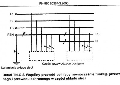

    If a TN-CS network system is used, the protective-neutral conductor PEN is separated into a protective conductor PE and a neutral conductor N should take place in the connector or main switchboard of the building, and the separation point should be earthed. This ensures that the earth potential is maintained on the PE protective conductor connected to the conductive parts of accessible electrical equipment.
    If the PE wire is not grounded, it poses a risk of electric shock in the event of a receiver failure! Electrical voltage may then occur on accessible conductive parts. Therefore, the division point (or PE conductor) must be grounded.
  • #20 9369007
    neo_dc
    Level 32  
    Posts: 2206
    Help: 178
    Rate: 211
    Not necessarily in the main one, although it is a recommended practice that sometimes does not work, especially during renovations and expansions of installations.
    With a functional PEN cable, the earth potential is also maintained. Remember that the PEN should have the appropriate cross-section.
    If it is not connected to the distribution point at all, otherwise the RCD will always work in my opinion.
    Grounding the split point is good practice and improves safety, but is not required.
