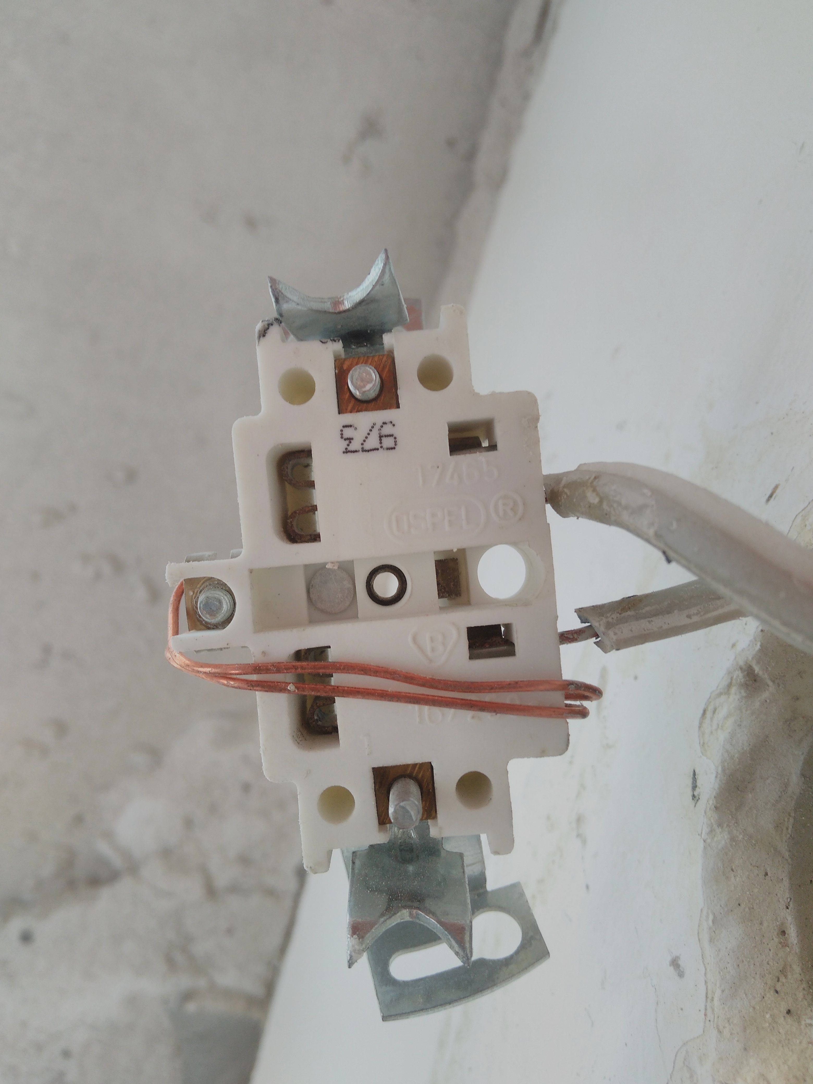

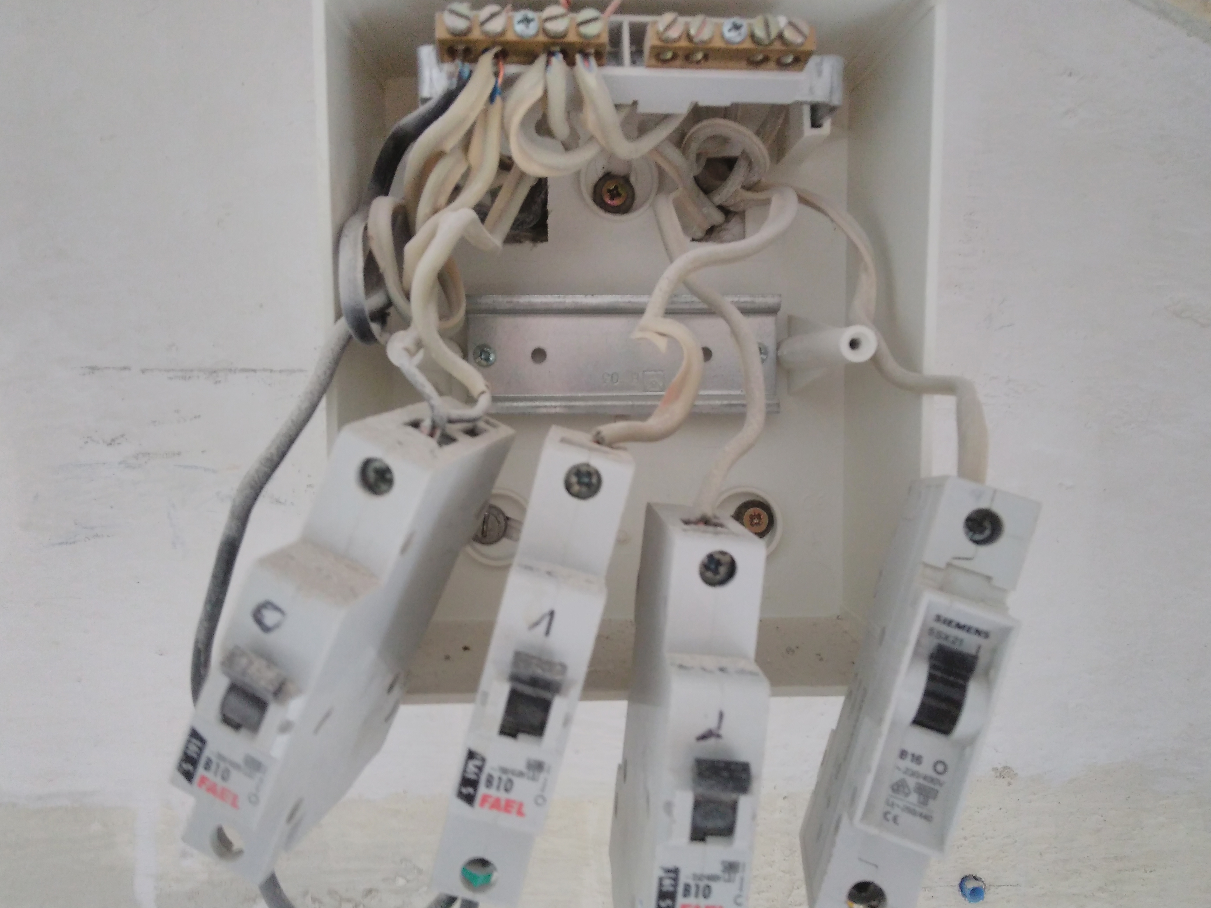

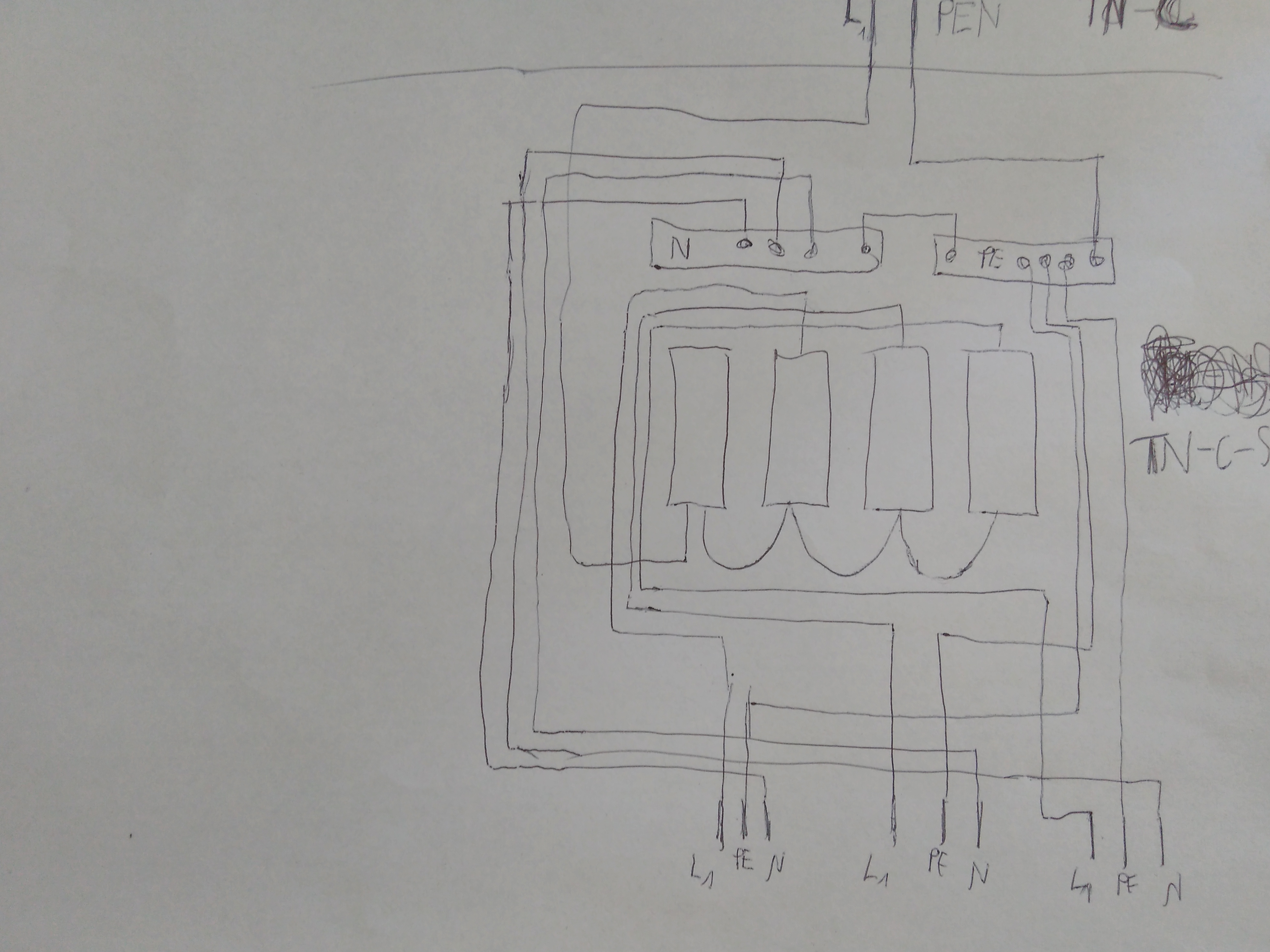

    Hello all.
    The renovation in the kitchen tempted me to replace the two-wire cables with three-wire cables. There is a lot of it on the forum but there is no clear answer because there are as many theories as "specialists".
    So, as in the subject, I have a TN-C layout in the apartment
    Converting TN-C Electrical Layout to TN-CS in 80s Apartment: Practicalities and Challenges
    and pseudo electric shock protection
    I would like to convert it into a TN-CS system although I know there are rules regarding the thickness of the PEN cable etc. but here I won't change anything. because I can play electrician only in my apartment and I need a staircase, except for the main fuse in the box.
    I came up with a system that for the first principle has to be protected first and then powered up. Is such a system can be accepted given that I do not have too many options.
    Thanks in advance for your help.
    best regards

    elsitko wrote:
    Since we protect first where is off RI. Obligatory because there is probably a bathroom with a bath or shower in the apartment. probably these are overcurrent breakers
    An error has crept in. It was about anti-shock :D I corrected the error. These protections are the bridge made in contact where I think it should be made differently. As for the photo of the fuse box, I put it in order to illustrate what we are dealing with. I will deal with the switchgear later. For now, I change installations only in the kitchen and that's it. The diagram I added is the idea of switching from one system to another.
    And here the question is whether such a connection / transition will fulfill its role.
    best regards
