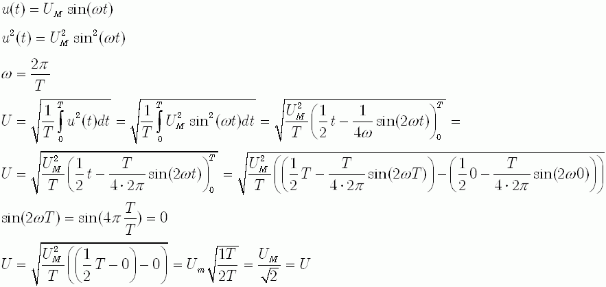

    $$I=\sqrt{\frac{1}{T}\int{i^2dt}}$$ integral in the interval [0, T]
    $$U=\sqrt{\frac{1}{T}\int{u^2dt}}$$ integral in the range [0, T], T = 2pi
    $$U=\sqrt{\frac{1}{T}\int{u^2dt}}=\sqrt{\frac{1}{T}\int{(U^M\sin(\omega t))^2dt}}$$
    The integral of the expression is equal to:
    $$\sqrt{\frac{1}{T}\int{(U^M\sin(\omega t))^2dt}}$$
    unfortunately I can not write it here too much work, the point is that for sine it should come out that Um = 1.41 U -> U = Um / first of (2)
    I'm gonna do it with some decent equation editor.
    here is the solution - how to calculate it (I had to do it in 2 minutes during the exam) for the current is the same, but it is different for non-solar waveforms.

    Thanks guys, both simple definitions and a derivation will come in handy. Regards
