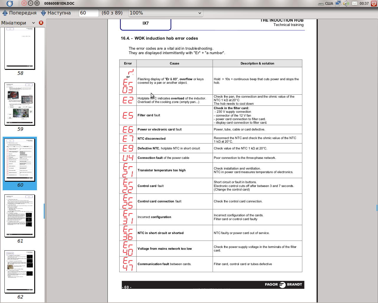

  • #4 9780517
    definitus
    Posts: 69
    Help: 18
    Rate: 77
    error list
    • Mastercook IDE64LS Induction Hob: Two Right Fields Stopped Working After Non-Use Екран.png (201.42 KB) You must be logged in to download this attachment.
  • #5 9780815
    jaro1972
    Posts: 46
    Rate: 21
    No error code is displayed!
