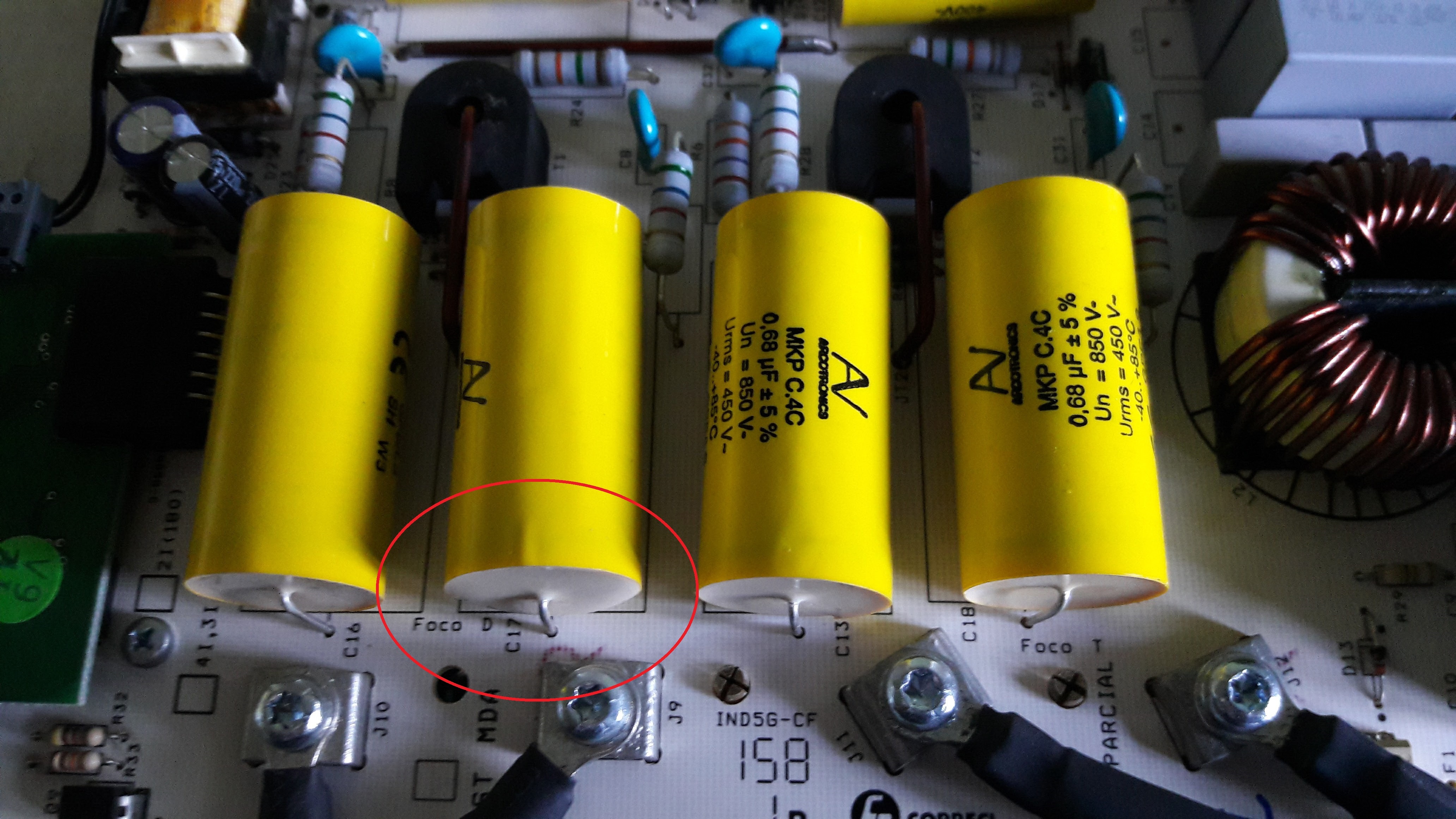

    I am asking for help, because I am already missing my shoemaking passion. The plate still on the warranty was probably 5 times repaired, but I got the impression that the service itself did not know what to do - replaced the cooking zones, sensor control, updated software (?), But regularly disc was throwing F7 or F8 in its left section or not detects the pot (de facto this plate is 2 in 1 - the left section is a separate 3 cooking zones, the right 2 fields). The right section has never been such a problem. Most often when I was thrown errors I turned off the power supply on the fuse and after switching it back on, it was possible to use it again as if nothing had happened.
    A few months ago another problem came up - the right section periodically "lost" the pots. So she warmed the heat, and after a while she stopped and blinked the digit as if there was no pot. I unscrewed the record and found that there was a white deposit on the fields. I blew the whole air and removed the dust and sediment. I turned the disc back and what's interesting since then, F7 and F8 errors do not appear in the left section at all. As far as the right side is concerned, nothing has changed, sometimes she did not detect the pots, until she finally stopped practically completely (occasionally she manages to attach something, but usually during cooking stops). I looked at a few topics here on the forum and I already thought I found a solution (an extended plate from the connector), unfortunately, after modifying the fixing pins and tightening the plate (I measured the meter that there is a transition) nothing has changed.
    Amica PBF5VI501FTB / PI8500TF Induction Hob - Recurring F7/F8 Errors and Pot Detection Issues
    My attention turned to MKP capacitors. Can anyone tell me whether it is organoleptically possible to determine whether they are functional? One looks bumpy, but is something really wrong with him, or is it possible that the adhesive applied in the production process? I understand that without desoldering and capacitance meter can not be reliably confirmed?
    Or maybe someone else knows some common faults and what could be checked / measured? Additional information - the right section NEVER dropped any error.

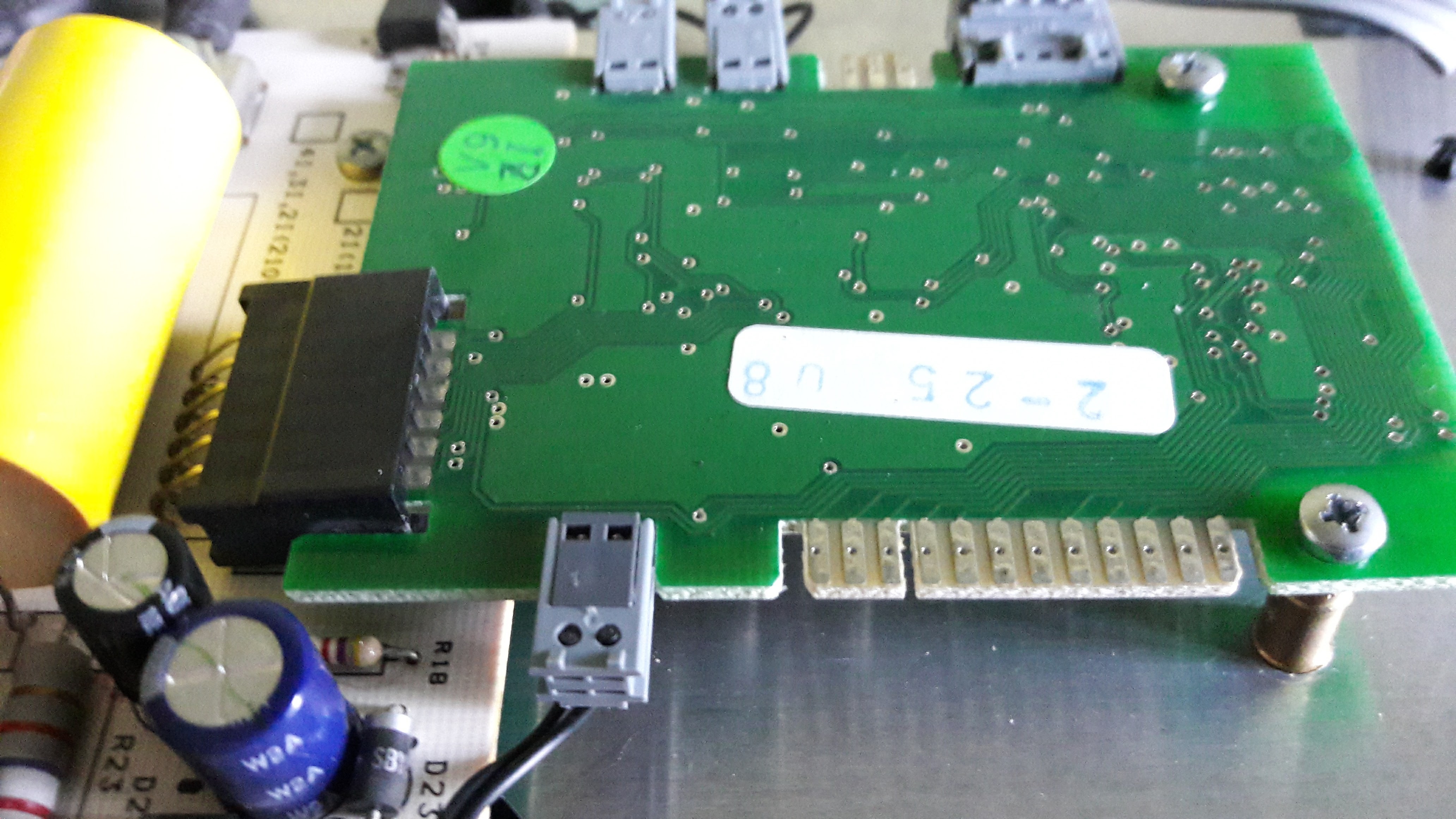

    Not detecting pots is often the fault of the software tile. About PLN 350-450. But you need to know which one to buy or what to replace on the module.

    The software board is the green one in the picture?

    MARCIN.SLASK wrote:
    Not detecting pots is often the fault of the software board. About PLN 350-450. But you need to know which one to buy or what to replace on the module.
    Any hint what to look for? And what about that kondzor?
    And one more thing - as I said after all, this record is 2 in 1. So there is the second such tile in the left part. Is it for testing purposes (checking if the problem is in the software board) I could replace them and say on level "1" check whether the pots are detected, or because of the different amount of fields and other powers I can not?
    Can selective detection not only on 1 of the fields of a given section also be the fault of the software board?

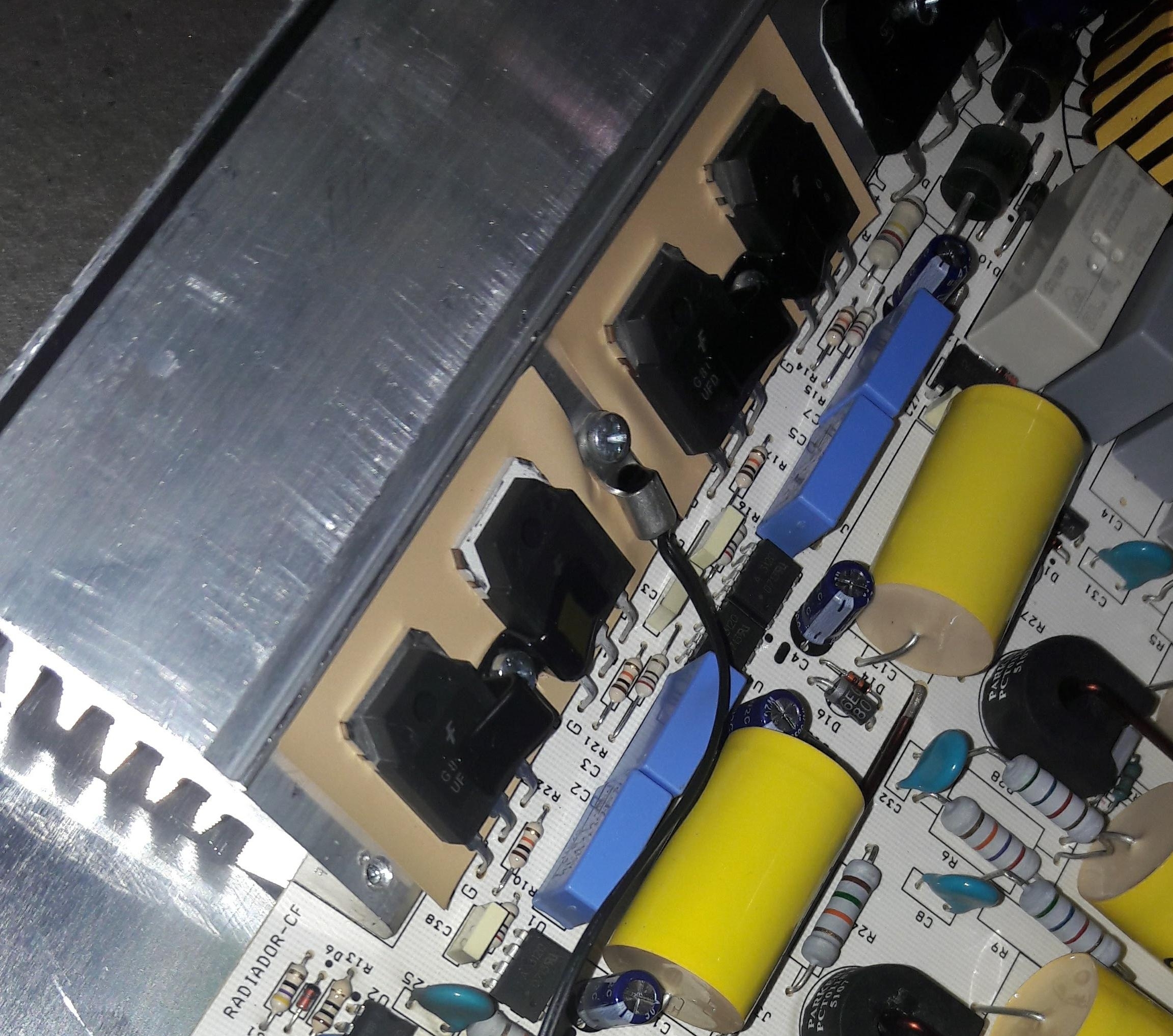

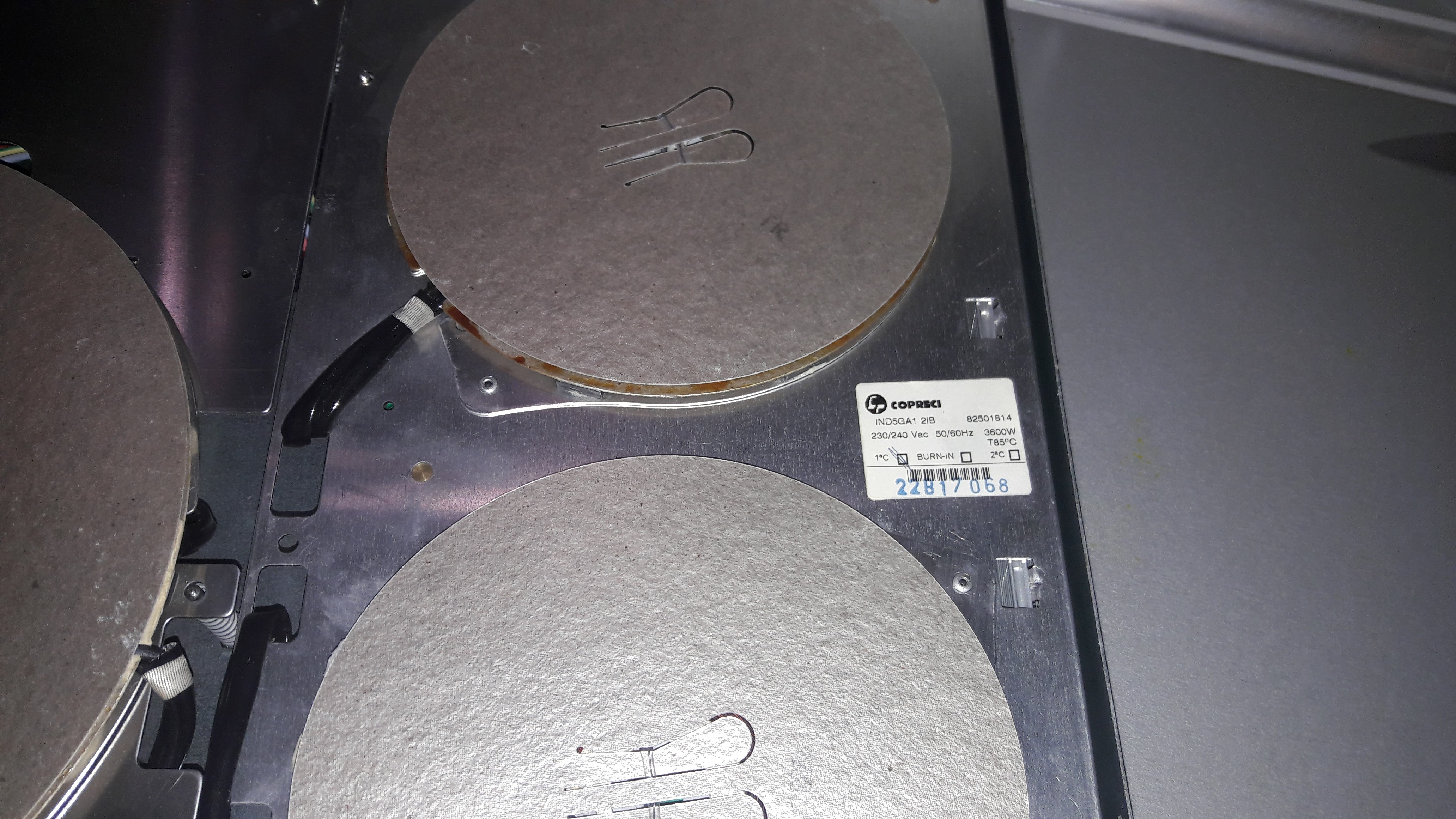

    The disc is in constant use, the module inserted, but I have some photos that I made earlier.
    When it comes to transistors, you mean what are on the heat sink?

    Yes, it's about the 4pcs grouped 2pcs on the heat sink. What is the symbol?
  • #9 16230359
    Pawel1812
    Level 26  
    Posts: 1491
    Help: 44
    Rate: 267
    The SGH80N60UFDTU transistors have long been withdrawn from production.

    For posterity - the problem has been solved a long time ago, but I wanted to write what helped. Replacing the software board did the trick - as mentioned before @ MARCIN.SLASK . Answering your own question asked earlier - you can not exchange software tiles with you, I did a test and crashes F9.
