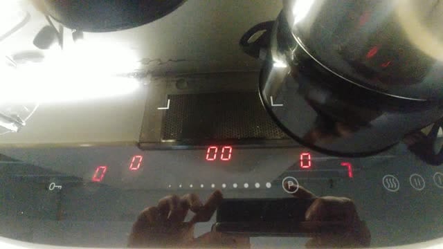

    Good morning,
    when you try to use the induction hob (Amica PI 6544 STK) after a few seconds it turns off and all buttons / display fields light up. The problem occurs in all fields of the hob, regardless of the location on which the pan is placed and regardless of the type of pan. The plate has been specially wiped to eliminate any sensor contamination. Details in the attached video. If anyone had similar symptoms, I would be grateful for advice on what could be the cause and what should I do. Thank you in advance for your help.

    The fan is broken.
    And that's about it.
    The fan itself is not available as a spare part in this cradle. The entire module 8065304 should be purchased for PLN 602 zeta gross.

    przemopg wrote:
    Thanks, as I wrote before (maybe not fully understandable) in my case only a reboot was enough, but thanks for your good intentions. We'll see how much more it comes from ;)
    What the video shows is the quintessence of what I wrote above.
    The length of the film is too short, it does not make it 100% accurate.
    Resetting the device in the video ( not to be confused with restart - manual disconnection from the power supply ) occurs when the fan is to be switched on.
    One time it happened that replacing the fan did not help. In all other cases, yes.
    It is one thing to replace the fan, as in this case, and another to replace the module when the device does not work.
    It's hard to describe in words.
    But sooner or later the problem will come back (probably sooner)
