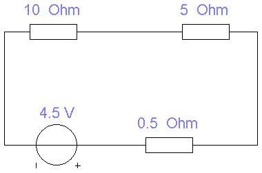

    how to calculate the power dissipated in the 10Ω resistor in this circuit?
    • Task - Power on 10Ω Resistor: Calculating Power Dissipation in a Circuit zadanie.GIF (2.78 KB) You must be logged in to download this attachment.

    If my memory serves me right, the power counts P=I^2*R, so first you have to calculate the current flowing in the circuit using the formula I=U/R,
    we have 4.5V/(10+5+0.5) or 0.65A, then P=0.65*0.65*10= 4.225W

    you cut it!
    current=0.29A
    Power dissipated = 0.84W
    The formulas are correct
    or otherwise
    Knowing the current in the circuit = 0.29A
    Calculate the voltage drop across the resistor according to the formula: U=I x R
    0.29x10 ohms=2.90V
    Calculate the power dissipated on the resistor according to the formula: P=U squared /R
    2.90*2.90/10 = 0.84W

    Right, eh, it's not time anymore, you have to go to sleep....
    Thanks for helping out :)
