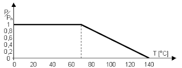

  • #20 18885605
  • #21 18885703
    CYRUS2
    Posts: 18038
    Help: 1241
    Rate: 3535
    Resistor power.
    This is not a direct link to the destruction of the resistor.
    Determining Resistor Wattage: Identify Watt Rating by Resistance, Tolerance & Size Factors
    This is the power curve of the resistor.
    The resistor is able to discharge the rated power at an ambient temperature of max 70 ° C.
    At higher temperatures, the power of the resistor decreases.
