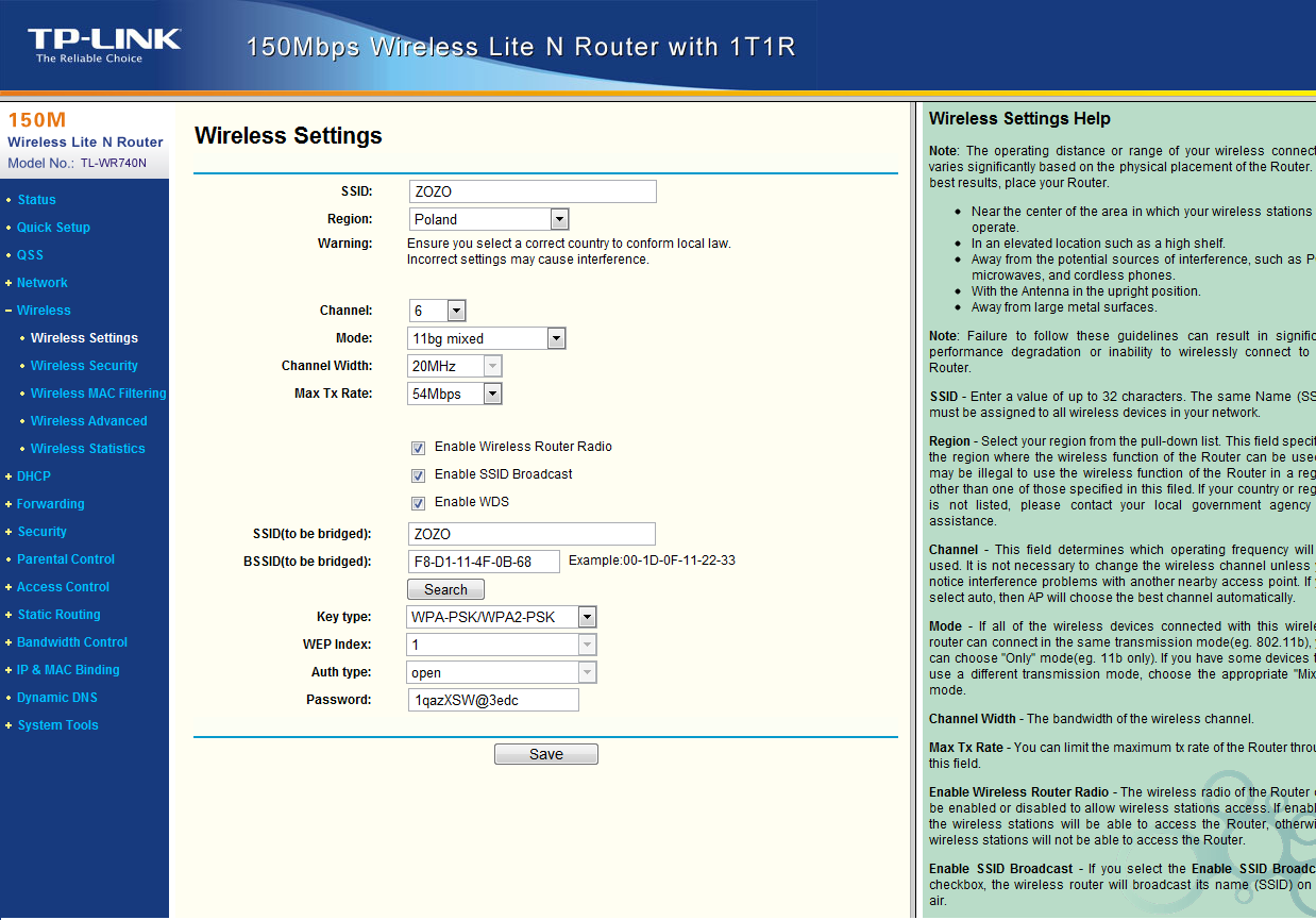

  • #10 10860547
    k2.juras
    Level 19  
    Posts: 276
    Help: 33
    Rate: 32
    Well, how to say :)
    I checked enable wds, entered what I needed, clicked the button (save ... something), a subpage opened like in access with the name of the network, channel, etc., I clicked connect and after returning to enable wds I entered the password and it works.
    Though it probably shouldn't.
    Forgive the somewhat chaotic description, but I don't know much about it, nor do I have a very good visual rock memory.
    Thank you for your help and best regards

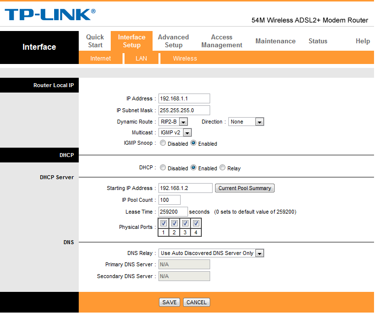

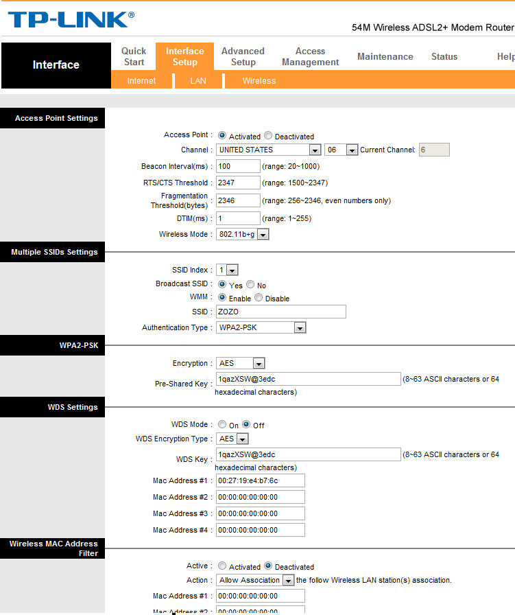

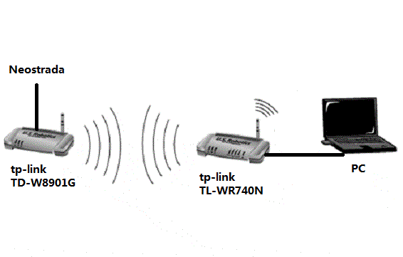

  • Request for TD-W8901G wireless bridge setup
    #13 11138999
    Danon269
    Posts: 6
    Hello, I want to connect these two routers TP-link TD-8901G and TP-Link TL-WR740N.
    I've been struggling with this for half a day now and nothing seems to work. I'm doing what it says in various guides, but something doesn't work. I want to do this because I have a computer on the first floor and a router with Internet access is downstairs and I don't really like running a cable through half the house.
    It should look like the picture below:

  • #14 11139614
    jimasek
    Posts: 35287
    Help: 3783
    Rate: 2681
    Also enable WDS on W8910g - link .

    jimasek
    Posts: 35287
    Help: 3783
    Rate: 2681
    Do you have the physical addresses correctly entered alternately in the devices? Have you tried setting the wr740N radio to a slower speed? Have you checked if the devices are responding to the ping?
    You also have the manufacturer's FAQ here link .

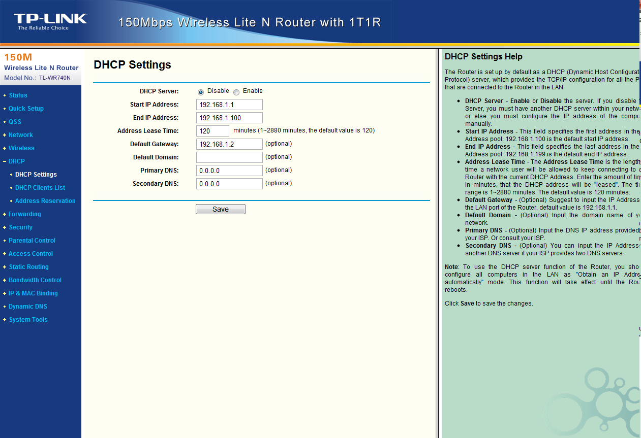

  • #24 11202068
    Madomir
    Posts: 22
    Hey, same question but different hardware. I like the cable connection.
    The router connected to the PC and the tp cable is netgear DNG1000 and the other one I have is the tp-link tl-wr340g.
  • #25 11202112
    jimasek
    Posts: 35287
    Help: 3783
    Rate: 2681
    Madomir wrote:
    and the second one that I have at my disposal is the tp-link tl-wr340g.
    Connect to one of the LAN ports (empty WAN) and disable DHCP on the other router.

    Madomir
    Posts: 22
    I connected. It looks ok but there is a problem. From the router, tp-link detects wi-fi with "excellent" signal quality, but you can not connect to any website. Broken router? Is it a bad configuration?
    Added after 3 [minutes]:
    Trying to connect via smartphone. Initially, I thought that it does not get along with android, but I see that it is on the list of routers compatible with android.
  • #28 11218450
    jimasek
    Posts: 35287
    Help: 3783
    Rate: 2681
    Add DNS by hand to the network card in your computer, then check if you have full access to the Internet.
  • #29 11220872
    Madomir
    Posts: 22
    Thanks helped. Problem solved.
