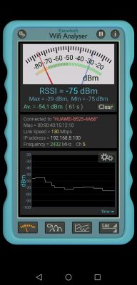

    I checked the signal strength in the room where the router is to be. It came out -75dBm. I understand that this is a poor result. I am only surprised that at the router itself I only have - 29dBm. Picture below
    The lower the value, the stronger the signal and the higher the weaker.
    It can be difficult to get a stable link.
