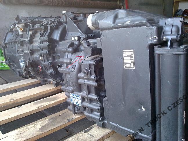

    Is it the valve marked in the picture?
    Man TGA 26.460 (2001): Error 04009-10, RET S DIAGNOSIS - Fault Identification & Removal Guide
    After switching on when it wants to decrease or increase the strength, nothing happens. The Intarder brakes with the same force.

    in the first post I wrote that it is on the left side of the intarder and this photo is taken from the right side

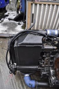

    Problem solved.
    For posterity the valve marked in the picture. Metal and plastic. In the middle there are two thin wires and the connection between the plastic and the metal is worn.
    The valve cannot be dismantled. Exchange only

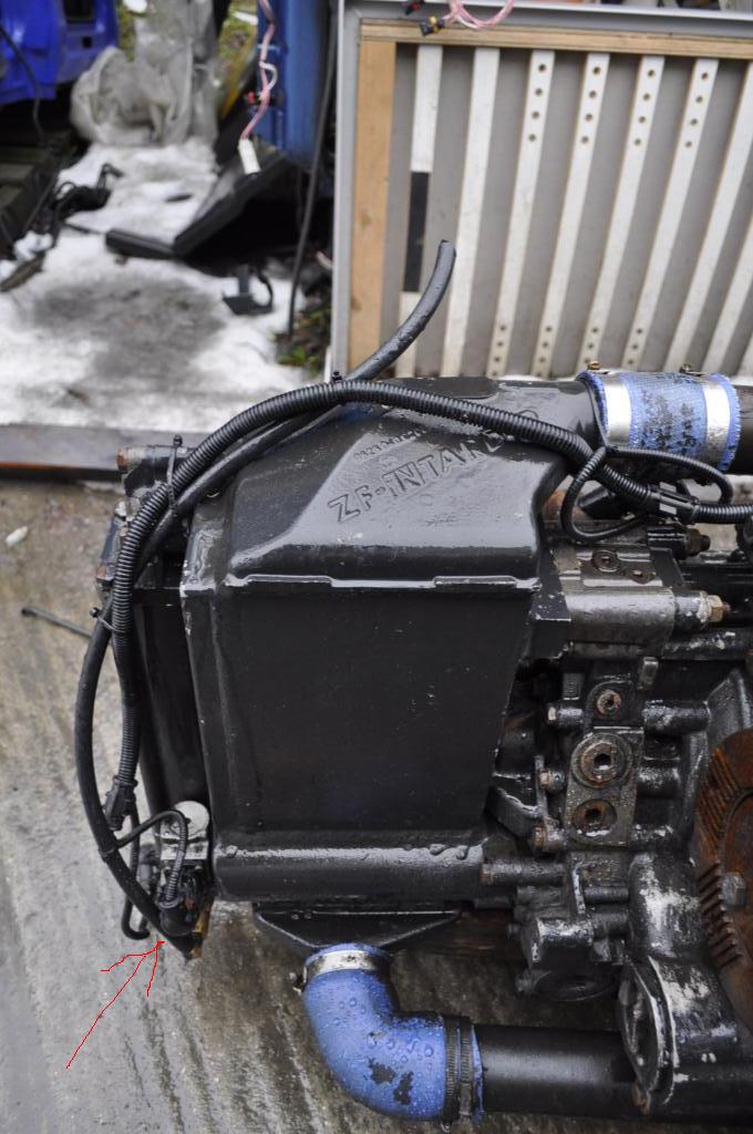

    I will add that the valve costs PLN 800. After the inspection, I decided to try to disassemble it and fix it. It turned out that if you want, you can. It is enough to gently press the metal body which is made of a thin sheet and solder two wires to the electromagnet.
    And this is how eight hundred for pleasure are left.
