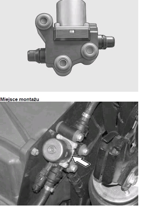

    On the vehicle frame, under the aluminum platform.
    • MAN TGX 18.440 - GDK / PDF 05018-13 - Fault transition from passive to active k zawór ogrzewania.jpg (71.58 KB) You must be logged in to download this attachment.

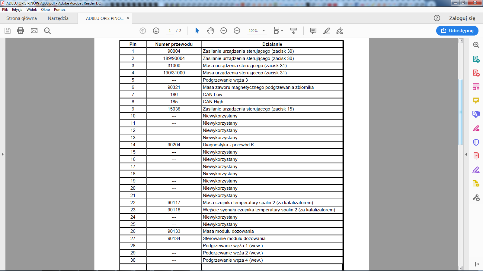

  • #9 18038512
    stanisławpiotr
    Posts: 1555
    Help: 211
    Rate: 832

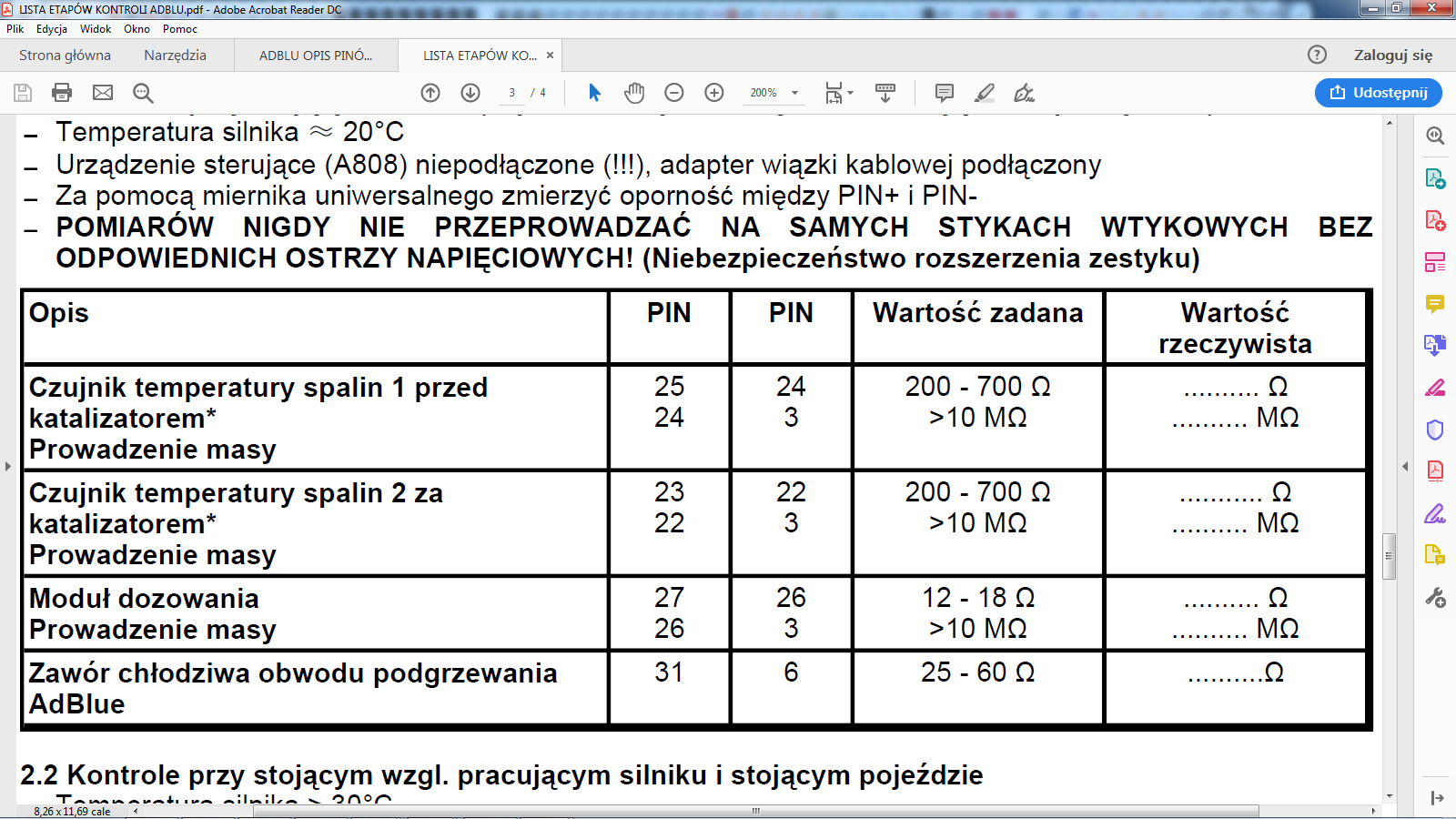

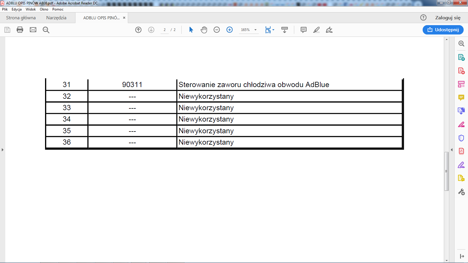

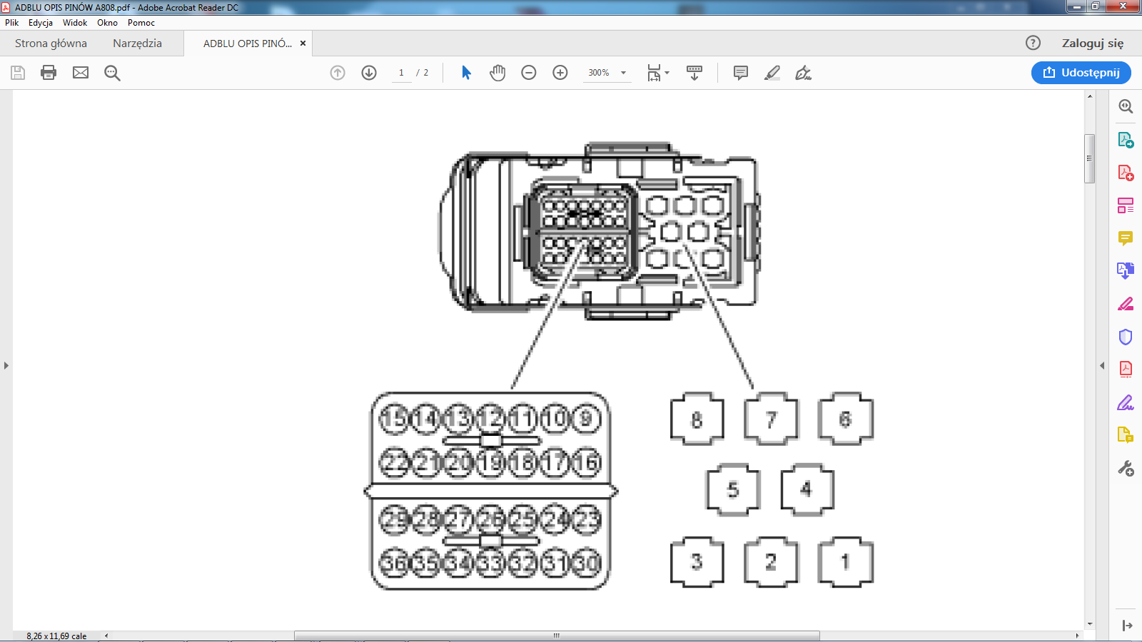

    Pin description.
    • MAN TGX 18.440 - GDK / PDF 05018-13 - Fault transition from passive to active k pomiar.png (200.06 KB) You must be logged in to download this attachment.
    • MAN TGX 18.440 - GDK / PDF 05018-13 - Fault transition from passive to active k złącze.png (155.68 KB) You must be logged in to download this attachment.
    • MAN TGX 18.440 - GDK / PDF 05018-13 - Fault transition from passive to active k złącze opis.png (168.46 KB) You must be logged in to download this attachment.
    • MAN TGX 18.440 - GDK / PDF 05018-13 - Fault transition from passive to active k złącze opis2.png (95.34 KB) You must be logged in to download this attachment.

    Well, the valve is 34ohm, so it works.
    The current in the block reaching the valve is 21.4V

  • #20 18044029
    stanisławpiotr
    Posts: 1555
    Help: 211
    Rate: 832
    Pin 26 wire 90133 with pin 27 wire 90134.

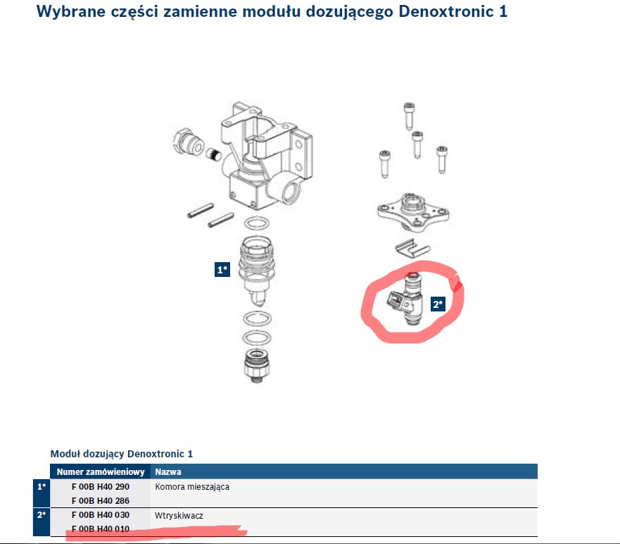

    • MAN TGX 18.440 - GDK / PDF 05018-13 - Fault transition from passive to active k moduł dozowania.jpg (128.19 KB) You must be logged in to download this attachment.

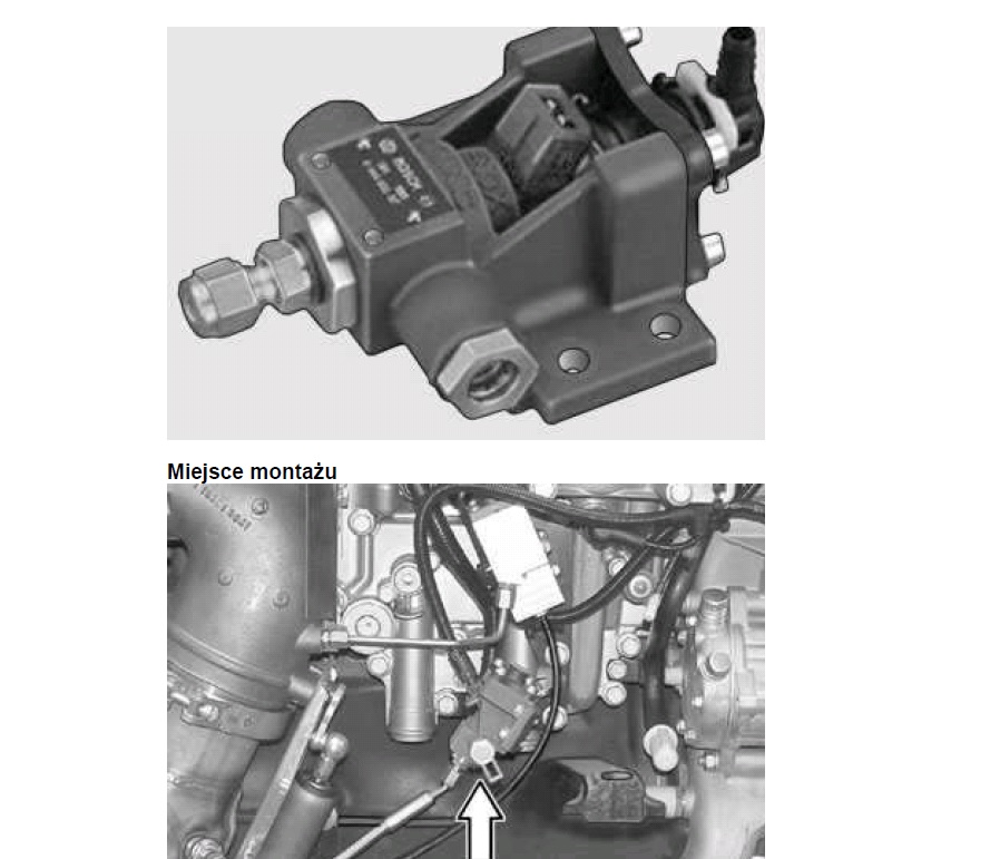

    - dispenser or pump? because so far I thought that we have a pump in the module and an injection that is located at the exhaust?
    Your version is Euro 5, because Euro 6 has Emitec and Bosch and each of them is a different system ... but to the point, this "can" behind the cabin is a pump module with a pump, sensors, filters, etc. and it sends adblue under pressure to the "dosing module, colloquially a dispenser which is an electrically controlled valve from which the adblue goes to the nozzle (not to be confused with the injector because the injector is Euro 6 Bosch)
    Your problem is the dosing module, i.e. the dispenser, it is exactly the element that is in the pictures at your colleague above and as he gave you to check, you have the wires from him that go to the pump module, it is possible that they are worn or shorted, it is also possible that the dispenser itself is damaged.

  • #25 18059840
    stanisławpiotr
    Posts: 1555
    Help: 211
    Rate: 832

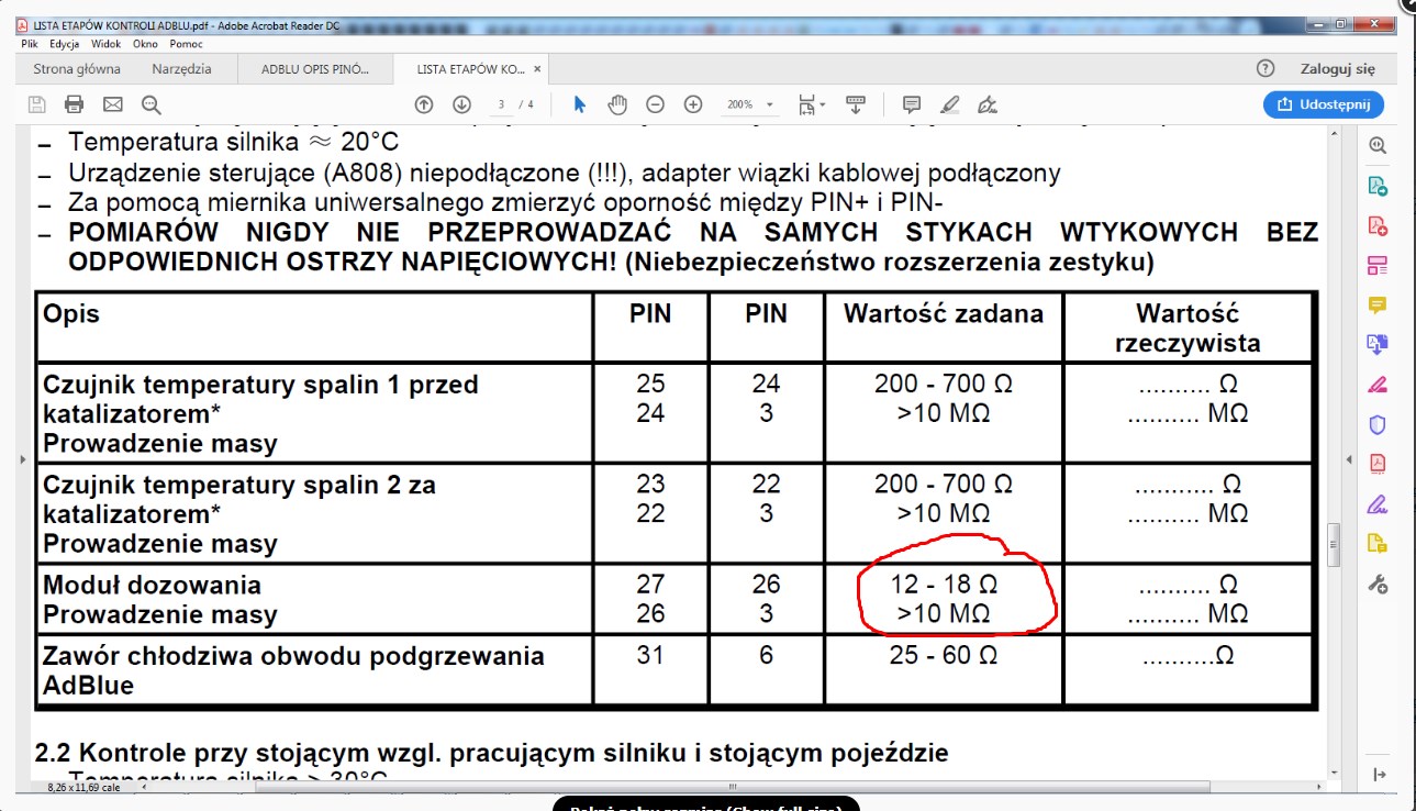

    You have everything in the documentation included, so why are you asking?
    The colleague above is mistaken with this voltage, you can burn the valve coil. This coil is controlled by the PWN signal.
    • MAN TGX 18.440 - GDK / PDF 05018-13 - Fault transition from passive to active k moduł.jpg (237.2 KB) You must be logged in to download this attachment.
  • #26 18060172
    That's right, everything is included in your attachment, I only looked after writing the post.
    So there is nothing left for me to replace the dispenser. however, before I buy it, I'll swap it from a different mana and make sure it's it and let you know :)
    #27 18060441
    stanisławpiotr
    Posts: 1555
    Help: 211
    Rate: 832
    You can replace the valve itself, it will be cheaper. Ask at INTERCARS.
    • MAN TGX 18.440 - GDK / PDF 05018-13 - Fault transition from passive to active k zawór dozowania.jpg (65.13 KB) You must be logged in to download this attachment.

    #28 18063304
    Fast_international
    Posts: 169
    Help: 6
    Rate: 87
    And the problem is solved :)
    The cause of this error and inoperability of the system was a damaged dosing valve / injection, which can be seen in the attached photo by a colleague above :)
    In my case, the voltage on the harness was 8.8V, while the resistance of the valve / injection itself was 0 ohms and the resistance on the new injection was 14ohm. After replacing, the GDK / PDF 05018-13 error became passive immediately and the pump started after the car was started again.
    I can only confirm what my colleague suggested above, it makes no sense to buy the entire dispensing module, especially since it is an element that can be dismantled and cleaned (I did it in February). The valve itself costs about PLN 500 gross, and the module is about PLN 1000 gross.
    When replacing it, I suggest rinsing the module with hot water after removing the injector, especially since the system does not work for a long time, a small crystal is made in the module itself, so it is worth rinsing :)
    Thanks to everyone for your help :)
