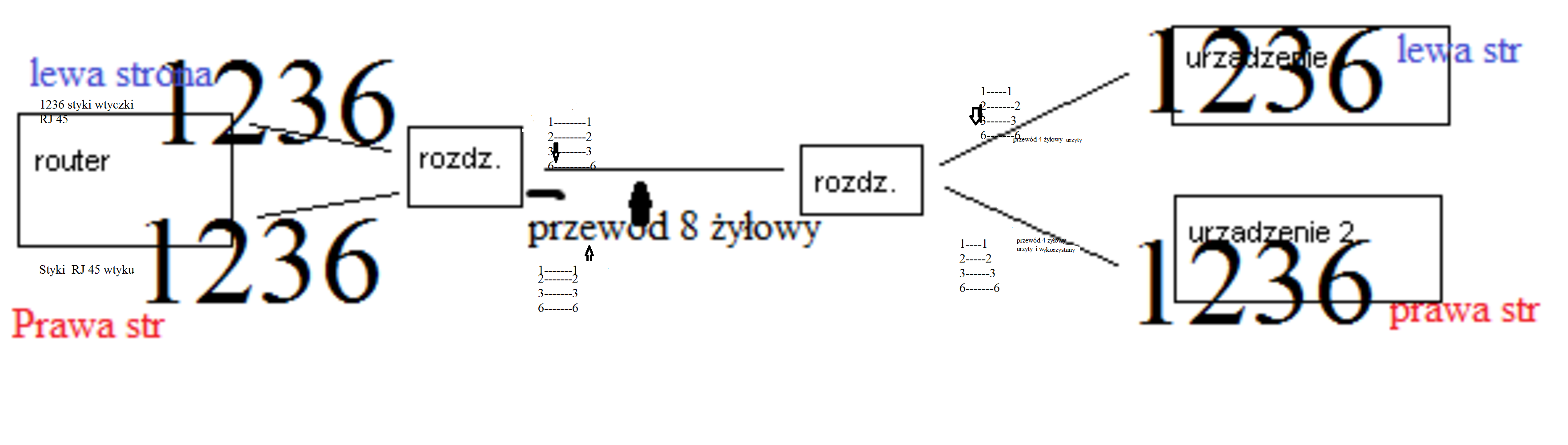

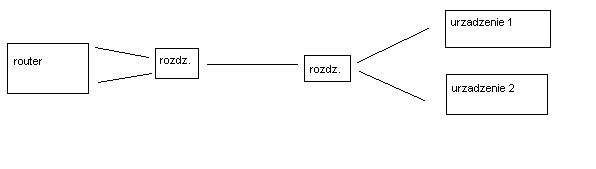

    Hello. The situation looks like this. I have 2 devices in my living room that I want to connect to the network - a computer and a console. The problem is as follows - I only have 1 cable pulled. At the moment, pulling a second one is the last resort for many reasons.
    Will such a trick work: splitter + connector on the cable in the living room, and then from this splitter cables to the console and to the PC?
    http://www.multisort.pl/product/Rozgaleznik-gyszneo-RJ45-2-x-gźdzo-RJ45,2970.html
    http://www.multisort.pl/product/Przejscie-gyszneo-RJ45-g Gniazdoo-RJ45-do-ISDN,2967.html?mn_cl=1
    I note that only 1 of the devices is running at a time. I have the option to set their IP rigidly if it has any importance.

    If the network is 100 Mbit / s, you buy such splitters, connect at the beginning and at the end of the cable (of course, after separation you need 2 ports in the switch) and it will be ok.
    If it's 1 Gbit / s, forget it. I need all 8 cores.

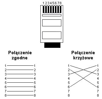

    See here http://www.sieci-lan.pl/kros.php3 I do not know if you have a Rj 45 adapter if you have it, you can do a wire, it is known that contacts 1,2,3,6 are used in Rj45 and contacts 4, 5,7,8 are not used, I did the test, I pierced the cable and used the 1,2,3,6 contacts and I had the internet on the computer, so with the 4,5,7,8 contacts I only fitted the next plugs as 1,2,3 contacts 6 and on the 8-core cable I had 2 RJ 45 plugs on one end and 2 Rj 45 plugs on the other and this way I could connect 2 computers, e.g. with one cable
    Using an RJ45 Splitter for Connecting a Computer and Console with a Single Cable: Pros and Cons

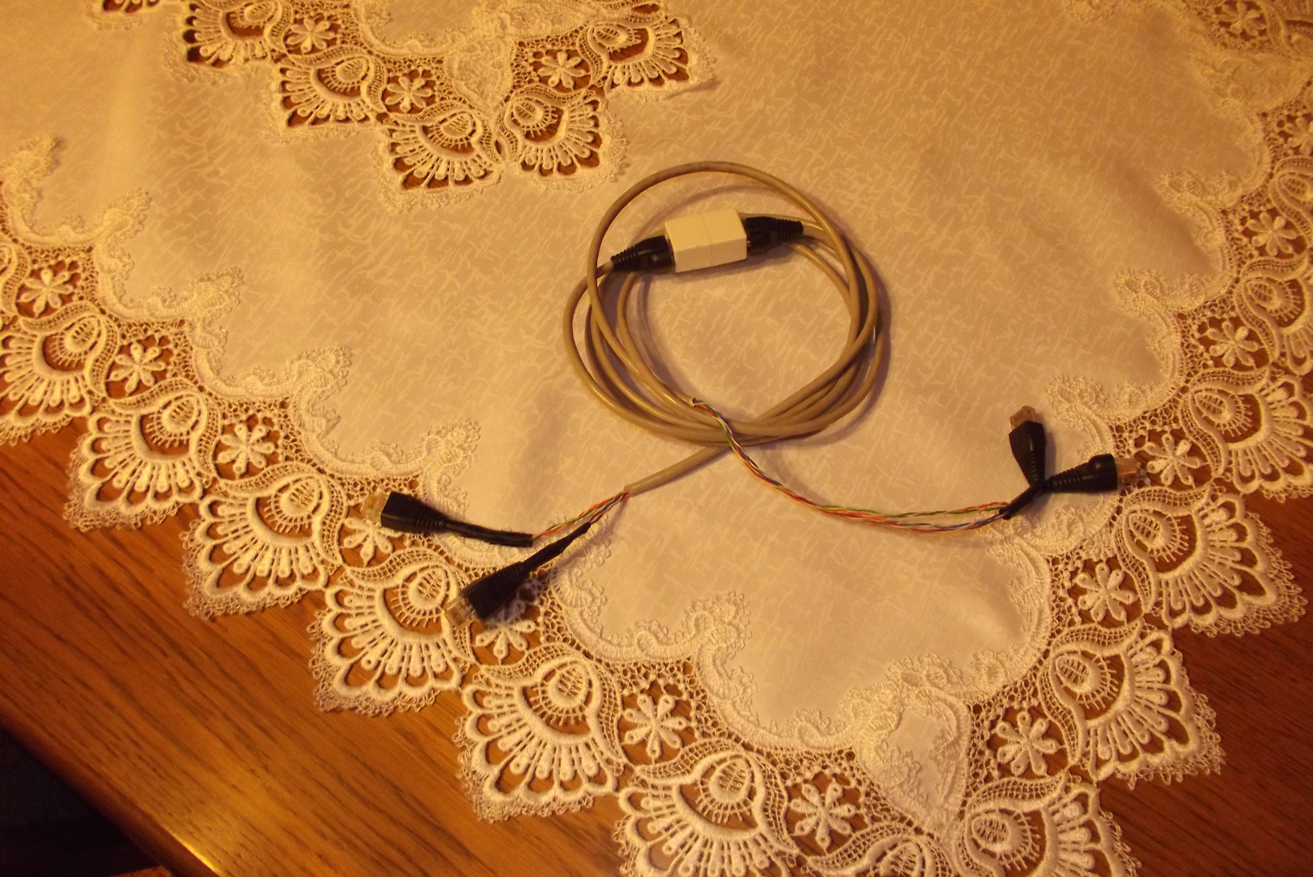

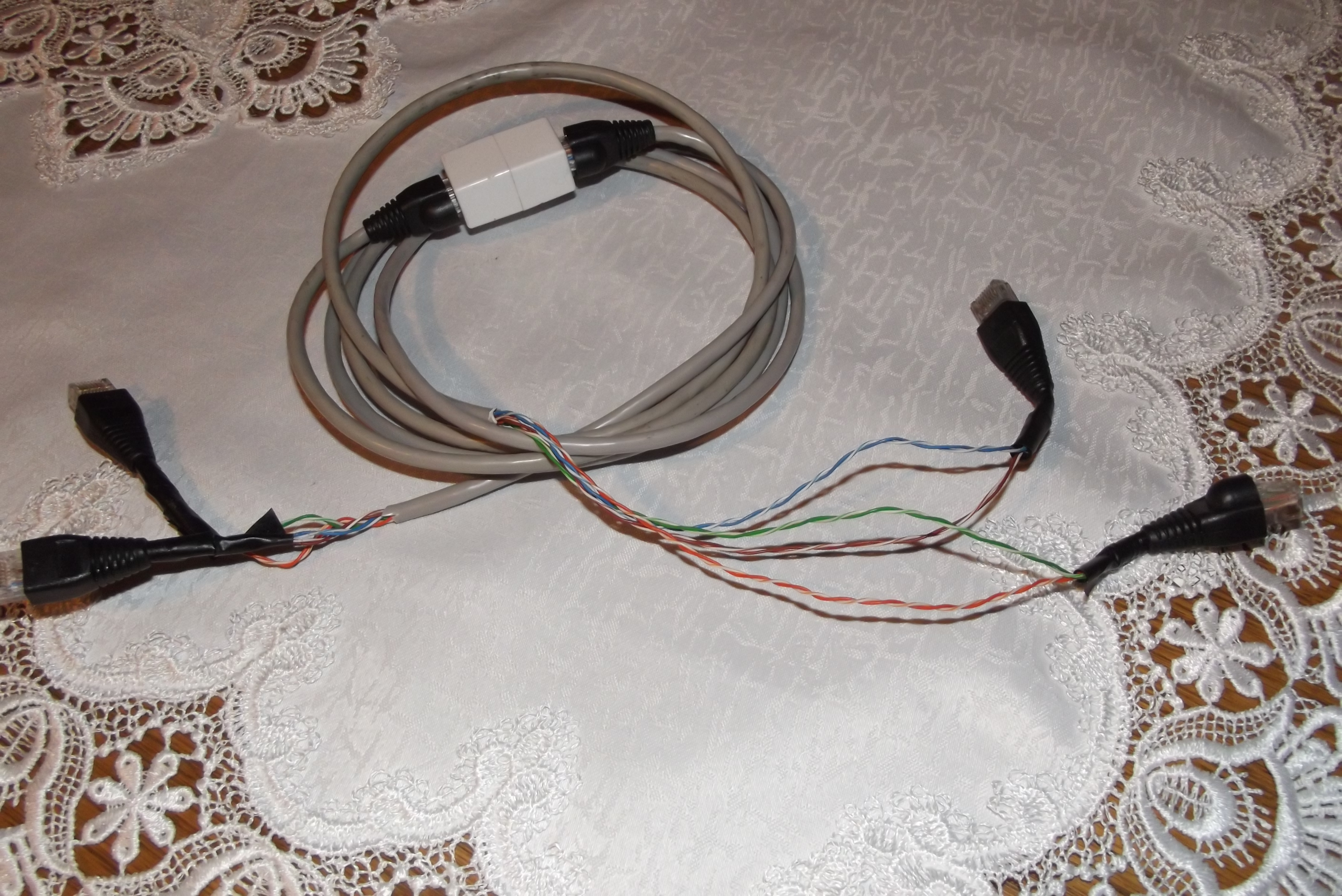

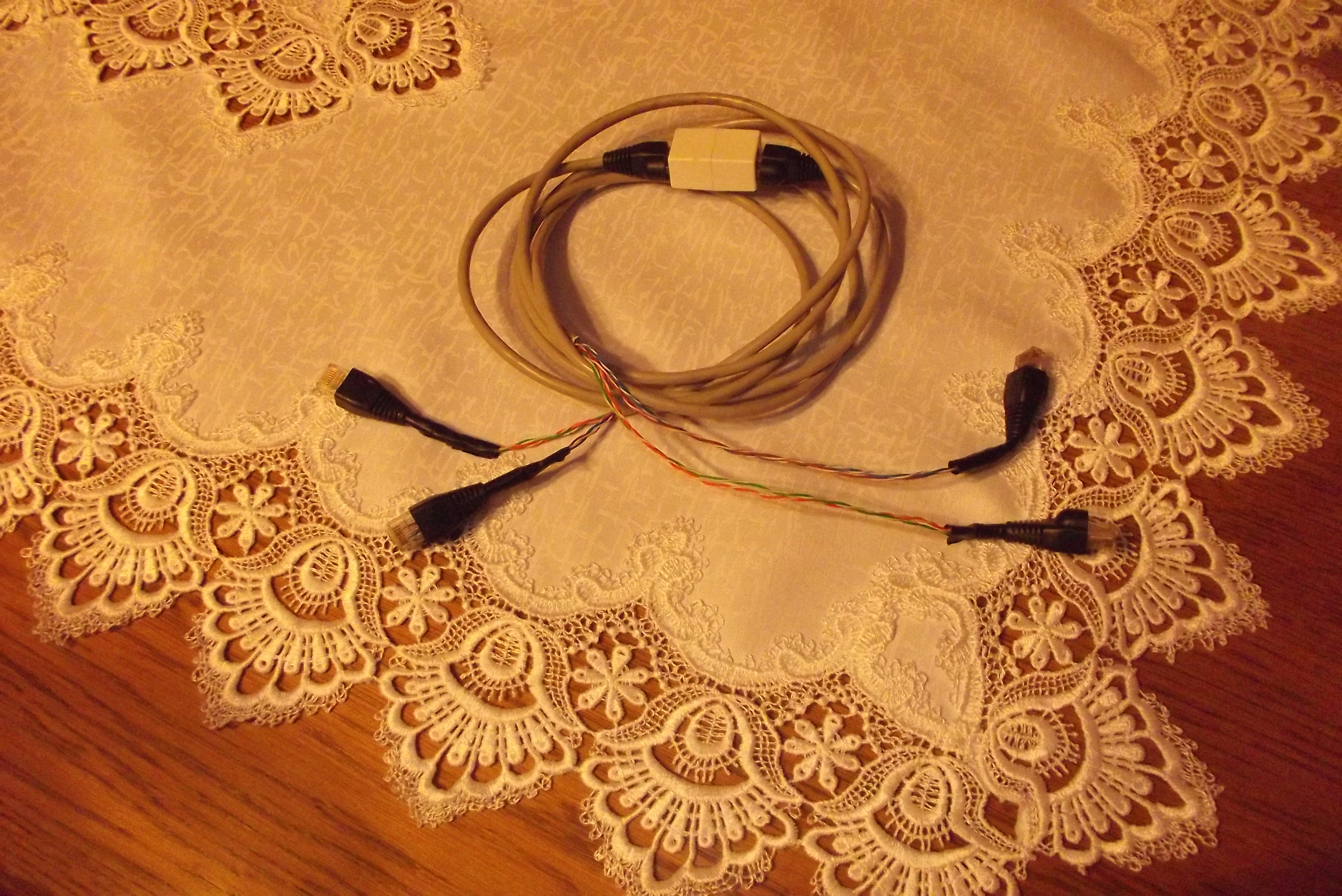

    Hello, after a long break. In the meantime, I detected a fault with one cable that disturbed my entire installation :) The cable is properly wired, but it still does not work as it should.
    The LEDs on the router are lit, but the connection is not as good as pinging. All cables are straight, not scratched. What else could be wrong here?
    straight cables, not scratched. What else could be wrong here?
    Yes you have connected as in the picture.
