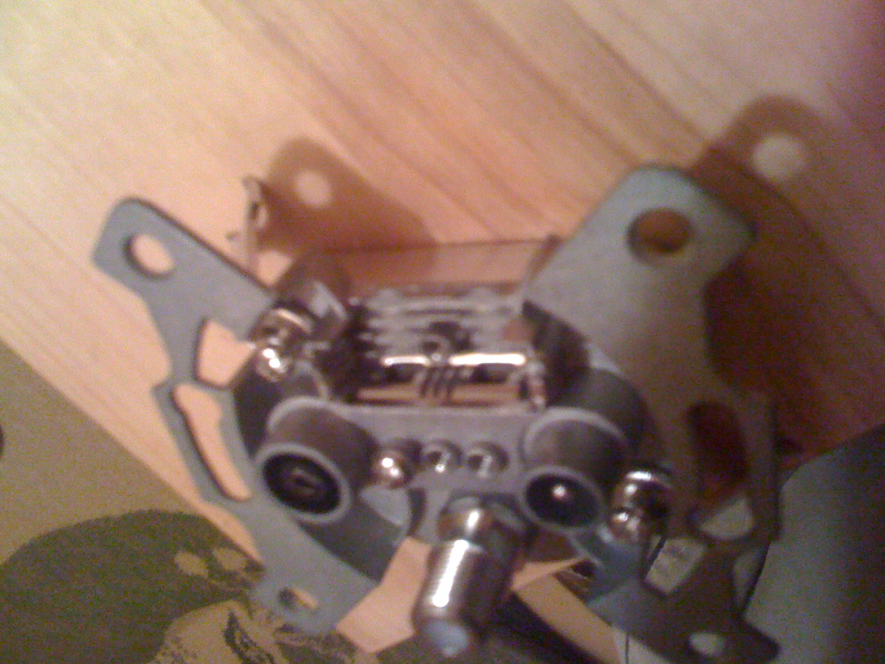

    And one more thing, I have 2 coax cables connected to one box - one from the sat, the other from the cable. I wanted to connect it to such a universal SAT-RTV-RJ45 socket. I dismantled this socket and I see that there are inputs for 2 coax cables inside, but only one has a screw from the top fixing the cable inserted into the hole. And so it came over me or cramps, is it not a socket for connecting only one cable, in which the signals from the ordinary and sat antenna are summed up? And the third question: the RJ45 input is only connected to 4 wires, does this mean that I will not recommend 1GBit after that? Here is the socket:

  • #10 8999074
    hermes-80
    Posts: 12014
    Help: 1177
    Rate: 743
    And this is just a plug or a tool I need?
    Look for a knife called krone at auctions
    the RJ45 input only has a 4-wire connection, does this mean that I will not recommend 1GBit after that?
    And this is sometimes not a telephone socket with an RJ-11 plug ??
    If it only has 4 inputs then it is impossible to run 1Gb / s because this standard uses 8 wires.
