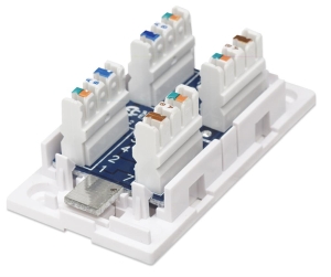

    You actually have two options
    - RJ45 barrel -
    Connecting network cables - Does connecting cables affect the quality of the lin
    - RJ45 cable connector - present in plastic or metal housings
    I used to solder a cable or "eton" connector but this is the extreme when you don't have another solution at hand.

    As soon as 5 pieces you can use UY1 or UY2 quick connectors, place all cable connectors, e.g. in a cable box.
