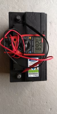

    Today I charge it for 8h 16V 1A, and leave the clamps disconnected until the morning. If it is more than 12.08V I will start looking for a thief.
    It does not show any errors, I connected STN1170 ELMv3 under Forscan
    I am looking for a different or a new battery, I found a stimulant at the Moll OEM 80ah auction, I wonder if I would buy it if it was 2 years old.
    Now all these EXIDE, BOSCH are garbage ...
    https://rover.ebay.com/rover/0/0/0?mpre=https...F%2Fwww.ebay.co.uk%2Fulk%2Fitm%2F173912639276

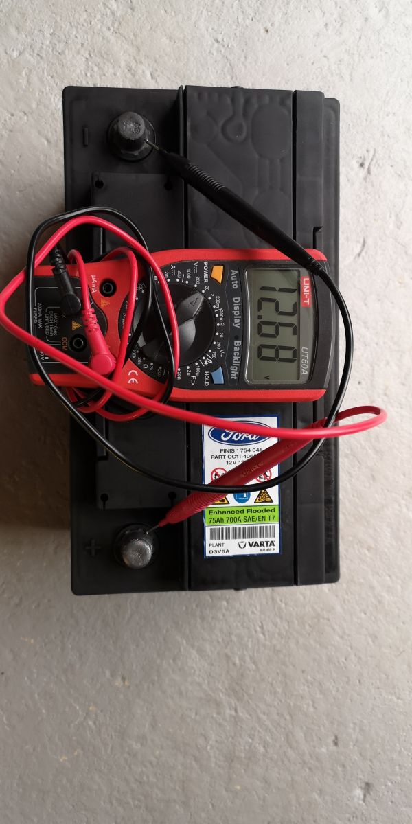

    I kept it under the power supply for 8h, the parameters were constant:
    15.84V, 0.99A, CC mode
    In the morning I connected the clamps. Still, the voltage dropped to 12.08V overnight and to 9.83V when firing up.
    So it's bad with him and qualifies for replacement?

    I had such a battery in a Focus from 2011, I drove a lot, but after 7 years of use and driving 155,000 in the car. Km. He fell. He had the same symptoms as yours, I've tried everything.
    Ultimately, not salvageable. He fell.
    I had to buy a new one, you can check if it died by connecting the eobd cube and checking the battery charging reading, as it charges it all the time with about 15V, the battery has already expired. After changing the battery, you still have to reset the system. It is a combination of turn signals etc. Then the computer will know that you have replaced the battery and will start charging it and discharging it will voltage from 12v per piece to 14.8v. Depending on whether you are braking or accelerating etc.

    Yes, after plugging in the computer, the charging was usually above 15V.
    I exchanged it for a new Exide.
    I also did the BMS reset, as you wrote, I could do it with a computer, but the combination of light switches also works.
    In general, this charging system irritates me because it keeps the battery at the level of 12.2 - 12.4V, which means it leaves a reserve for recharging during engine braking, but no matter how long I drive, it was never fully charged.
    But I have already resigned myself to it, I will simply recharge it with a power supply 2x for a year :)

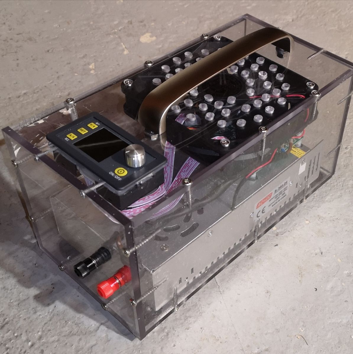

    I also made a plexiglass housing for the DPS5020 power supply.
    For the test, I connected it to this old battery at 16.25V, 0.5A, CC mode.
    After a week, the battery seems to have repaired itself because it already has a voltage of 12.6V and does not drop.
