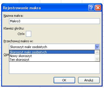

    marek003 wrote:
    But why did they sign up there (in PERSONAL.XLSB)? Until the end, I do not know all the "games" of excel 2007 and higher, but I already had something similar somewhere.
    I already know (it's not a version issue - but I've never used it so this ignorance)
    The case concerns "saving recorded macros and the option of where to store the macro.
    You probably have "Personal Macro Workbook selected."
    Excel Macros: Unable to Activate, Stuck in Design Mode (Developer Tab)
    And then the macros are just saved to personal.XLSB (This kind of secures Excel against the "horror" of macros)
    There are advantages and disadvantages of such a solution (I prefer to save macros in the workbook in the old way, and if macros are to be available for other workbooks, this is what the xla (xlam) "extension" is for.
    Because this is how you have to move the personal.xlsb file together with a given workbook, but this file can contain "thousands" of previous macros (recorded for other workbooks) so why transfer it all to another computer - there may also be a different one there ( with other macros) the same file.
    As for me, a bit of a sick solution ... but everyone has their own style of work.
    Copy the macros in the VBA editor from presonal to the module in the main workbook and it will be ok.

    #25 10698011
    marek003
    Level 40  
    Posts: 4607
    Help: 801
    Rate: 487
    Open the file on the computer it is running on.
    When it opens press Alt + F11
    If you don't see the project explorer window on the right side, press Ctrl + R
    Find there VBAproject (personal.xlsb)
    Press the plus next to it (the project will unfold)
    Open the "modules" folder
    "grab with the mouse" the module with your macros and drag it onto your file project [ VBAproject (your_file.xls) ] (no matter where - to within your project.
    A given module will be created (copied) in your file.
    Your macros can be in several modules, but they can also be in one - I have no idea how you are organized when I can't see it.
    When you're done, Alt + F11 again
    And now longer work because you have to reassign macros to buttons (only those macros from your file, not from personal.
    When you finish :) this
    saving the file
    and that's it.
  • #26 10705121
    Julian B.
    Posts: 72
    THANKS!!!
    Buddy, you are GREAT !!!
    Now everything works and works well !!!
    (and you can say "how easy it is" :D :D :D ) and ignorance and lack of awareness of certain matters almost finished me :|
