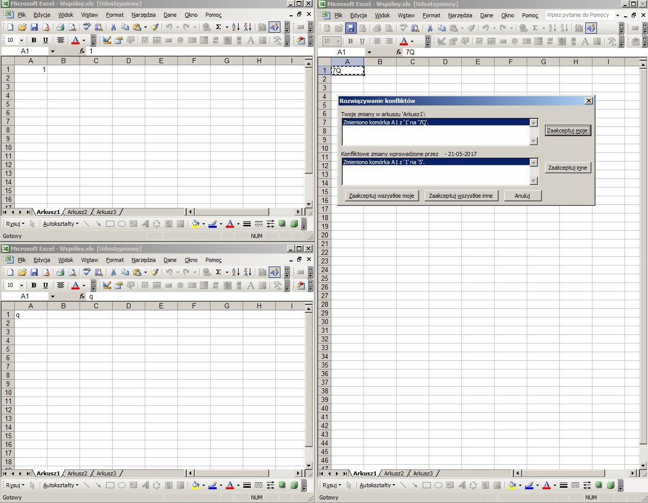

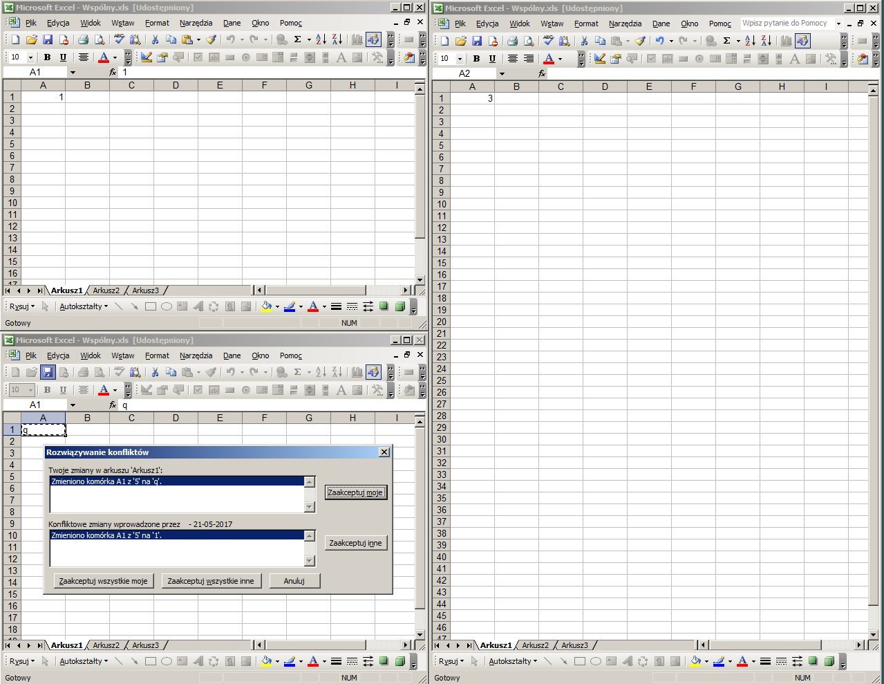

    Ad 1) Changes in the shared workbook are preserved on the basis of 'negotiating' conflict situations:
    Securing Excel 2016 Sheet Against Multiple Users Editing Simultaneously01.jpg (206.89 kB)You must be logged in to download this attachment. Securing Excel 2016 Sheet Against Multiple Users Editing Simultaneously02.jpg (222.47 kB)You must be logged in to download this attachment. Securing Excel 2016 Sheet Against Multiple Users Editing Simultaneously03.jpg (221.61 kB)You must be logged in to download this attachment.
    It doesn't matter if the last or the first ... If the first saves and the last does not, and they both close the notebook without further saving the changes, then the order does not matter.
    I have an old Excel, but there was probably no revolution here ...
