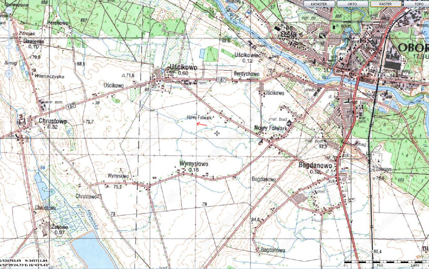

    Can someone tell me where you can probably check the size of the transmission line? I have absolutely no idea whether it is a medium or high voltage network. I saw on the forum suggestions to see this map ...
    Determine Transmission Line Size: Obornik Wlkp - Uścikowo Folwark Area, Geoportal.gov.pl Map
    However, the enlargement does not give me 100% certainty (it is the area of Obornik Wlkp - Uścikowo Folwark to be exact).
    on the geoportal website (geoportal.gov.pl) I found a raster map with this line marked as follows:
    Anyone have any idea how to check it? Perhaps there is a site that provides this type of information?

    It is a medium voltage line. After tracing its route, we come across three MV / LV stations:
    On the other hand, the HV 220kV transmission line runs several hundred meters to the west of the given location. This is the Poznań Plewiska (PLE) - Piła Krzewiny (PKW) line
    More specifically here:
    Most likely on a pole, over insulators ...
    This is the best, but sometimes there are exceptions:
    It is still listed as 110kV on maps, but has been transmitting only 15kV for many years.
