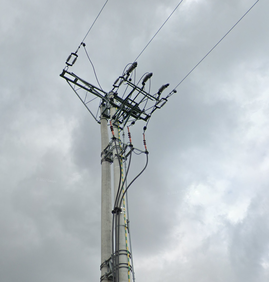

    Hello, a family member wants to buy a plot of land where an overhead power line runs across the boundary. There are three wires. The poles with insulators are far from the plot, One of them can be seen on a google map. I am pasting below. What voltage runs on this line? On the geoportal the line is marked in red and there are two arrows. But I don't think it is a high voltage line. It looks more like medium voltage.
    A pole is where the line comes out of the ground and continues on air.
    What could be the minimum distance of a development from such a line? Looking at the neighbours it is about 6-8m.
    If it's a WN line this certainly disqualifies this plot.
    Interpreting Single and Double Arrows on Electricity Network Maps: Differences Explained .
    The distance of the buildings from the line in some places seems really small so why are the lines marked with two arrows on the map as if it was a WN line?

    Sami500 wrote:
    why on the map is the line marked with two arrows as if it were a HV line?
    The marking on the map is an MV line and not a HV line.

    Hm according to this K1 manual the two arrows are WN and the dash arrow is SN.

    >>21415932 .
    The line in the photo is SN
