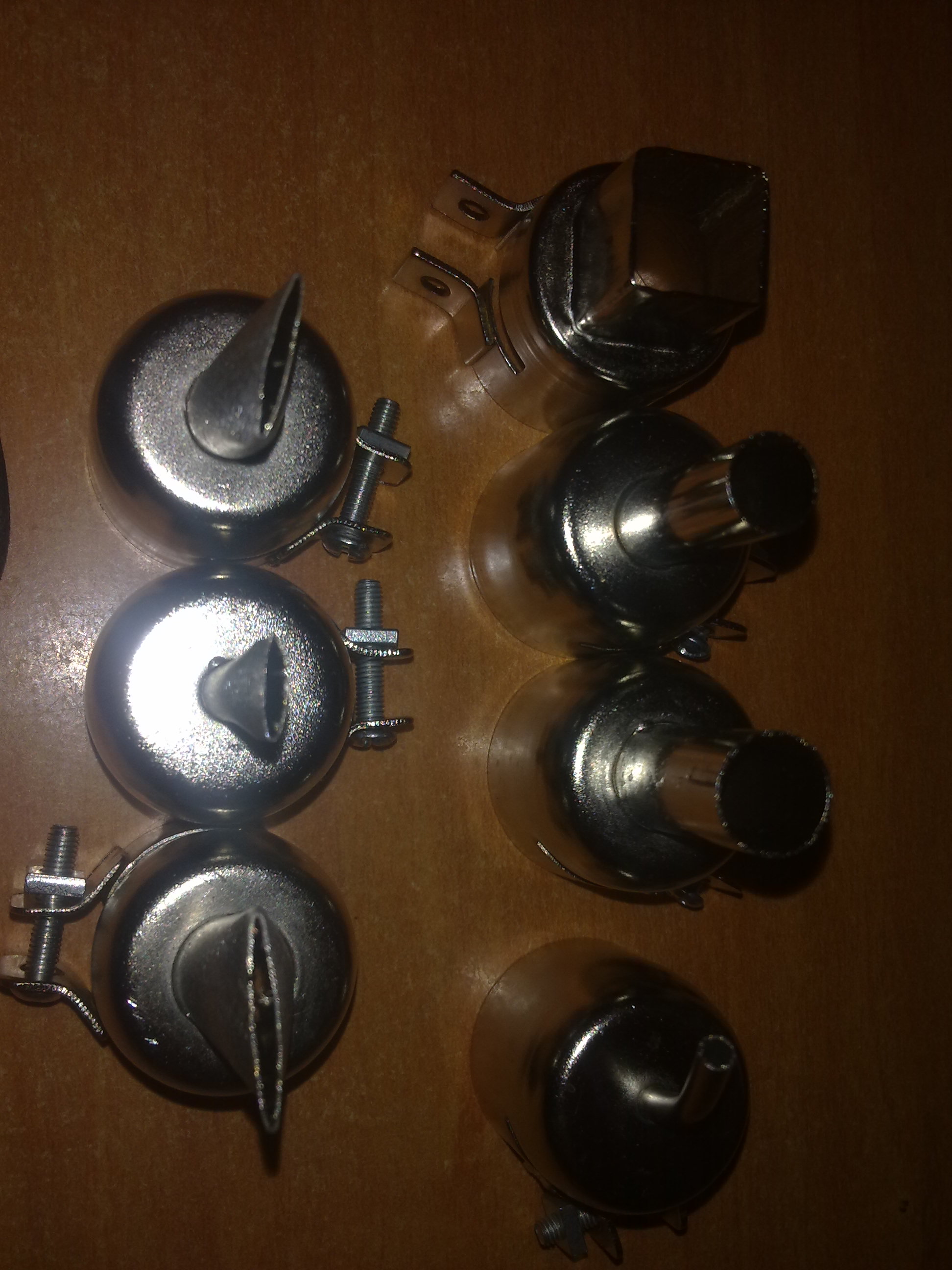

    The second thing is the nozzles. I got 8 of them. 3 round, 3 edged, 1 square and one thin round bent at an angle. Could someone briefly explain which nozzle is best for which systems?

    The nozzles look something like this.
    Understanding Hot Air Soldering: Use of Flux in Gel, Nozzle Types and Their Applications
    There's another round one I've put on for testing purposes now. It looks the same as the two middle ones on the right, only it has a slightly smaller diameter

    As for the endings, it can be said that:
    1. From the top right PLCC desoldering
    2. Bottom right HotAir soldering
    3. HotAir soldering on the left, but the edges of the PLCC circuits.
    It's a bit difficult for me to define the methods of working with this type of soldering iron.
    Mine has over 30 specialized hot air nozzle caps.
    The set also includes a soldering iron with replaceable tips, a suction cup for lifting desoldered SMD components and a suction nozzle with nozzles of various diameters.
